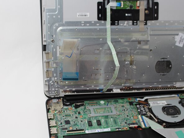

    • Flip the laptop over and open the lid.
    • Insert an opening pick into the seam between the keyboard and chassis.
    • Slide the opening pick a few centimeters along the seam to begin to release the clips.
    • Once there's enough space in the seam, insert an opening tool into the seam.
    • Pry around the entire perimeter of the keyboard until it fully releases.
  3. HP Chromebook 14-SMB Battery Replacement: crwdns2935265:03crwdnd2935265:01crwdnd2935265:02crwdne2935265:0 HP Chromebook 14-SMB Battery Replacement: crwdns2935265:03crwdnd2935265:02crwdnd2935265:02crwdne2935265:0
    • Lift the keyboard perpendicular to the laptop.
    • Flip up each of the the two black ZIF locking flaps that secure the keyboard and trackpad ribbon cables to their motherboard sockets.
    • Disconnect the keyboard and trackpad ribbon cables.
    • Remove the keyboard.
