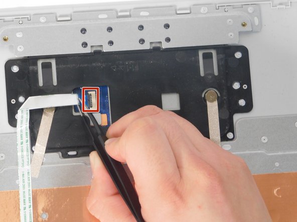

    • Lay the keyboard face down.

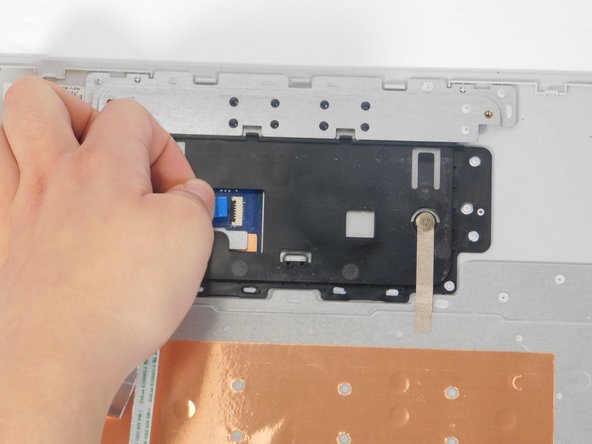

    • Use tweezers to lift the tape on the bottom of the touchpad to expose the connector.
    • Flip up the black ZIF locking flap that secures the touchpad ribbon cable.
    • Disconnect the touchpad ribbon cable.

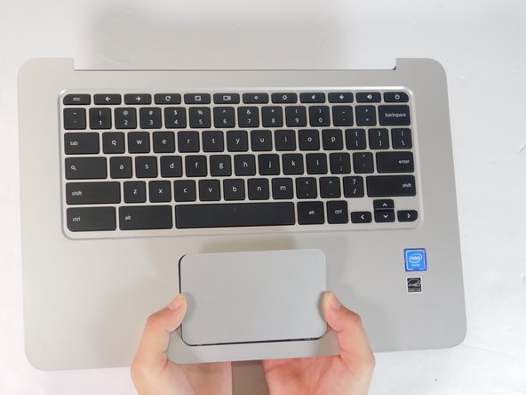

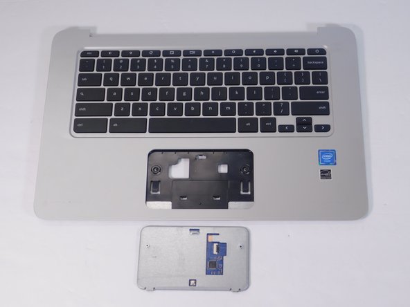

    • Use a Phillips #00 screwdriver to remove the two 2 mm screws that secure the touchpad to the black plastic housing.
    • Flip the keyboard mount to the upright position.
    • From beneath, push the touchpad up through the top of the keyboard mount to remove it.
