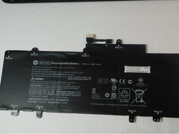

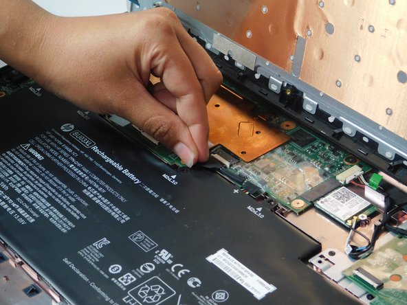

  4. HP Chromebook 14 G4 Battery Replacement, Battery: crwdns2935265:04crwdnd2935265:01crwdnd2935265:02crwdne2935265:0 HP Chromebook 14 G4 Battery Replacement, Battery: crwdns2935265:04crwdnd2935265:02crwdnd2935265:02crwdne2935265:0
    • Use your fingernails to "walk" the battery connector out of its socket.
    • Avoid pulling on the wires.
  5. HP Chromebook 14 G4 Battery Replacement: crwdns2935265:05crwdnd2935265:01crwdnd2935265:01crwdne2935265:0
    • Remove the four 4.1 mm screws securing the battery with a Phillips #00 screwdriver.

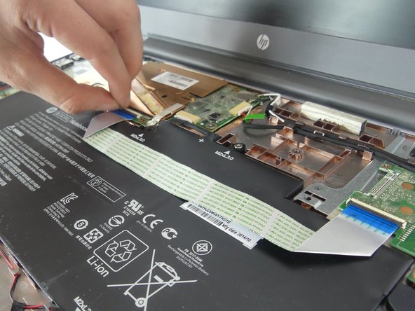

  6. HP Chromebook 14 G4 Battery Replacement: crwdns2935265:06crwdnd2935265:01crwdnd2935265:02crwdne2935265:0 HP Chromebook 14 G4 Battery Replacement: crwdns2935265:06crwdnd2935265:02crwdnd2935265:02crwdne2935265:0
    • Use a nylon spudger or your fingernail to flip up the two black ZIF locking flaps that secure either end of the ribbon cable.
    • Grip each blue pull tab and gently remove the ribbon cables from their sockets.
  7. HP Chromebook 14 G4 Battery Replacement: crwdns2935265:07crwdnd2935265:01crwdnd2935265:02crwdne2935265:0 HP Chromebook 14 G4 Battery Replacement: crwdns2935265:07crwdnd2935265:02crwdnd2935265:02crwdne2935265:0
    • Lift the battery up and out of the chassis.
