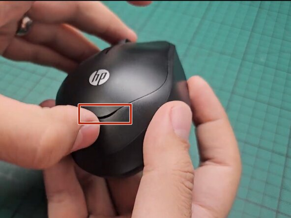

    • Lift the top cover of the mouse off the base.

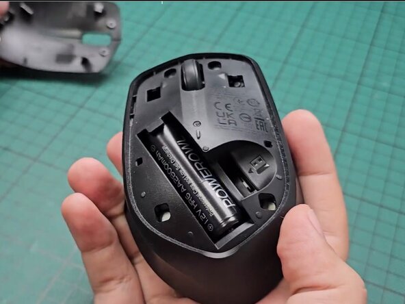

    • Remove the battery.

    • Flip the mouse so the bottom is facing up.
    • Use tweezers to gently remove the rubber pads, revealing the screws underneath.
    • After removing the rubber pads, keep them in a secure place. You will need them later for reassembly.
