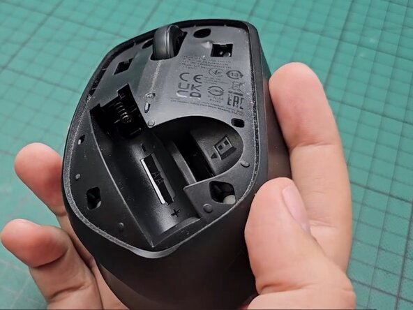

    • Remove the battery.

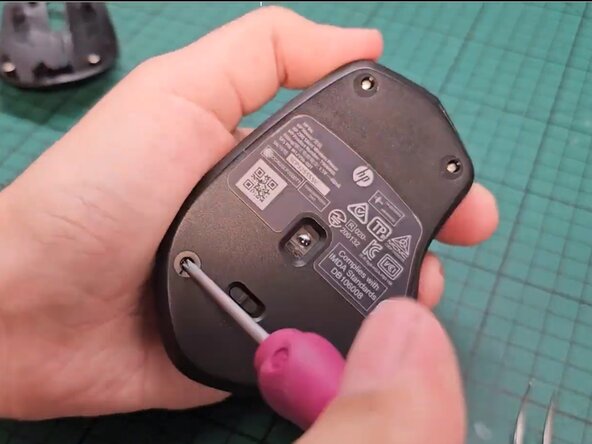

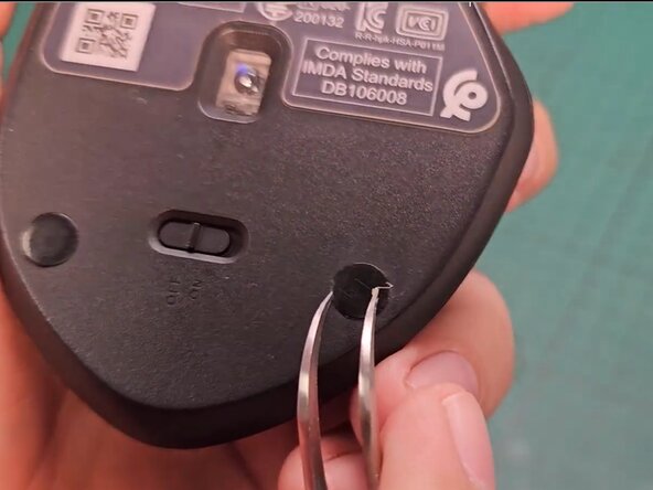

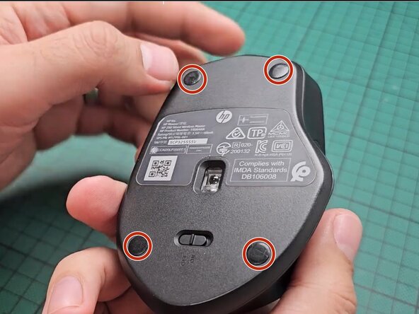

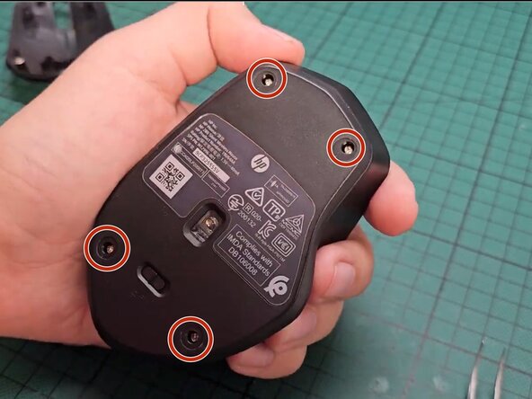

    • Flip the mouse so the bottom is facing up.

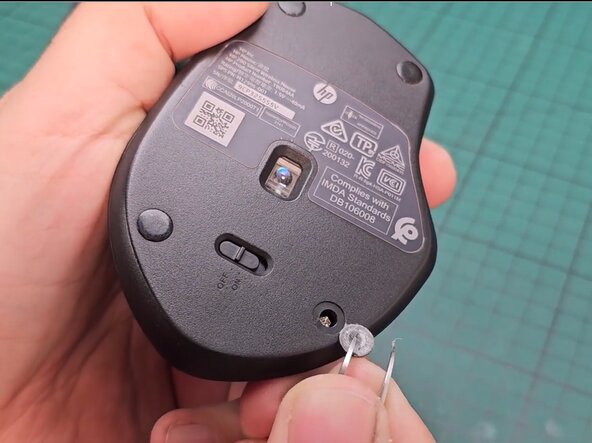

    • Use tweezers to gently remove the rubber pads, revealing the screws underneath.
    • After removing the rubber pads, keep them in a secure place. You will need them later for reassembly.
  4. HP 280 Silent Wireless Mouse Scroll Wheel Replacement: crwdns2935265:04crwdnd2935265:01crwdnd2935265:02crwdne2935265:0 HP 280 Silent Wireless Mouse Scroll Wheel Replacement: crwdns2935265:04crwdnd2935265:02crwdnd2935265:02crwdne2935265:0

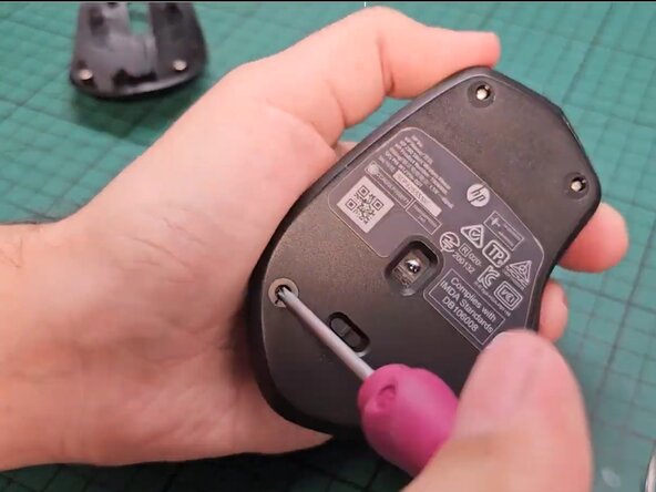

    • Use a Phillips #0 screwdriver to remove four 3 mm screws.

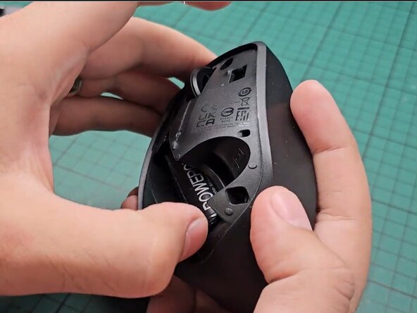

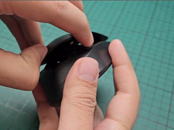

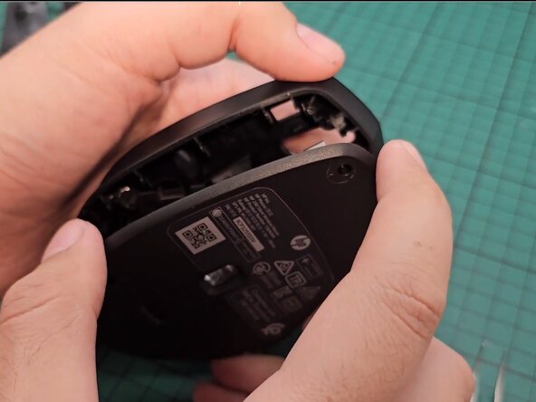

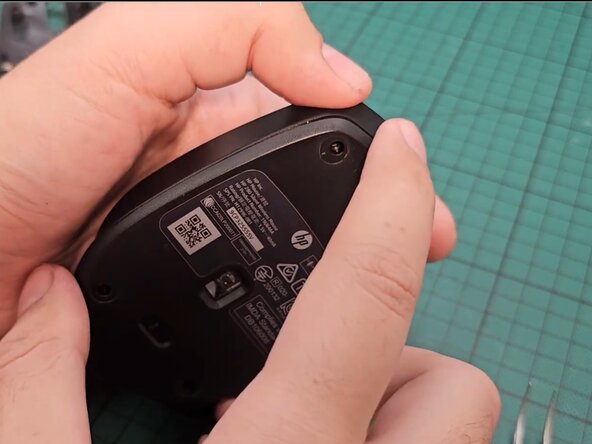

    • Use a spudger to release the clips along the perimeter between the top and bottom casing of the mouse.
    • Separate the top and bottom halves of the mouse.
    • Do not force them apart, as this could damage the device.

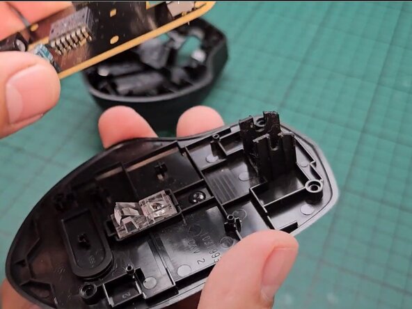

  6. HP 280 Silent Wireless Mouse Scroll Wheel Replacement: crwdns2935265:06crwdnd2935265:01crwdnd2935265:02crwdne2935265:0 HP 280 Silent Wireless Mouse Scroll Wheel Replacement: crwdns2935265:06crwdnd2935265:02crwdnd2935265:02crwdne2935265:0

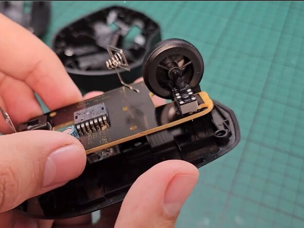

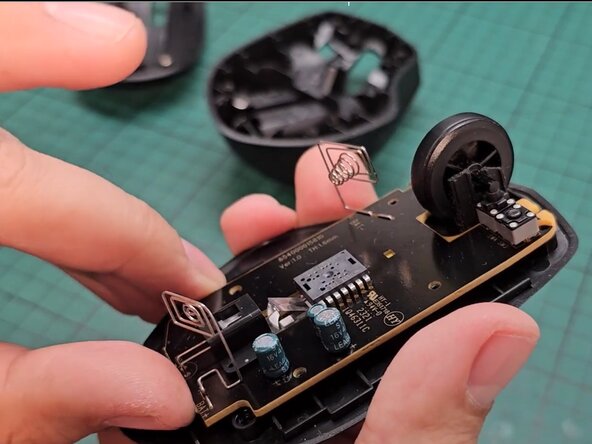

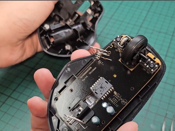

    • Gently detach the circuit board from its housing, ensuring you do not bend or damage any components.
  7. HP 280 Silent Wireless Mouse Scroll Wheel Replacement: crwdns2935265:07crwdnd2935265:01crwdnd2935265:02crwdne2935265:0 HP 280 Silent Wireless Mouse Scroll Wheel Replacement: crwdns2935265:07crwdnd2935265:02crwdnd2935265:02crwdne2935265:0

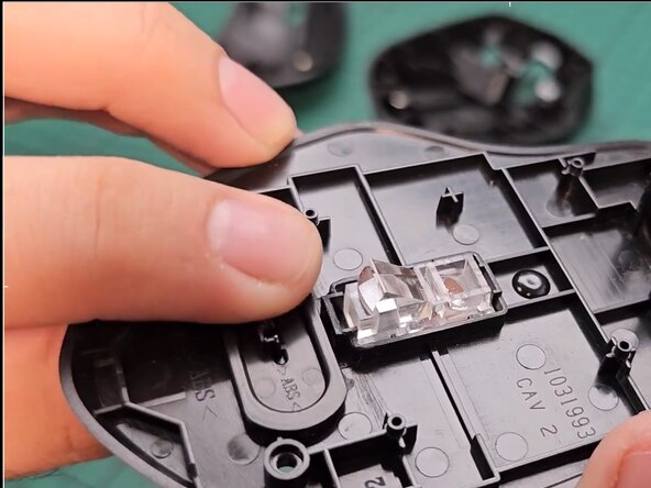

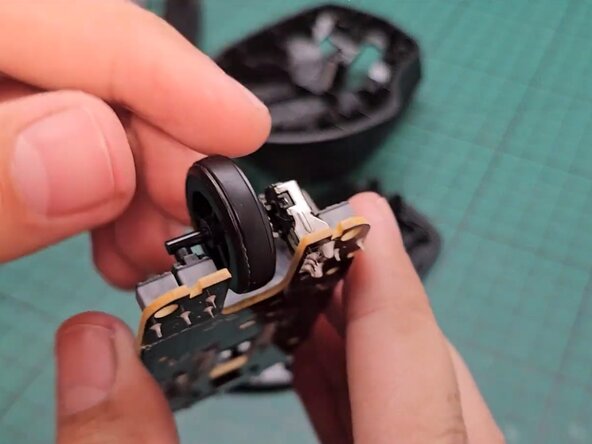

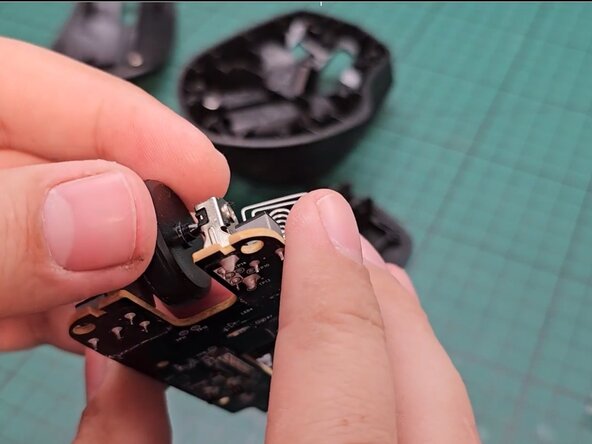

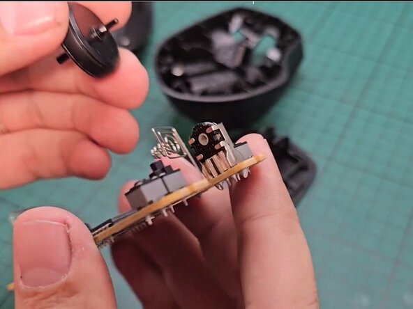

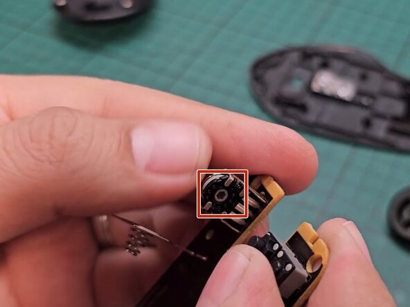

    • Slide the scroll wheel out of the scroll encoder to remove it.
  8. HP 280 Silent Wireless Mouse Scroll Wheel Replacement: crwdns2935265:08crwdnd2935265:01crwdnd2935265:03crwdne2935265:0 HP 280 Silent Wireless Mouse Scroll Wheel Replacement: crwdns2935265:08crwdnd2935265:02crwdnd2935265:03crwdne2935265:0 HP 280 Silent Wireless Mouse Scroll Wheel Replacement: crwdns2935265:08crwdnd2935265:03crwdnd2935265:03crwdne2935265:0
    • Identify the two sides of the scroll wheel: hexagonal side,circular side
    • Align the new scroll wheel so the circular side is against the button assembly and the hexagonal side towards the scroll encoder.
    • Slide the hexagonal side into the slot of the scroll encoder, and press the scroll wheel into place.

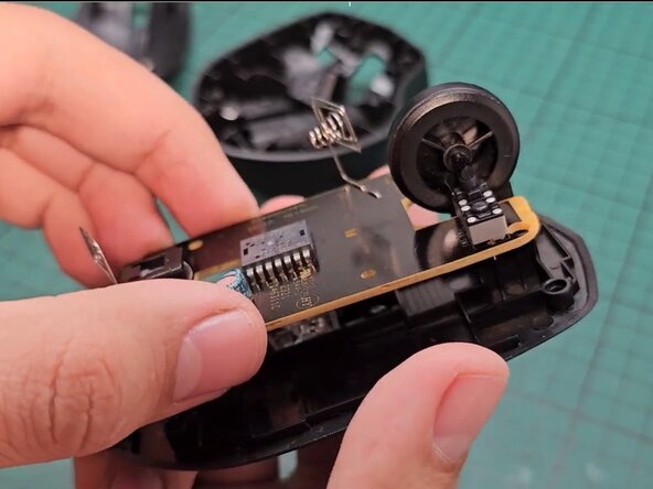

  9. HP 280 Silent Wireless Mouse Scroll Wheel Replacement: crwdns2935265:09crwdnd2935265:01crwdnd2935265:01crwdne2935265:0
    • After placing the scroll wheel, verify that it rotates smoothly and that the scroll encoder is also rotating to detect movement correctly.
    • If the scroll wheel does not function properly, double-check its alignment and placement.

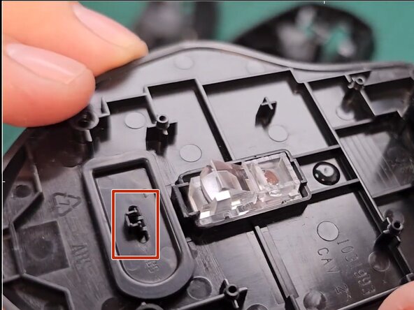

  10. HP 280 Silent Wireless Mouse Scroll Wheel Replacement: crwdns2935265:010crwdnd2935265:01crwdnd2935265:02crwdne2935265:0 HP 280 Silent Wireless Mouse Scroll Wheel Replacement: crwdns2935265:010crwdnd2935265:02crwdnd2935265:02crwdne2935265:0
    • If the on/off button is not already in the off position, push it to the off position before proceeding.
  11. HP 280 Silent Wireless Mouse Scroll Wheel Replacement: crwdns2935265:011crwdnd2935265:01crwdnd2935265:02crwdne2935265:0 HP 280 Silent Wireless Mouse Scroll Wheel Replacement: crwdns2935265:011crwdnd2935265:02crwdnd2935265:02crwdne2935265:0
    • Carefully place the circuit board back into the housing, ensuring it is in the correct position and is not inverted.
  12. HP 280 Silent Wireless Mouse Scroll Wheel Replacement: crwdns2935265:012crwdnd2935265:01crwdnd2935265:02crwdne2935265:0 HP 280 Silent Wireless Mouse Scroll Wheel Replacement: crwdns2935265:012crwdnd2935265:02crwdnd2935265:02crwdne2935265:0
