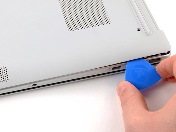

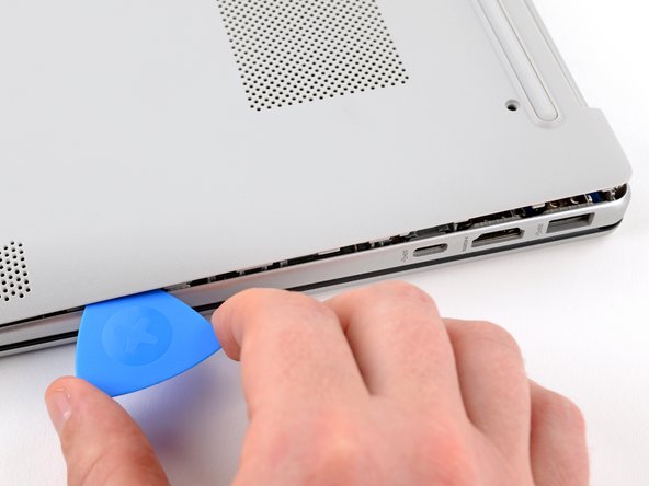

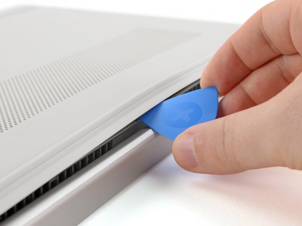

  3. HP 15-fc0000 Series Speakers Replacement, Release the bottom cover clips: crwdns2935265:03crwdnd2935265:01crwdnd2935265:02crwdne2935265:0 HP 15-fc0000 Series Speakers Replacement, Release the bottom cover clips: crwdns2935265:03crwdnd2935265:02crwdnd2935265:02crwdne2935265:0
    • The clips attached to the bottom cover are fragile. Use caution when releasing them.
    • Insert an opening pick under the bottom cover at the rear of the laptop.
    • Twist the pick until one or more clips release.
    • Repeat this procedure along the rear edge until you release all the clips.

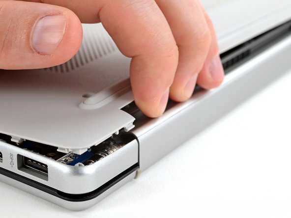

    • The bottom cover is fragile. Use caution when bending it.
    • Place your fingers under the part of the bottom cover you've raised, near a corner.
    • Use your fingers to gently pry up the corner of the bottom cover.

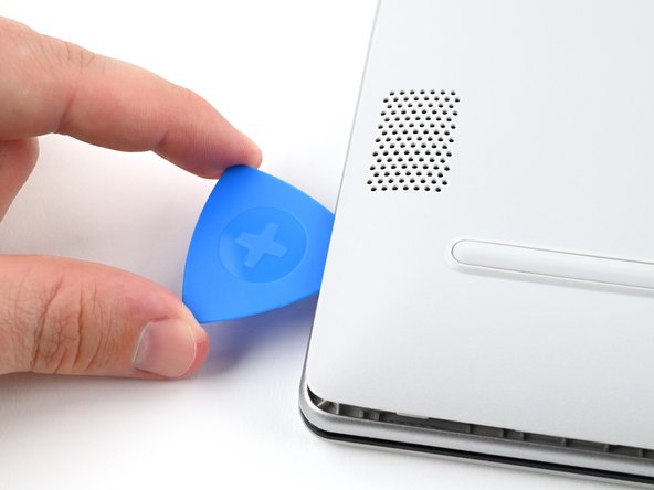

  5. HP 15-fc0000 Series Speakers Replacement: crwdns2935265:05crwdnd2935265:01crwdnd2935265:03crwdne2935265:0 HP 15-fc0000 Series Speakers Replacement: crwdns2935265:05crwdnd2935265:02crwdnd2935265:03crwdne2935265:0 HP 15-fc0000 Series Speakers Replacement: crwdns2935265:05crwdnd2935265:03crwdnd2935265:03crwdne2935265:0
    • Insert an opening pick under the edge of the bottom cover next to the corner you've raised.
    • Pry up the back cover clips along the edge.
  6. HP 15-fc0000 Series Speakers Replacement: crwdns2935265:06crwdnd2935265:01crwdnd2935265:02crwdne2935265:0 HP 15-fc0000 Series Speakers Replacement: crwdns2935265:06crwdnd2935265:02crwdnd2935265:02crwdne2935265:0
    • Use an opening pick to repeat the procedure from the previous step to pry up the remaining sides of the bottom cover.

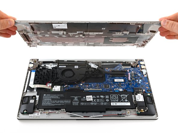

  7. HP 15-fc0000 Series Speakers Replacement, Remove the bottom cover: crwdns2935265:07crwdnd2935265:01crwdnd2935265:02crwdne2935265:0 HP 15-fc0000 Series Speakers Replacement, Remove the bottom cover: crwdns2935265:07crwdnd2935265:02crwdnd2935265:02crwdne2935265:0
    • Remove the bottom cover.
    • Some clips may re-engage when you're releasing other sides. If the bottom cover doesn't lift off easily, use the opening pick to release any remaining clips.
    • During reassembly, lay the bottom cover on the laptop so the sides of the cover align with the sides of the laptop. Then, gently press on the sides until you hear the clips click. If the clips don't engage easily, adjust the cover and try again.

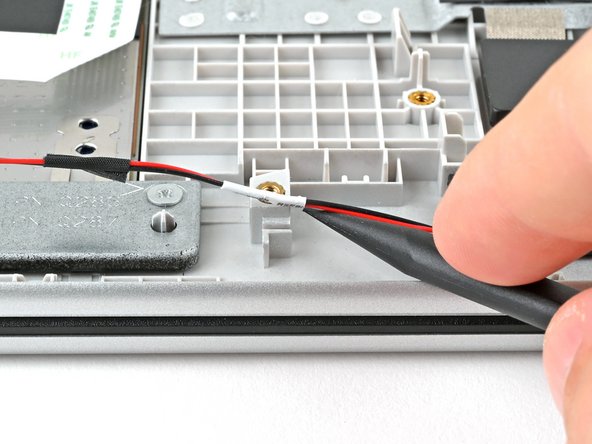

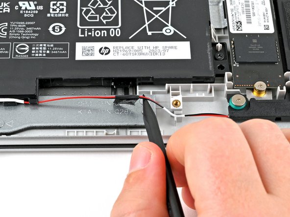

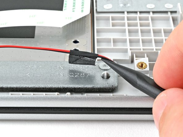

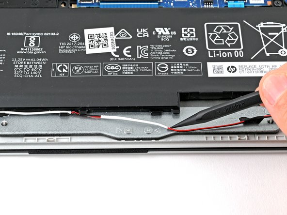

  8. HP 15-fc0000 Series Speakers Replacement, Lift the speaker wire tape: crwdns2935265:08crwdnd2935265:01crwdnd2935265:02crwdne2935265:0 HP 15-fc0000 Series Speakers Replacement, Lift the speaker wire tape: crwdns2935265:08crwdnd2935265:02crwdnd2935265:02crwdne2935265:0
    • Do not put too much stress on the wire, as that can harm your laptop's audio quality.
    • Use a spudger or your fingers to lift the tape that adheres the speaker wires to the metal trackpad bracket.
    • Try not to fold the tape so it can be reused during reassembly.

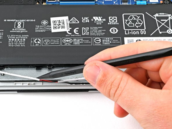

  9. HP 15-fc0000 Series Speakers Replacement, Move the speaker wires: crwdns2935265:09crwdnd2935265:01crwdnd2935265:03crwdne2935265:0 HP 15-fc0000 Series Speakers Replacement, Move the speaker wires: crwdns2935265:09crwdnd2935265:02crwdnd2935265:03crwdne2935265:0 HP 15-fc0000 Series Speakers Replacement, Move the speaker wires: crwdns2935265:09crwdnd2935265:03crwdnd2935265:03crwdne2935265:0
    • Use a spudger or your fingers to remove the speaker wires from the routing clips along the edge of the battery.

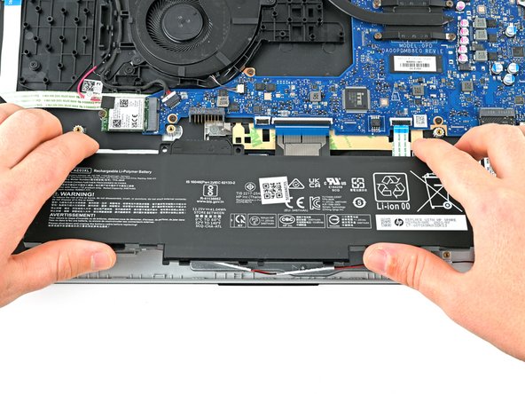

  10. HP 15-fc0000 Series Speakers Replacement, Remove the battery screws: crwdns2935265:010crwdnd2935265:01crwdnd2935265:02crwdne2935265:0 HP 15-fc0000 Series Speakers Replacement, Remove the battery screws: crwdns2935265:010crwdnd2935265:02crwdnd2935265:02crwdne2935265:0
    • Use a Phillips screwdriver to remove the five 4.3 mm‑long screws securing the battery.
    • During reassembly, press firmly on the battery connector to ensure a strong connection.

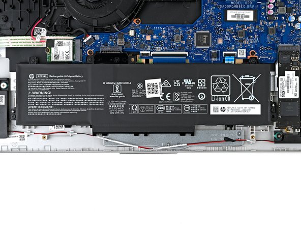

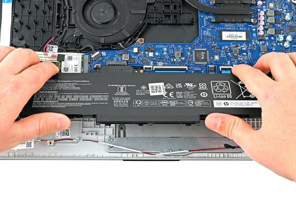

  11. HP 15-fc0000 Series Speakers Replacement, Remove the battery: crwdns2935265:011crwdnd2935265:01crwdnd2935265:03crwdne2935265:0 HP 15-fc0000 Series Speakers Replacement, Remove the battery: crwdns2935265:011crwdnd2935265:02crwdnd2935265:03crwdne2935265:0 HP 15-fc0000 Series Speakers Replacement, Remove the battery: crwdns2935265:011crwdnd2935265:03crwdnd2935265:03crwdne2935265:0
    • Do not grab the battery at the ends because this battery is flexible. Instead, grab the battery one inch from each end to better support the middle.
    • Use two hands to grip the battery about one inch from each end.
    • Lift the front of the battery (the side closest to you) until the battery is free of its alignment pegs.
    • Pull the battery towards you to release it from its connector.
    • Don't continue to use a damaged battery, as doing so is a potential safety hazard. If in doubt, replace it with a new battery.
    • During reassembly, insert the battery onto its connector at a slight downward angle before pressing it flat to the frame.

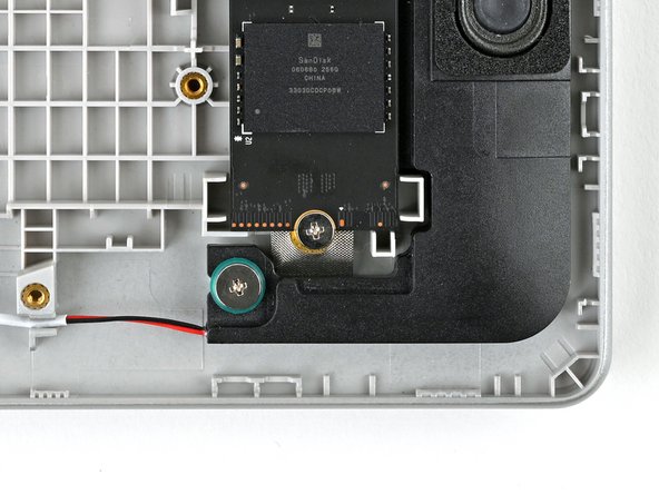

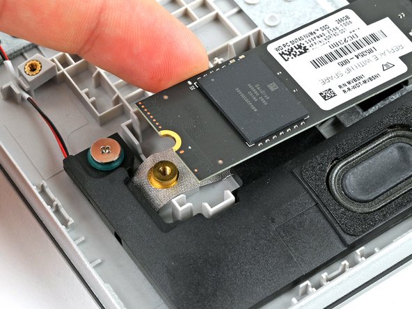

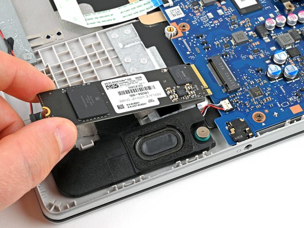

  12. HP 15-fc0000 Series Speakers Replacement, Remove the SSD screw: crwdns2935265:012crwdnd2935265:01crwdnd2935265:02crwdne2935265:0 HP 15-fc0000 Series Speakers Replacement, Remove the SSD screw: crwdns2935265:012crwdnd2935265:02crwdnd2935265:02crwdne2935265:0
    • Use a Phillips screwdriver to remove the 3.8 mm‑long screw securing the SSD.
  13. HP 15-fc0000 Series Speakers Replacement, Remove the SSD: crwdns2935265:013crwdnd2935265:01crwdnd2935265:02crwdne2935265:0 HP 15-fc0000 Series Speakers Replacement, Remove the SSD: crwdns2935265:013crwdnd2935265:02crwdnd2935265:02crwdne2935265:0
    • Lift the edge of the SSD near the screw indent to a shallow angle.
  14. HP 15-fc0000 Series Speakers Replacement: crwdns2935265:014crwdnd2935265:01crwdnd2935265:02crwdne2935265:0 HP 15-fc0000 Series Speakers Replacement: crwdns2935265:014crwdnd2935265:02crwdnd2935265:02crwdne2935265:0
    • Grip the SSD by its edges and pull it away from its socket to remove it.
    • During reassembly, insert the SSD into its socket at a shallow angle before lowering it flat to the laptop.

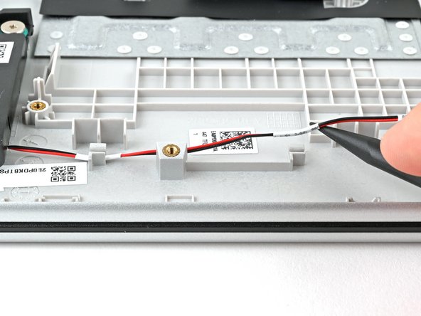

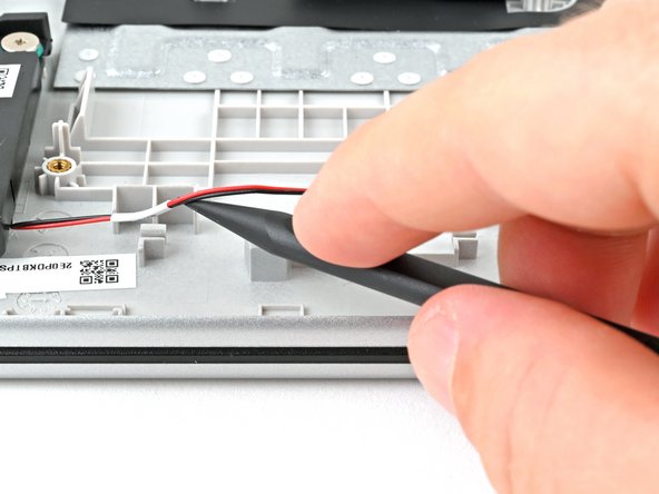

  16. HP 15-fc0000 Series Speakers Replacement, Lift the speaker wire: crwdns2935265:016crwdnd2935265:01crwdnd2935265:02crwdne2935265:0 HP 15-fc0000 Series Speakers Replacement, Lift the speaker wire: crwdns2935265:016crwdnd2935265:02crwdnd2935265:02crwdne2935265:0
    • Use a spudger to lift the speaker wire out of the routing clip near the left speaker.
    • The left speaker is on your right, since the laptop is upside down.
  17. HP 15-fc0000 Series Speakers Replacement: crwdns2935265:017crwdnd2935265:01crwdnd2935265:03crwdne2935265:0 HP 15-fc0000 Series Speakers Replacement: crwdns2935265:017crwdnd2935265:02crwdnd2935265:03crwdne2935265:0 HP 15-fc0000 Series Speakers Replacement: crwdns2935265:017crwdnd2935265:03crwdnd2935265:03crwdne2935265:0
    • Repeat the procedure from the previous step to lift the speaker wire out of the two routing clips near the right speaker.

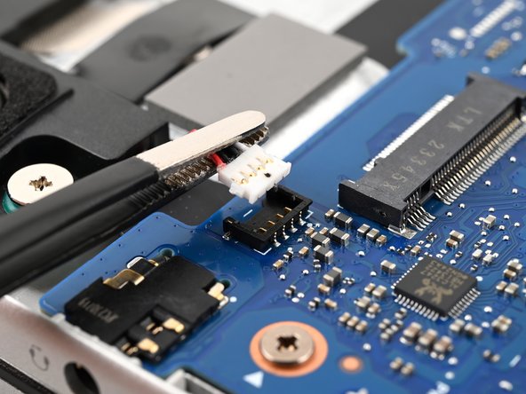

  18. HP 15-fc0000 Series Speakers Replacement, Disconnect the speakers: crwdns2935265:018crwdnd2935265:01crwdnd2935265:02crwdne2935265:0 HP 15-fc0000 Series Speakers Replacement, Disconnect the speakers: crwdns2935265:018crwdnd2935265:02crwdnd2935265:02crwdne2935265:0
    • Insert one arm of blunt nose tweezers under the speaker cable, as close to the connector as possible.
    • Grip the wires evenly and lift the cable up to disconnect the fan.
    • To reconnect the speakers to the motherboard, use a pair of tweezers to grip all of the wires and align the connector with the socket. Then, use the flat end of a spudger or your finger to evenly press the connector into the socket.

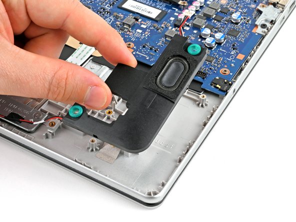

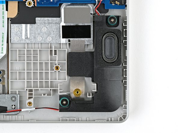

  19. HP 15-fc0000 Series Speakers Replacement, Remove the left speaker screws: crwdns2935265:019crwdnd2935265:01crwdnd2935265:02crwdne2935265:0 HP 15-fc0000 Series Speakers Replacement, Remove the left speaker screws: crwdns2935265:019crwdnd2935265:02crwdnd2935265:02crwdne2935265:0
    • Use a Phillips screwdriver to remove the two 3.2 mm‑long screws securing the left speaker.
    • The left speaker is now sitting to your right, since the laptop is upside down.

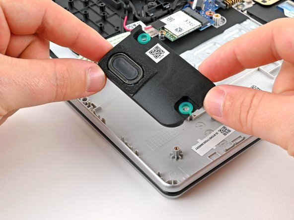

  20. HP 15-fc0000 Series Speakers Replacement, Remove the left speaker: crwdns2935265:020crwdnd2935265:01crwdnd2935265:02crwdne2935265:0 HP 15-fc0000 Series Speakers Replacement, Remove the left speaker: crwdns2935265:020crwdnd2935265:02crwdnd2935265:02crwdne2935265:0
    • Use your fingers to lift the left speaker off its screw posts and remove it.

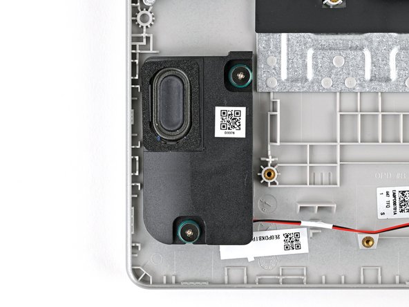

  21. HP 15-fc0000 Series Speakers Replacement, Remove the right speaker screws: crwdns2935265:021crwdnd2935265:01crwdnd2935265:02crwdne2935265:0 HP 15-fc0000 Series Speakers Replacement, Remove the right speaker screws: crwdns2935265:021crwdnd2935265:02crwdnd2935265:02crwdne2935265:0
    • Use a Phillips screwdriver to remove the two 3.2 mm‑long screws securing the right speaker.
  22. HP 15-fc0000 Series Speakers Replacement, Remove the right speaker: crwdns2935265:022crwdnd2935265:01crwdnd2935265:02crwdne2935265:0 HP 15-fc0000 Series Speakers Replacement, Remove the right speaker: crwdns2935265:022crwdnd2935265:02crwdnd2935265:02crwdne2935265:0
    • Use your fingers to lift the right speaker off its screw posts and remove it.
