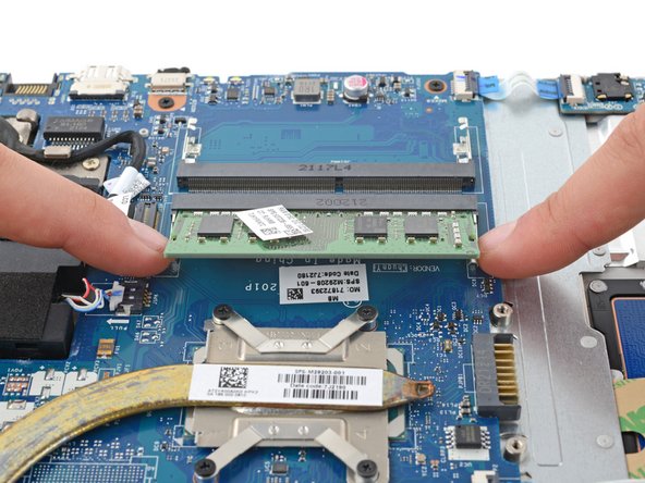

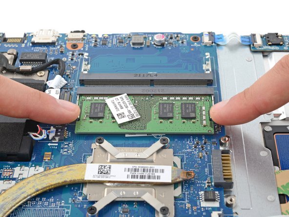

  16. HP 15-dw RAM Replacement, Unlatch the RAM: crwdns2935265:016crwdnd2935265:01crwdnd2935265:03crwdne2935265:0 HP 15-dw RAM Replacement, Unlatch the RAM: crwdns2935265:016crwdnd2935265:02crwdnd2935265:03crwdne2935265:0 HP 15-dw RAM Replacement, Unlatch the RAM: crwdns2935265:016crwdnd2935265:03crwdnd2935265:03crwdne2935265:0
    • Your laptop has two memory slots, each with a pair of metal arms that secure a stick of RAM.
    • Simultaneously push out the metal arms on each side of a stick of RAM until they disengage and the stick pops up at a slight angle.

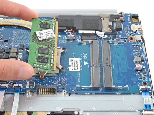

  17. HP 15-dw RAM Replacement, Remove the RAM: crwdns2935265:017crwdnd2935265:01crwdnd2935265:02crwdne2935265:0 HP 15-dw RAM Replacement, Remove the RAM: crwdns2935265:017crwdnd2935265:02crwdnd2935265:02crwdne2935265:0
    • Pull the stick of RAM out of its socket to remove it.
    • Repeat for a second stick of RAM.
    • To install a memory module, insert it into its socket at a slight downward angle, then push down firmly until both metal arms lock the RAM in place.
