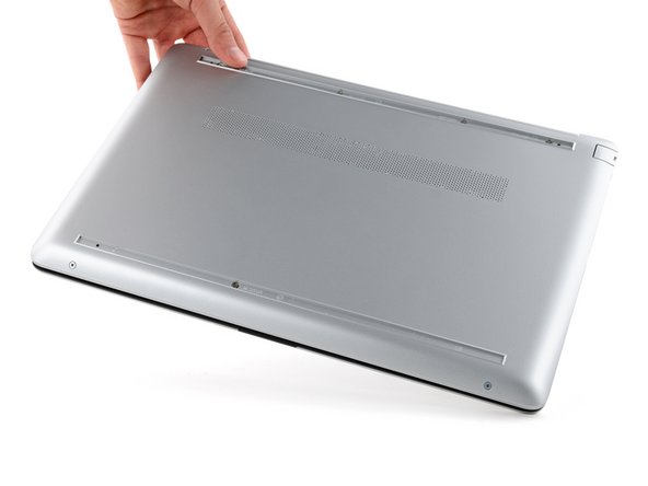

    • Fully shut down your laptop and unplug all cables.
  2. HP 15-dw Fan Replacement, Flip your laptop over: crwdns2935265:02crwdnd2935265:01crwdnd2935265:01crwdne2935265:0
    • Flip your laptop over so the rubber feet are facing up.
  3. HP 15-dw Fan Replacement, Peel up an end of the front foot: crwdns2935265:03crwdnd2935265:01crwdnd2935265:03crwdne2935265:0 HP 15-dw Fan Replacement, Peel up an end of the front foot: crwdns2935265:03crwdnd2935265:02crwdnd2935265:03crwdne2935265:0 HP 15-dw Fan Replacement, Peel up an end of the front foot: crwdns2935265:03crwdnd2935265:03crwdnd2935265:03crwdne2935265:0
    • The rubber feet cover a total of five back cover screws.
    • Use an opening pick to peel up an end of the front rubber foot until you can grip it with your fingers.
    • Make sure both the foot and its adhesive peel up together, as they need to be removed as one piece.
  4. HP 15-dw Fan Replacement, Remove the front foot: crwdns2935265:04crwdnd2935265:01crwdnd2935265:03crwdne2935265:0 HP 15-dw Fan Replacement, Remove the front foot: crwdns2935265:04crwdnd2935265:02crwdnd2935265:03crwdne2935265:0 HP 15-dw Fan Replacement, Remove the front foot: crwdns2935265:04crwdnd2935265:03crwdnd2935265:03crwdne2935265:0
    • Peel the front foot away from the back cover and remove it.
  5. HP 15-dw Fan Replacement, Remove the rear foot: crwdns2935265:05crwdnd2935265:01crwdnd2935265:03crwdne2935265:0 HP 15-dw Fan Replacement, Remove the rear foot: crwdns2935265:05crwdnd2935265:02crwdnd2935265:03crwdne2935265:0 HP 15-dw Fan Replacement, Remove the rear foot: crwdns2935265:05crwdnd2935265:03crwdnd2935265:03crwdne2935265:0
    • Use an opening pick to peel up an end of the rear rubber foot until you can grip it with your fingers.
    • Peel the rear foot away from the back cover and remove it.

  7. HP 15-dw Fan Replacement, Unfasten the back cover: crwdns2935265:07crwdnd2935265:01crwdnd2935265:02crwdne2935265:0 HP 15-dw Fan Replacement, Unfasten the back cover: crwdns2935265:07crwdnd2935265:02crwdnd2935265:02crwdne2935265:0
    • Use a Phillips screwdriver to remove the seven screws securing the back cover:
    • Five 8.5 mm-long screws
    • Two 4.6 mm-long screws
    • Despite the standards, Phillips screwdrivers can vary in size and shape—two drivers labeled as the same size may fit differently in the same screw. Use the size that fits the most snug into the screw head to avoid stripping it.

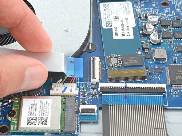

  16. HP 15-dw Fan Replacement, Disconnect the interconnect cable: crwdns2935265:016crwdnd2935265:01crwdnd2935265:03crwdne2935265:0 HP 15-dw Fan Replacement, Disconnect the interconnect cable: crwdns2935265:016crwdnd2935265:02crwdnd2935265:03crwdne2935265:0 HP 15-dw Fan Replacement, Disconnect the interconnect cable: crwdns2935265:016crwdnd2935265:03crwdnd2935265:03crwdne2935265:0

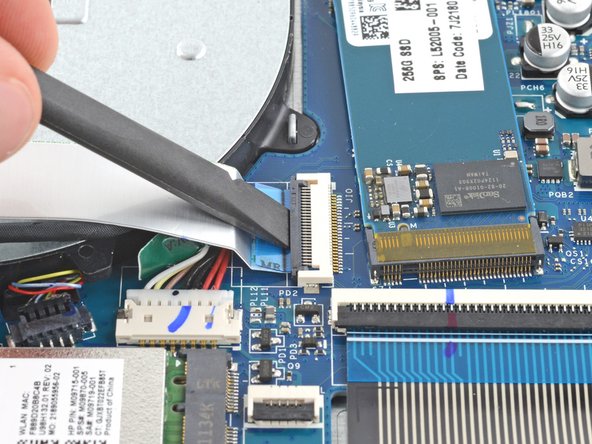

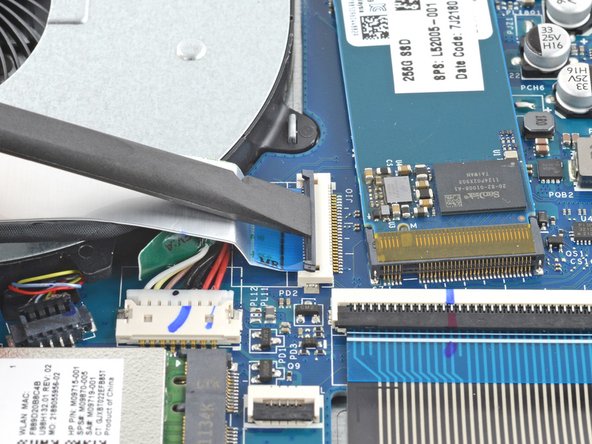

    • Use the flat end of a spudger or your fingernail to flip up the hinged locking flap on the interconnect cable ZIF connector.
  17. HP 15-dw Fan Replacement: crwdns2935265:017crwdnd2935265:01crwdnd2935265:02crwdne2935265:0 HP 15-dw Fan Replacement: crwdns2935265:017crwdnd2935265:02crwdnd2935265:02crwdne2935265:0
    • Pull the interconnect cable straight out of its socket.
    • When reinserting the cable, make sure the blue tab is on top.

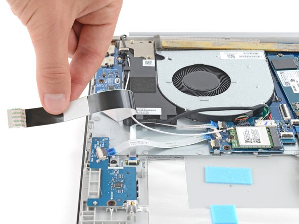

  18. HP 15-dw Fan Replacement, Move the interconnect cable: crwdns2935265:018crwdnd2935265:01crwdnd2935265:02crwdne2935265:0 HP 15-dw Fan Replacement, Move the interconnect cable: crwdns2935265:018crwdnd2935265:02crwdnd2935265:02crwdne2935265:0
    • Move the interconnect cable out of the way of the fan.
    • Light adhesive may secure the cable to the fan.

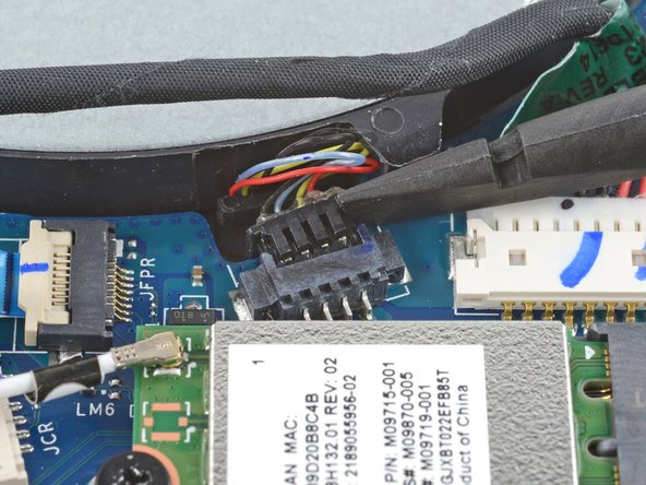

  19. HP 15-dw Fan Replacement, Disconnect the fan cable: crwdns2935265:019crwdnd2935265:01crwdnd2935265:03crwdne2935265:0 HP 15-dw Fan Replacement, Disconnect the fan cable: crwdns2935265:019crwdnd2935265:02crwdnd2935265:03crwdne2935265:0 HP 15-dw Fan Replacement, Disconnect the fan cable: crwdns2935265:019crwdnd2935265:03crwdnd2935265:03crwdne2935265:0

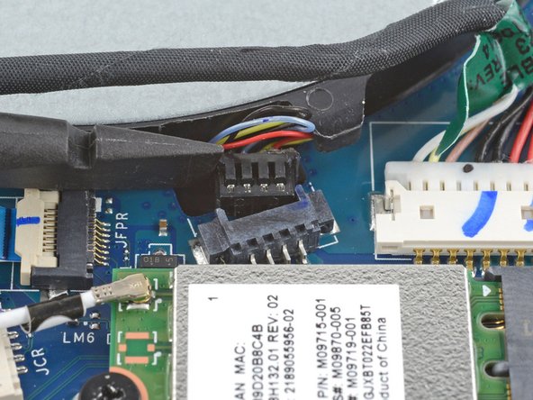

    • Use the flat end of a spudger to push on each side of the fan cable connector, alternating sides to "walk" it out of its socket.

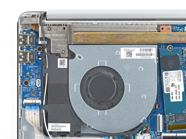

  20. HP 15-dw Fan Replacement, Unfasten the fan: crwdns2935265:020crwdnd2935265:01crwdnd2935265:02crwdne2935265:0 HP 15-dw Fan Replacement, Unfasten the fan: crwdns2935265:020crwdnd2935265:02crwdnd2935265:02crwdne2935265:0
    • Use a Phillips screwdriver to remove the single 3.4 mm-long screw securing the fan.

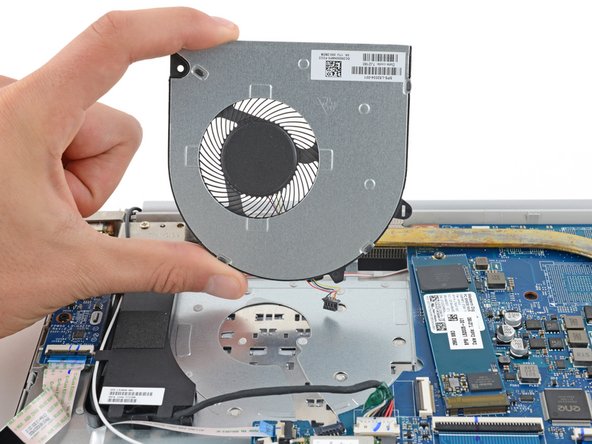

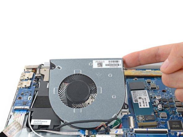

  21. HP 15-dw Fan Replacement, Remove the fan: crwdns2935265:021crwdnd2935265:01crwdnd2935265:03crwdne2935265:0 HP 15-dw Fan Replacement, Remove the fan: crwdns2935265:021crwdnd2935265:02crwdnd2935265:03crwdne2935265:0 HP 15-dw Fan Replacement, Remove the fan: crwdns2935265:021crwdnd2935265:03crwdnd2935265:03crwdne2935265:0
    • Lift the top right corner of the fan to remove it.
    • During reassembly, make sure the fan is correctly seated on its alignment post.
