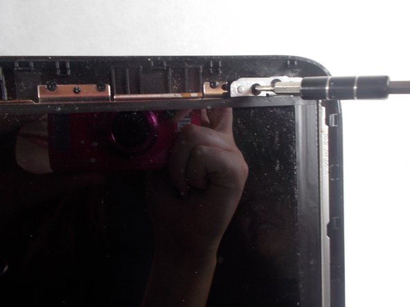

  3. HP 15-ac142dx Screen Replacement, Remove the screen: crwdns2935265:03crwdnd2935265:01crwdnd2935265:02crwdne2935265:0 HP 15-ac142dx Screen Replacement, Remove the screen: crwdns2935265:03crwdnd2935265:02crwdnd2935265:02crwdne2935265:0
    • Remove the Phillips PM2.0×5.2 screws at the top of the screen with the #0 bit. This will allow the screen to pop off easily.
    • Once all the screws are removed, gently remove the screen from the lid.
    • Disconnect the ZIF connector on the back of the screen.
