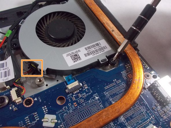

  3. HP 15-ac142dx Fan Replacement, Remove the fan: crwdns2935265:03crwdnd2935265:01crwdnd2935265:01crwdne2935265:0
    • Use your Phillips screwdriver to remove the 10 screws in the bottom cover.
  4. HP 15-ac142dx Fan Replacement: crwdns2935265:04crwdnd2935265:01crwdnd2935265:02crwdne2935265:0 HP 15-ac142dx Fan Replacement: crwdns2935265:04crwdnd2935265:02crwdnd2935265:02crwdne2935265:0
    • Flip the computer back over and use an opening tool to pry the keyboard up from the bottom of the computer.
    • Once the keyboard is removed, locate the fan.
  5. HP 15-ac142dx Fan Replacement: crwdns2935265:05crwdnd2935265:01crwdnd2935265:02crwdne2935265:0 HP 15-ac142dx Fan Replacement: crwdns2935265:05crwdnd2935265:02crwdnd2935265:02crwdne2935265:0
    • Use your Phillips screwdriver to remove the two screws on either side of the fan.
    • Unplug the wire that is connected to the fan.
    • Remove the fan.
