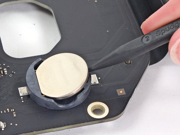

    • Flip your laptop back over and use an opening tool to pry the keyboard up from the bottom case.
    • Locate the motherboard battery.
  5. HP 15-ac142dx CMOS Battery Replacement, Remove the battery: crwdns2935265:05crwdnd2935265:01crwdnd2935265:02crwdne2935265:0 HP 15-ac142dx CMOS Battery Replacement, Remove the battery: crwdns2935265:05crwdnd2935265:02crwdnd2935265:02crwdne2935265:0
    • These photos are of a different device, but the procedure is identical.
    • Use the tip of a spudger to pry the motherboard battery out of its socket.
    • To install a new battery, insert it into its slot and press down firmly.
