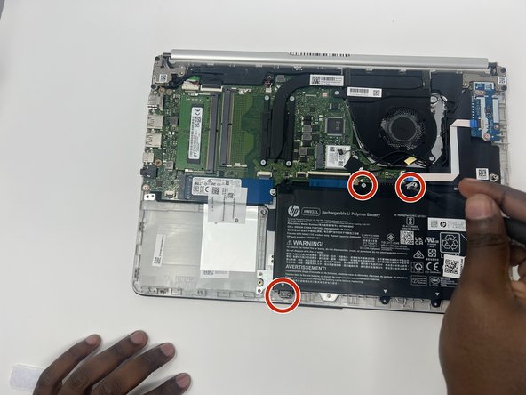

  6. HP 14-fq1025nr Trackpad Replacement, Battery: crwdns2935265:06crwdnd2935265:01crwdnd2935265:02crwdne2935265:0 HP 14-fq1025nr Trackpad Replacement, Battery: crwdns2935265:06crwdnd2935265:02crwdnd2935265:02crwdne2935265:0
    • Remove the four gray 3 mm screws holding down the battery using a Phillips #0 screwdriver.
  7. HP 14-fq1025nr Trackpad Replacement: crwdns2935265:07crwdnd2935265:01crwdnd2935265:01crwdne2935265:0
    • Remove the battery.
