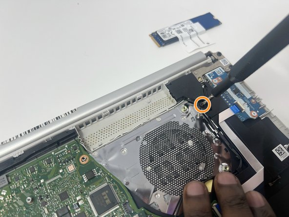

  10. HP 14-fq1025nr Speakers Replacement, Speakers: crwdns2935265:010crwdnd2935265:01crwdnd2935265:02crwdne2935265:0 HP 14-fq1025nr Speakers Replacement, Speakers: crwdns2935265:010crwdnd2935265:02crwdnd2935265:02crwdne2935265:0
    • Using a Phillips #0 screwdriver, remove the three black 5 mm screws holding down the speaker:
    • Two screws on the left side
    • One screw on the right side
  11. HP 14-fq1025nr Speakers Replacement: crwdns2935265:011crwdnd2935265:01crwdnd2935265:01crwdne2935265:0
    • Unplug the speaker wire.
    • Use tweezers if needed.
  12. HP 14-fq1025nr Speakers Replacement: crwdns2935265:012crwdnd2935265:01crwdnd2935265:01crwdne2935265:0
    • Remove the speaker.
