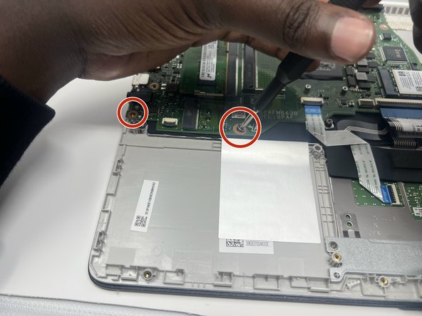

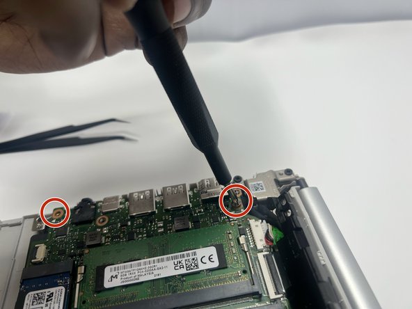

    • Remove the five 3 mm gray screws from around the motherboard using a Phillips #00 screwdriver.

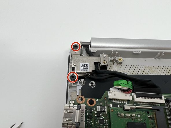

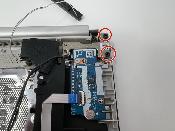

    • Remove the four black 5 mm screws holding down the two silver screen hinges using a Phillips #00 screwdriver.
  21. HP 14-fq1025nr Keyboard Replacement: crwdns2935265:021crwdnd2935265:01crwdnd2935265:02crwdne2935265:0 HP 14-fq1025nr Keyboard Replacement: crwdns2935265:021crwdnd2935265:02crwdnd2935265:02crwdne2935265:0

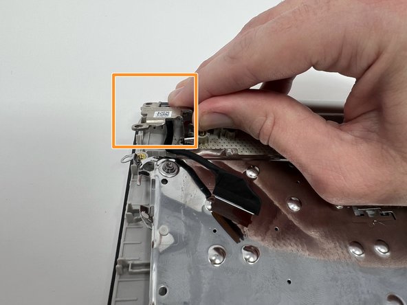

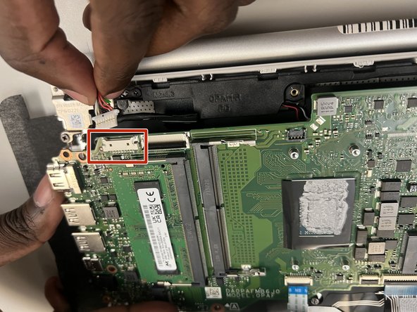

    • Unplug the screen from the motherboard by lifting the wire cover and removing the screen cord.
    • Separate the hinges from the computer.
  22. HP 14-fq1025nr Keyboard Replacement: crwdns2935265:022crwdnd2935265:01crwdnd2935265:01crwdne2935265:0
    • Remove the screen.
