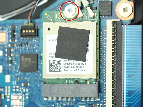

    1. HP 14-dq5043cl Wi-Fi Module Replacement, Wi-Fi Module: crwdns2935265:04crwdnd2935265:01crwdnd2935265:02crwdne2935265:0 HP 14-dq5043cl Wi-Fi Module Replacement, Wi-Fi Module: crwdns2935265:04crwdnd2935265:02crwdnd2935265:02crwdne2935265:0
      • Remove the single M2x6.5 screw that secures the Wi-Fi module.
    2. HP 14-dq5043cl Wi-Fi Module Replacement: crwdns2935265:05crwdnd2935265:01crwdnd2935265:01crwdne2935265:0
      • Use the pointed end of a spudger to lift and disconnect the two Wi-Fi module coaxial connectors.
    3. HP 14-dq5043cl Wi-Fi Module Replacement: crwdns2935265:06crwdnd2935265:01crwdnd2935265:02crwdne2935265:0 HP 14-dq5043cl Wi-Fi Module Replacement: crwdns2935265:06crwdnd2935265:02crwdnd2935265:02crwdne2935265:0

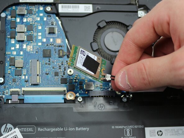

      • Pull the Wi-Fi module directly out of its socket to remove it.
