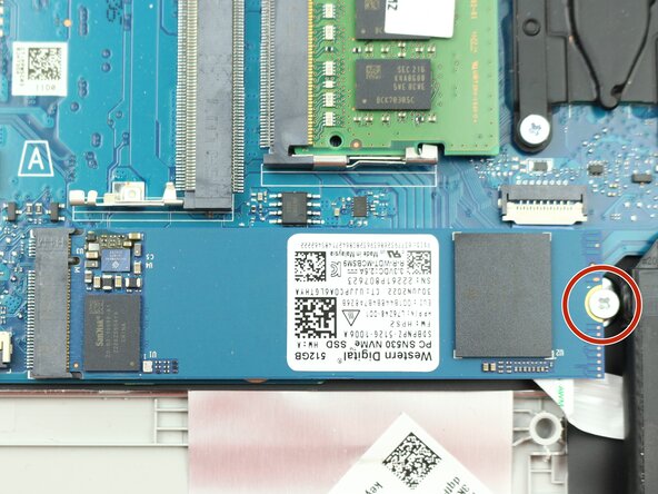

    • Remove the single screw that secures the SSD with a Phillips #1 screwdriver.

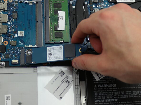

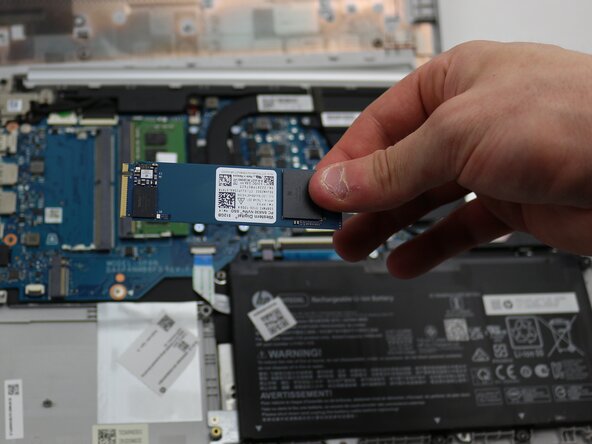

    • Pull the SSD directly out of its socket to remove it.
