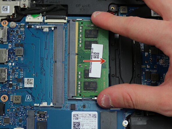

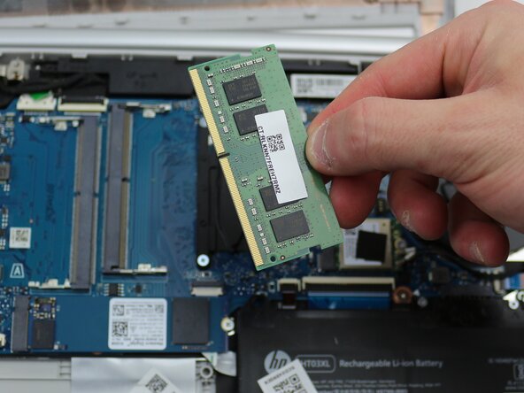

  4. HP 14-dq5043cl RAM Replacement, RAM: crwdns2935265:04crwdnd2935265:01crwdnd2935265:03crwdne2935265:0 HP 14-dq5043cl RAM Replacement, RAM: crwdns2935265:04crwdnd2935265:02crwdnd2935265:03crwdne2935265:0 HP 14-dq5043cl RAM Replacement, RAM: crwdns2935265:04crwdnd2935265:03crwdnd2935265:03crwdne2935265:0
    • Two clips secure each RAM module in place, one on each side. Using your fingers, spread the clips away from the RAM module.
    • When released, the RAM modules will pop up at a slight angle.
    • Slide the RAM module straight out to remove it.
