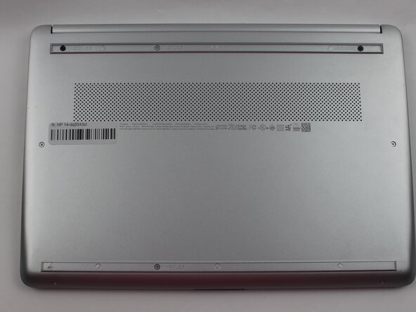

    • Remove the two rubber feet on the lower case.
    • If you intend to reuse the rubber feet: Use a hairdryer or iOpener to lightly heat the feet to loosen the adhesive that secures them prior to removal. Take care not to stretch out the rubber.
  2. HP 14-dq5043cl Fan Replacement: crwdns2935265:02crwdnd2935265:01crwdnd2935265:01crwdne2935265:0
    • Remove the six M2XL6 Phillips screws that secure the lower case.

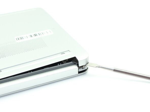

    • Insert a nylon spudger into the seam between the lower case and chassis.

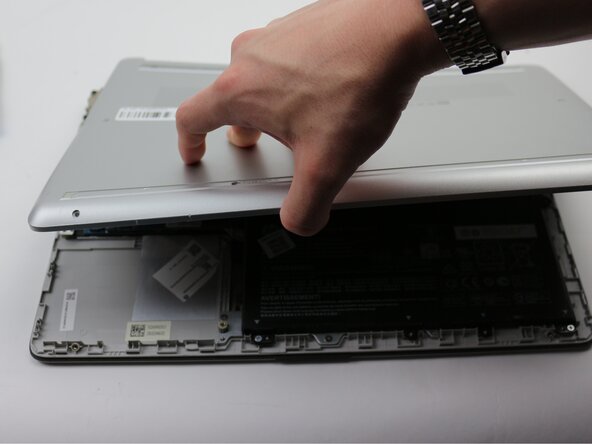

    • Pry around the entire perimeter until the lower case fully releases.
    • Remove the lower case.

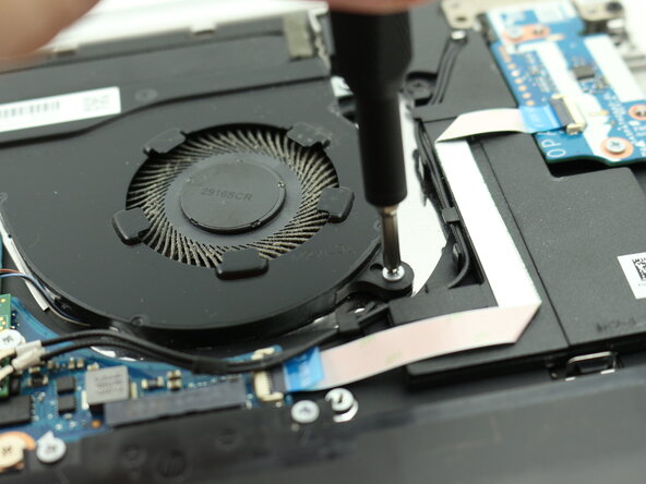

    • Remove the three M2xL3 Phillips screws that secure the fan.

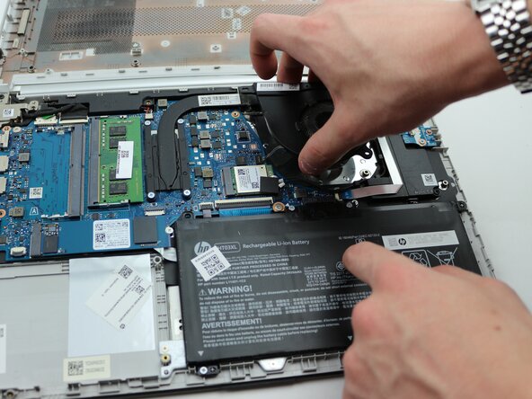

    • Gently disconnect the fan connector from its motherboard socket.
    • Lift the fan up and out.
