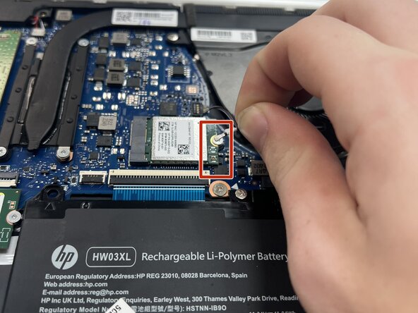

  6. HP 14-dq5009nr Wi-Fi Card Replacement, Wi-Fi Card: crwdns2935265:06crwdnd2935265:01crwdnd2935265:03crwdne2935265:0 HP 14-dq5009nr Wi-Fi Card Replacement, Wi-Fi Card: crwdns2935265:06crwdnd2935265:02crwdnd2935265:03crwdne2935265:0 HP 14-dq5009nr Wi-Fi Card Replacement, Wi-Fi Card: crwdns2935265:06crwdnd2935265:03crwdnd2935265:03crwdne2935265:0
    • Slide a thin, ESD-safe pry tool or angled tweezers under the metal neck of the Wi-Fi connector (as close to the head as possible) and lift straight up from the board.
    • When working with coaxial cable connectors, it's key to always lift the head straight up. If pried on at an odd angle, you risk breaking the socket off of the board underneath.
    • Use tweezers to hold the connector in place over its socket and gently press down with your finger or a spudger—the connector should "snap" into place. If you're having trouble, reposition the head and try again.
    • Don't try to force the connector into place or you may permanently damage it.

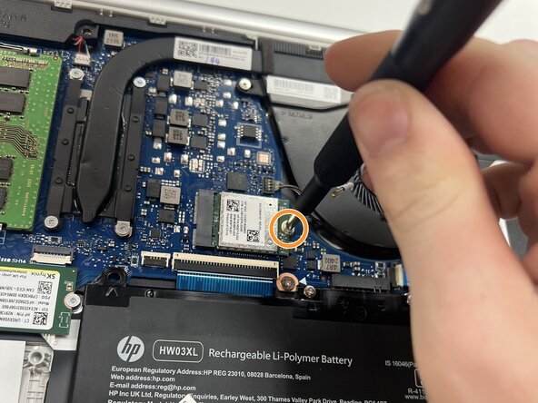

    • Use the Phillips #0 screwdriver to remove the single 3 mm screw from securing the Wi-Fi card to the motherboard.

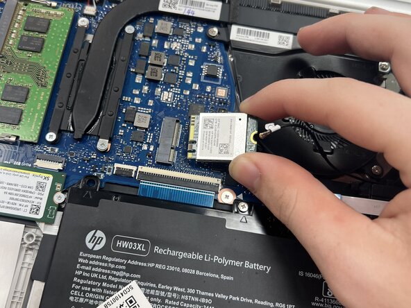

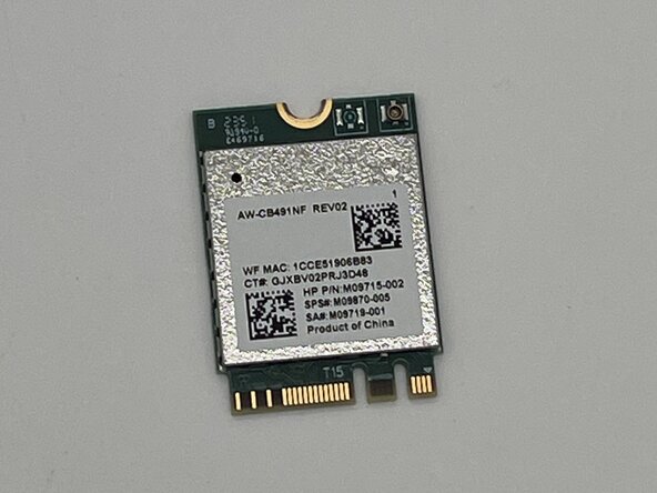

    • With the screw removed, the Wi-Fi card will pop up at a shallow angle.
    • Grip the end of the Wi-Fi card and pull it away from the connector to remove it.
