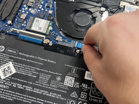

    • Angle the battery up slightly and gently pull it from the socket on the motherboard.
  6. HP 14-dq5009nr Speakers Replacement, Speakers: crwdns2935265:06crwdnd2935265:01crwdnd2935265:03crwdne2935265:0 HP 14-dq5009nr Speakers Replacement, Speakers: crwdns2935265:06crwdnd2935265:02crwdnd2935265:03crwdne2935265:0 HP 14-dq5009nr Speakers Replacement, Speakers: crwdns2935265:06crwdnd2935265:03crwdnd2935265:03crwdne2935265:0

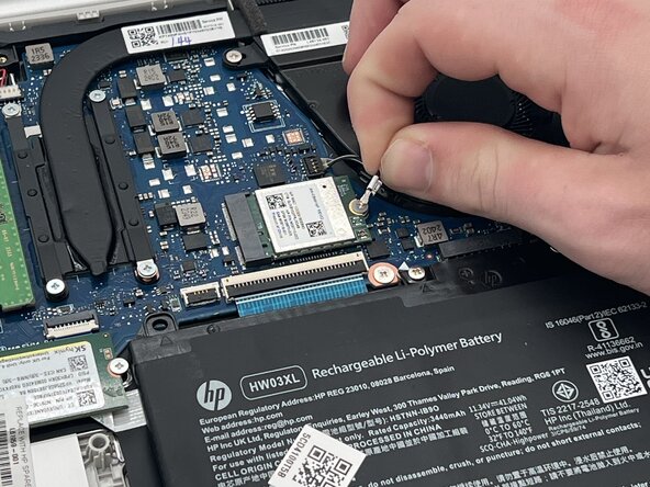

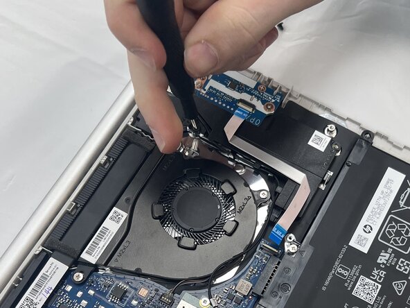

    • Slide a thin, ESD-safe pry tool or angled tweezers under the metal neck of the Wi-Fi connectors (as close to the head as possible) and lift straight up from the board.
    • When working with coaxial cable connectors, it's key to always lift the head straight up. If pried on at an odd angle, you risk breaking the socket off of the board underneath.
    • Use tweezers to hold the connector in place over its socket and gently press down with your finger or a spudger—the connector should "snap" into place. If you're having trouble, reposition the head and try again.
    • Use a spudger or a clean fingernail to flip up white the locking flap—this is the unlocked position.
    • Use tweezers or your fingers to gently pull the cable out of its socket.

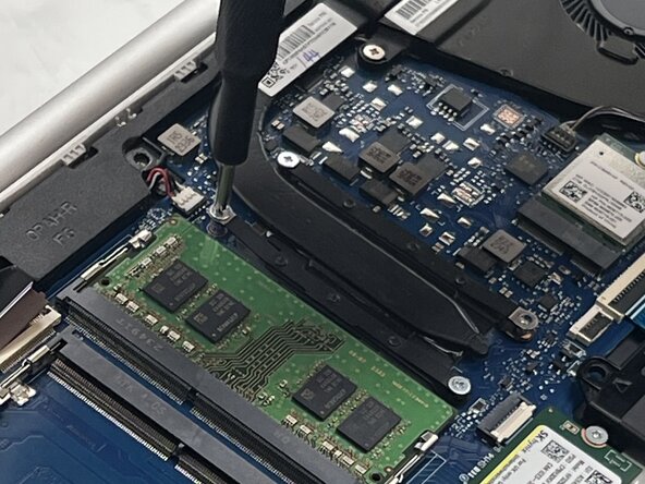

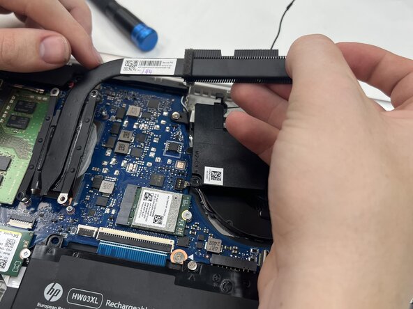

    • Use a Phillips #0 screwdriver to remove the four 2.9 mm heat sink screws in a x-pattern.
    • Carefully lift the heat sink off the motherboard.
    • If it doesn't come off easily, use a spudger to gently pry near the screws holes. The thermal paste may cause it to stick to the motherboard.

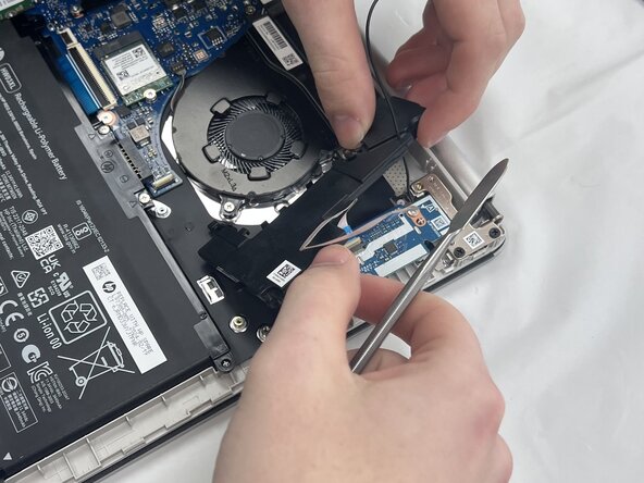

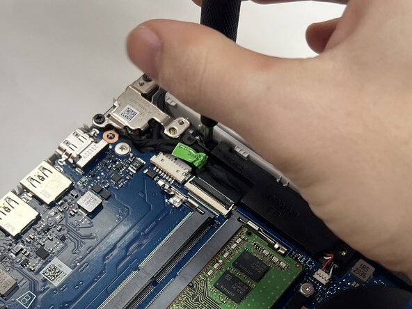

    • Use a Phillips #0 screwdriver to remove the three 3.9 mm speaker screws.
  9. HP 14-dq5009nr Speakers Replacement: crwdns2935265:09crwdnd2935265:01crwdnd2935265:03crwdne2935265:0 HP 14-dq5009nr Speakers Replacement: crwdns2935265:09crwdnd2935265:02crwdnd2935265:03crwdne2935265:0 HP 14-dq5009nr Speakers Replacement: crwdns2935265:09crwdnd2935265:03crwdnd2935265:03crwdne2935265:0

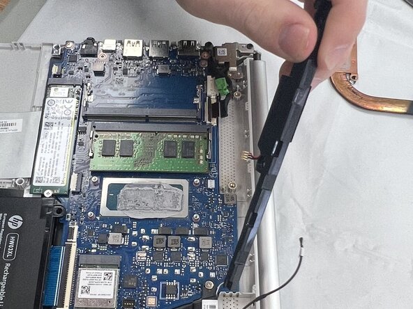

    • Disconnect the speaker cables from the motherboard.
    • Carefully remove the speakers and the wires that connect the two from your laptop.
  10. HP 14-dq5009nr Speakers Replacement: crwdns2935265:010crwdnd2935265:01crwdnd2935265:01crwdne2935265:0
    • The removed speakers.
