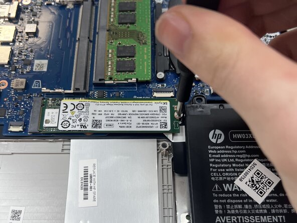

  6. HP 14-dq5009nr SSD Card Replacement, SSD Card: crwdns2935265:06crwdnd2935265:01crwdnd2935265:02crwdne2935265:0 HP 14-dq5009nr SSD Card Replacement, SSD Card: crwdns2935265:06crwdnd2935265:02crwdnd2935265:02crwdne2935265:0
    • Use a Phillips #0 screwdriver to remove the single 3 mm screw that secures the SSD to the motherboard.
    • If there is tape holding the card down remove the tape before unscrewing it.

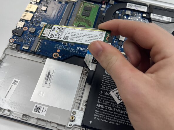

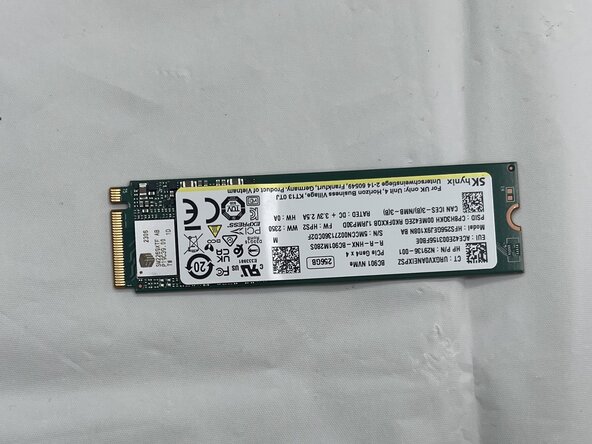

  7. HP 14-dq5009nr SSD Card Replacement: crwdns2935265:07crwdnd2935265:01crwdnd2935265:03crwdne2935265:0 HP 14-dq5009nr SSD Card Replacement: crwdns2935265:07crwdnd2935265:02crwdnd2935265:03crwdne2935265:0 HP 14-dq5009nr SSD Card Replacement: crwdns2935265:07crwdnd2935265:03crwdnd2935265:03crwdne2935265:0
    • The SSD card may pop up at a shallow angle when the screw is removed.
    • Grip the end of the SSD and pull it away from the connector to remove it.
    • During reassembly, insert the SSD at a shallow angle into its board connector.
