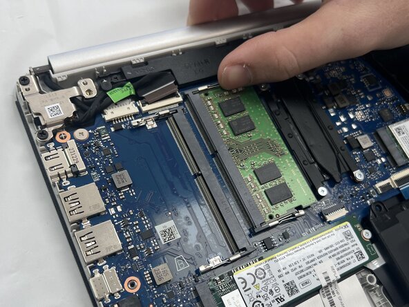

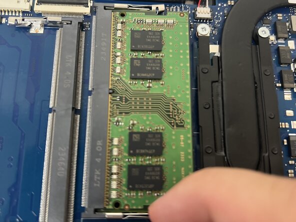

  6. HP 14-dq5009nr RAM Replacement, RAM: crwdns2935265:06crwdnd2935265:01crwdnd2935265:03crwdne2935265:0 HP 14-dq5009nr RAM Replacement, RAM: crwdns2935265:06crwdnd2935265:02crwdnd2935265:03crwdne2935265:0 HP 14-dq5009nr RAM Replacement, RAM: crwdns2935265:06crwdnd2935265:03crwdnd2935265:03crwdne2935265:0
    • RAM Stick
    • Pull the two side clamps away from the Ram.
    • Handle the RAM stick by the edges and avoid touching the gold contacts to prevent static discharge or damage to the module.

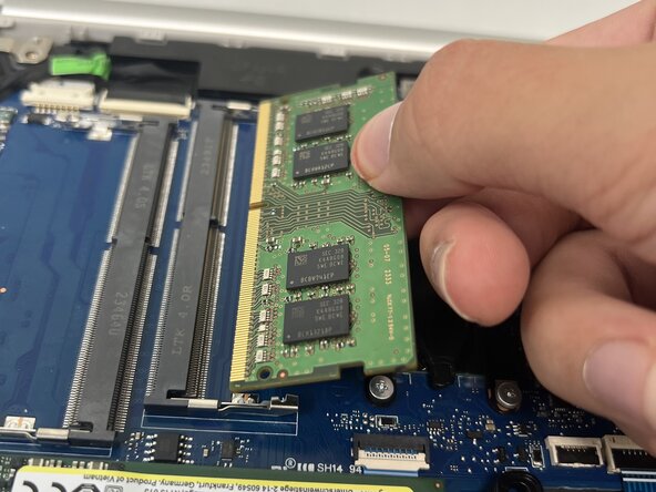

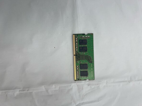

  7. HP 14-dq5009nr RAM Replacement: crwdns2935265:07crwdnd2935265:01crwdnd2935265:03crwdne2935265:0 HP 14-dq5009nr RAM Replacement: crwdns2935265:07crwdnd2935265:02crwdnd2935265:03crwdne2935265:0 HP 14-dq5009nr RAM Replacement: crwdns2935265:07crwdnd2935265:03crwdnd2935265:03crwdne2935265:0
    • Once the Ram pops up, gently pull the Ram out of the socket.
    • The ram stick.
