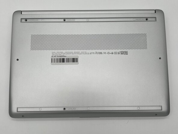

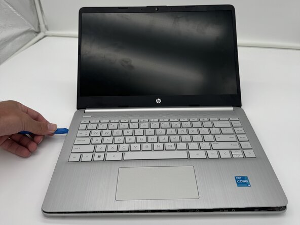

    • Peel the rubber feet off the bottom casing to reveal hidden screws.
    • Keep the rubber feet for reassembly.
    • Make sure the device is completely powered off before replacement.

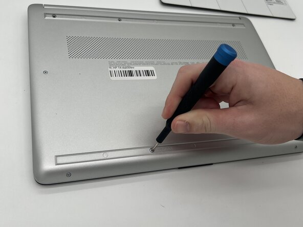

  2. HP 14-dq5009nr Battery Replacement: crwdns2935265:02crwdnd2935265:01crwdnd2935265:02crwdne2935265:0 HP 14-dq5009nr Battery Replacement: crwdns2935265:02crwdnd2935265:02crwdnd2935265:02crwdne2935265:0
    • Use a Philips #0 screwdriver to remove the eight screws from the back case.
    • Six 7 mm-long screws.
    • Two 4.8 mm-long screws

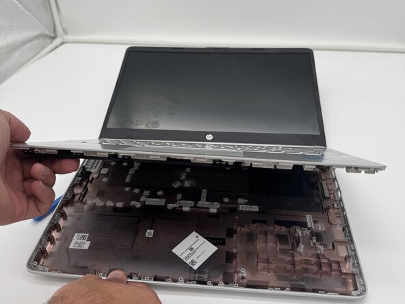

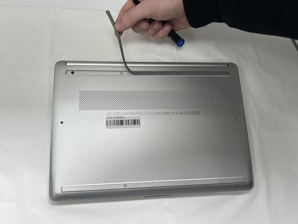

  3. HP 14-dq5009nr Battery Replacement: crwdns2935265:03crwdnd2935265:01crwdnd2935265:03crwdne2935265:0 HP 14-dq5009nr Battery Replacement: crwdns2935265:03crwdnd2935265:02crwdnd2935265:03crwdne2935265:0 HP 14-dq5009nr Battery Replacement: crwdns2935265:03crwdnd2935265:03crwdnd2935265:03crwdne2935265:0
    • Use a plastic opening tool to separate the back case from the palmrest keyboard assembly. Gently pry the back cover from the device.
    • Start from a corner of the device and run the opening tool along the edge of the cover to release the clips before you separate them.
    • Be careful to not bend or crack the back cover.

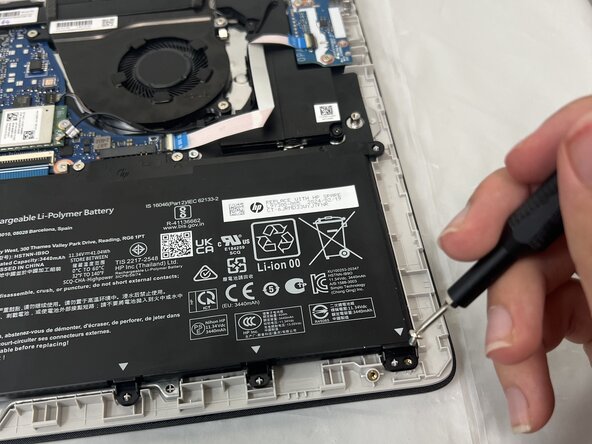

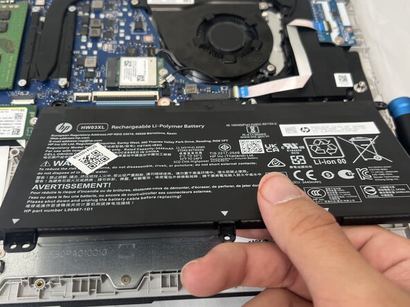

  4. HP 14-dq5009nr Battery Replacement: crwdns2935265:04crwdnd2935265:01crwdnd2935265:02crwdne2935265:0 HP 14-dq5009nr Battery Replacement: crwdns2935265:04crwdnd2935265:02crwdnd2935265:02crwdne2935265:0
    • Use a Phillips #0 screwdriver to remove the four 3 mm screws that secure the battery to the chassis.

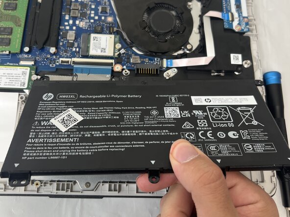

  5. HP 14-dq5009nr Battery Replacement: crwdns2935265:05crwdnd2935265:01crwdnd2935265:03crwdne2935265:0 HP 14-dq5009nr Battery Replacement: crwdns2935265:05crwdnd2935265:02crwdnd2935265:03crwdne2935265:0 HP 14-dq5009nr Battery Replacement: crwdns2935265:05crwdnd2935265:03crwdnd2935265:03crwdne2935265:0
    • Angle the battery up slightly and gently pull it from the socket on the motherboard.
To reassemble your device, follow these instructions in reverse order. Take your e-waste to an R2 or e-Stewards certified recycler.
For optimal performance, calibrate your newly installed battery after completing this guide.
