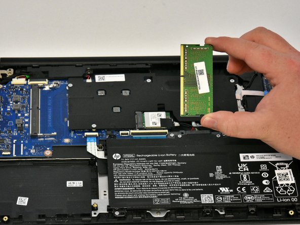

  5. HP 14-dq0051dx RAM Replacement, RAM: crwdns2935265:05crwdnd2935265:01crwdnd2935265:02crwdne2935265:0 HP 14-dq0051dx RAM Replacement, RAM: crwdns2935265:05crwdnd2935265:02crwdnd2935265:02crwdne2935265:0
    • Using your fingers, pull the metal arms (located on both sides of the RAM stick) slightly away from it.
    • The RAM stick will pop up by a few millimeters.
    • Remove it at an angle and not straight up so you don't damage the socket.
