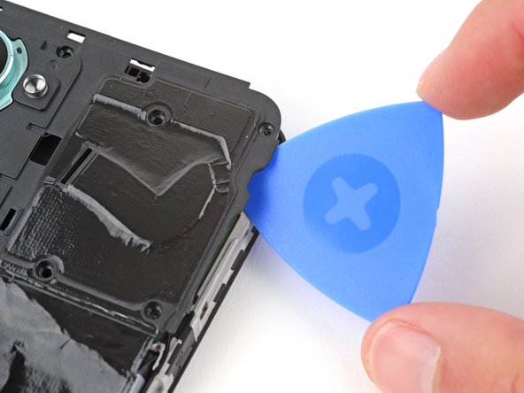

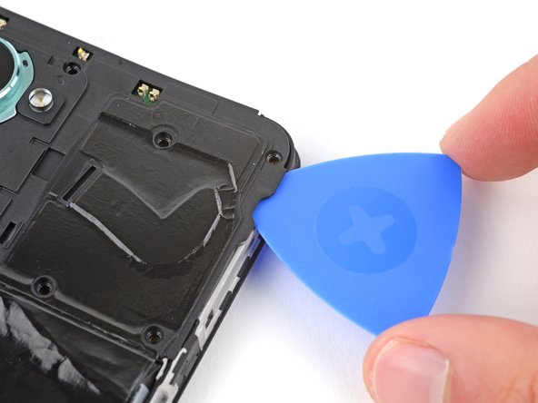

  3. HMD Pulse Pro Screen and Frame Assembly Replacement, Separate the back cover: crwdns2935265:03crwdnd2935265:01crwdnd2935265:02crwdne2935265:0 HMD Pulse Pro Screen and Frame Assembly Replacement, Separate the back cover: crwdns2935265:03crwdnd2935265:02crwdnd2935265:02crwdne2935265:0
    • Insert the tip of an opening pick between the back cover and frame, at the SIM card tray cutout.

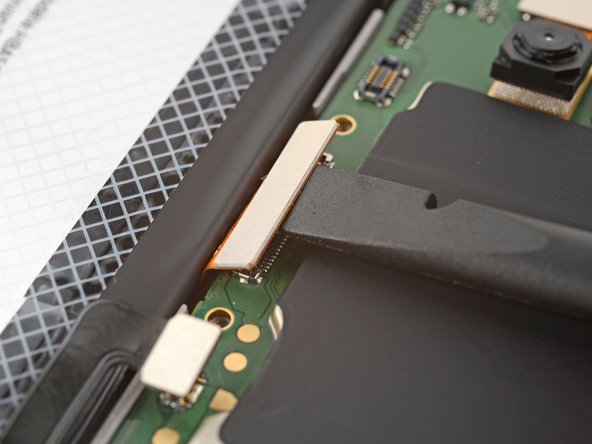

  10. HMD Pulse Pro Screen and Frame Assembly Replacement, Disconnect the battery: crwdns2935265:010crwdnd2935265:01crwdnd2935265:02crwdne2935265:0 HMD Pulse Pro Screen and Frame Assembly Replacement, Disconnect the battery: crwdns2935265:010crwdnd2935265:02crwdnd2935265:02crwdne2935265:0
    • Use the flat end of a spudger to pry up and disconnect the battery press connector from the bottom edge of the motherboard.
    • To reconnect these type of connectors, align the connector over its socket and press down with your fingertip—first at one side, then the other—until it clicks into place. Don't try to force the connector into place, or you may permanently damage it.

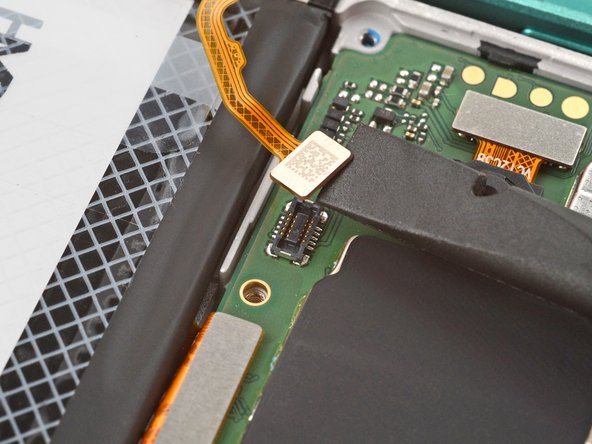

  11. HMD Pulse Pro Screen and Frame Assembly Replacement, Remove the back cover: crwdns2935265:011crwdnd2935265:01crwdnd2935265:02crwdne2935265:0 HMD Pulse Pro Screen and Frame Assembly Replacement, Remove the back cover: crwdns2935265:011crwdnd2935265:02crwdnd2935265:02crwdne2935265:0
    • Use the flat end of a spudger to pry up and disconnect the back cover press connector from the bottom edge of the motherboard.

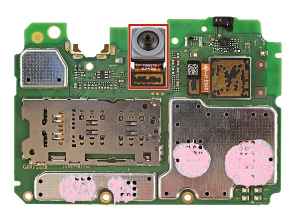

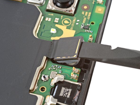

  16. HMD Pulse Pro Screen and Frame Assembly Replacement: crwdns2935265:016crwdnd2935265:01crwdnd2935265:02crwdne2935265:0 HMD Pulse Pro Screen and Frame Assembly Replacement: crwdns2935265:016crwdnd2935265:02crwdnd2935265:02crwdne2935265:0
    • Insert the flat end of a spudger under the top edge of the front camera and gently lift it out of its recess.
    • Don't try to remove the camera, as it's connected to the bottom of the motherboard.
    • During reassembly, push down on the front camera until it's snug in its recess.

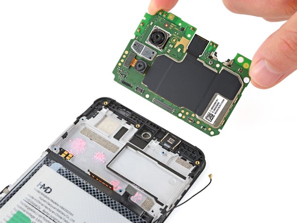

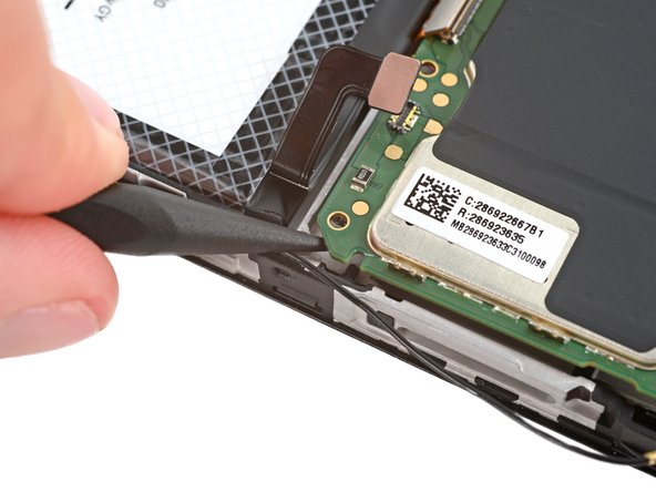

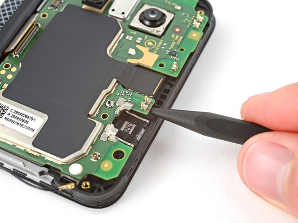

  17. HMD Pulse Pro Screen and Frame Assembly Replacement: crwdns2935265:017crwdnd2935265:01crwdnd2935265:03crwdne2935265:0 HMD Pulse Pro Screen and Frame Assembly Replacement: crwdns2935265:017crwdnd2935265:02crwdnd2935265:03crwdne2935265:0 HMD Pulse Pro Screen and Frame Assembly Replacement: crwdns2935265:017crwdnd2935265:03crwdnd2935265:03crwdne2935265:0
    • Use the point of a spudger to pry up the bottom right corner of the motherboard until it unclips.
    • If the board still feels stuck in place, use the spudger to pry up the top edge.
  18. HMD Pulse Pro Screen and Frame Assembly Replacement, Remove the motherboard: crwdns2935265:018crwdnd2935265:01crwdnd2935265:03crwdne2935265:0 HMD Pulse Pro Screen and Frame Assembly Replacement, Remove the motherboard: crwdns2935265:018crwdnd2935265:02crwdnd2935265:03crwdne2935265:0 HMD Pulse Pro Screen and Frame Assembly Replacement, Remove the motherboard: crwdns2935265:018crwdnd2935265:03crwdnd2935265:03crwdne2935265:0
    • Lift and remove the motherboard.
    • The front camera may have disconnected from the bottom of the board during removal. If it did, reconnect its press connector.
    • During reassembly:
    • Make sure the two press connectors on the bottom edge and the antenna cable on the right edge are out of the way so they don't get trapped underneath the board.
    • Lower the board into its recess and press down on the edges to clip it into place.

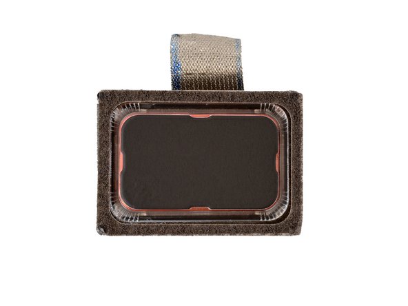

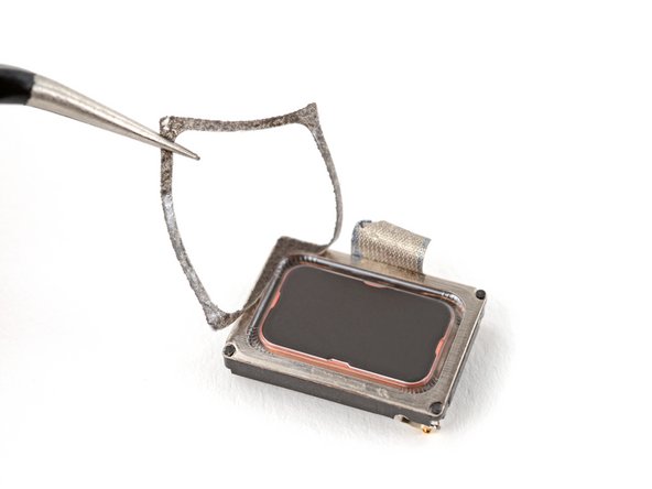

  20. HMD Pulse Pro Screen and Frame Assembly Replacement, Remove the earpiece speaker: crwdns2935265:020crwdnd2935265:01crwdnd2935265:03crwdne2935265:0 HMD Pulse Pro Screen and Frame Assembly Replacement, Remove the earpiece speaker: crwdns2935265:020crwdnd2935265:02crwdnd2935265:03crwdne2935265:0 HMD Pulse Pro Screen and Frame Assembly Replacement, Remove the earpiece speaker: crwdns2935265:020crwdnd2935265:03crwdnd2935265:03crwdne2935265:0
    • Use a spudger to pry up the earpiece speaker from the bottom edge of your phone.
    • Remove the speaker.
    • Remove the plastic liner from the earpiece speaker adhesive on the screen and frame assembly.
    • Push the speaker into place so the raised ends of its metal contact arms are on the bottom edge.

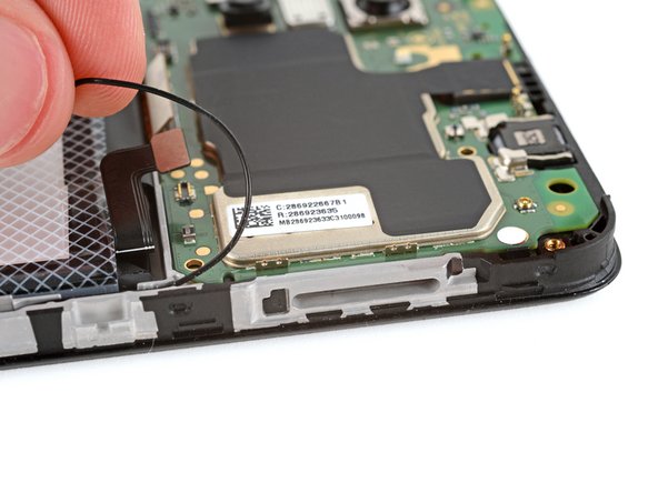

  25. HMD Pulse Pro Screen and Frame Assembly Replacement: crwdns2935265:025crwdnd2935265:01crwdnd2935265:02crwdne2935265:0 HMD Pulse Pro Screen and Frame Assembly Replacement: crwdns2935265:025crwdnd2935265:02crwdnd2935265:02crwdne2935265:0
    • Slide one arm of a pair of tweezers under the metal neck of the black antenna cable's connector head, near the center of the board.
    • Lift straight up to disconnect the cable.
    • To reconnect the cable, hold the metal head over its socket and press down with the flat end of a spudger—it should snap into place. If it's not connecting, reposition the head and try again.
