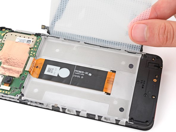

  15. HMD Pulse+ Battery Replacement: crwdns2935265:015crwdnd2935265:01crwdnd2935265:02crwdne2935265:0 HMD Pulse+ Battery Replacement: crwdns2935265:015crwdnd2935265:02crwdnd2935265:02crwdne2935265:0
    • Use your fingers to peel the battery's plastic film from the frame.
  16. HMD Pulse+ Battery Replacement: crwdns2935265:016crwdnd2935265:01crwdnd2935265:02crwdne2935265:0 HMD Pulse+ Battery Replacement: crwdns2935265:016crwdnd2935265:02crwdnd2935265:02crwdne2935265:0
    • Remove the battery and its film.
    • During reassembly:
    • Never reuse a deformed or damaged battery, as it's a potential safety hazard. Replace it with a new battery.
    • Use a spudger and tweezers to peel up and remove the two pieces of battery adhesive.
    • Apply the new adhesive to the frame and remove the plastic liners.
    • Firmly press the battery into its recess so the cable is on the top edge and the three tabs are on the left edge.
