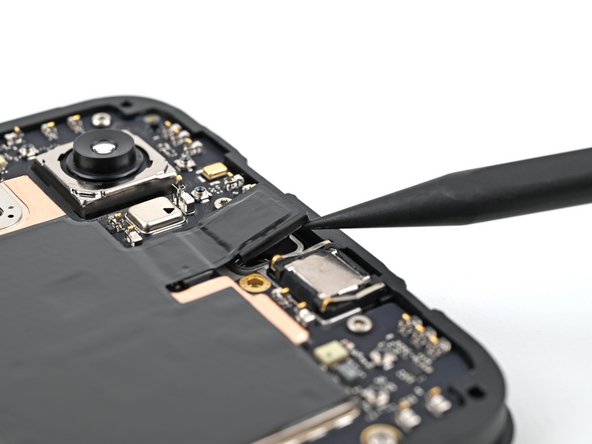

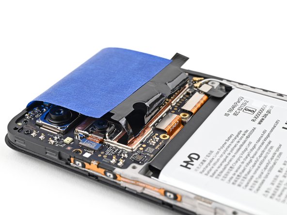

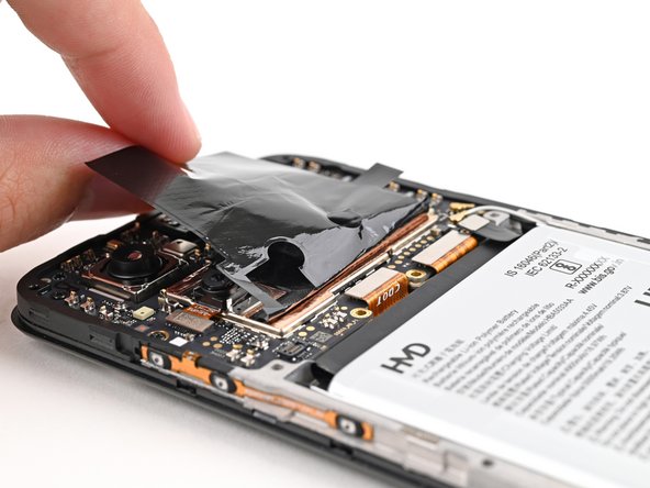

    1. HMD Fusion Screen Replacement, Screen: crwdns2935265:011crwdnd2935265:01crwdnd2935265:03crwdne2935265:0 HMD Fusion Screen Replacement, Screen: crwdns2935265:011crwdnd2935265:02crwdnd2935265:03crwdne2935265:0 HMD Fusion Screen Replacement, Screen: crwdns2935265:011crwdnd2935265:03crwdnd2935265:03crwdne2935265:0
      • For the next step, you'll need to hold the graphite sheet out of the way of the display connector along the bottom of the motherboard.
      • Alternatively, you can use tape with light adhesive (such as painter's tape) to keep the graphite sheet out of the way.

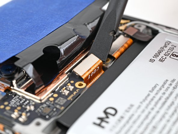

    2. HMD Fusion Screen Replacement, Disconnect the display: crwdns2935265:012crwdnd2935265:01crwdnd2935265:02crwdne2935265:0 HMD Fusion Screen Replacement, Disconnect the display: crwdns2935265:012crwdnd2935265:02crwdnd2935265:02crwdne2935265:0
      • Use a spudger to pry up and disconnect the display press connector.
      • Pry under the right edge of the connector, as there are delicate surface‑mounted components to the left of it.

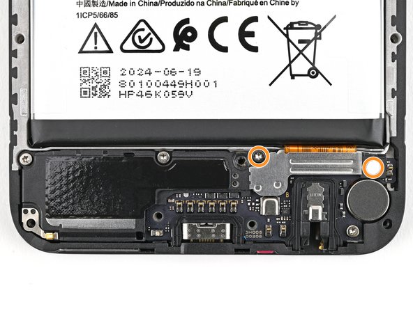

    4. HMD Fusion Screen Replacement, Remove the screen screws: crwdns2935265:014crwdnd2935265:01crwdnd2935265:02crwdne2935265:0 HMD Fusion Screen Replacement, Remove the screen screws: crwdns2935265:014crwdnd2935265:02crwdnd2935265:02crwdne2935265:0
      • Use a T3 Torx screwdriver to remove the seven 3.3 mm‑long screws securing the screen:
      • Five screws on the motherboard
      • Two screws on the loudspeaker
      • One of the screws on the loudspeaker may be covered by a sticker. Pierce through it with your screwdriver, or use tweezers to remove it.

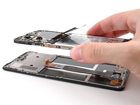

    5. HMD Fusion Screen Replacement, Remove the screen: crwdns2935265:015crwdnd2935265:01crwdnd2935265:02crwdne2935265:0 HMD Fusion Screen Replacement, Remove the screen: crwdns2935265:015crwdnd2935265:02crwdnd2935265:02crwdne2935265:0
      • Lift the screen off the frame, making sure to thread the display cable through its slot.
      • Remove the screen.
