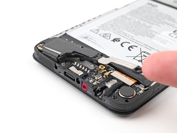

  11. HMD Fusion Business Charging Board Replacement, Remove the loudspeaker screws: crwdns2935265:011crwdnd2935265:01crwdnd2935265:02crwdne2935265:0 HMD Fusion Business Charging Board Replacement, Remove the loudspeaker screws: crwdns2935265:011crwdnd2935265:02crwdnd2935265:02crwdne2935265:0
    • Be careful not to puncture or damage the battery with your tool during the rest of this guide.
    • Use a T3 Torx screwdriver to remove the three 3.4 mm‑long screws securing the loudspeaker.
    • One of the screws on the loudspeaker may be covered by a sticker. Pierce through it with your screwdriver, or use tweezers to remove it.

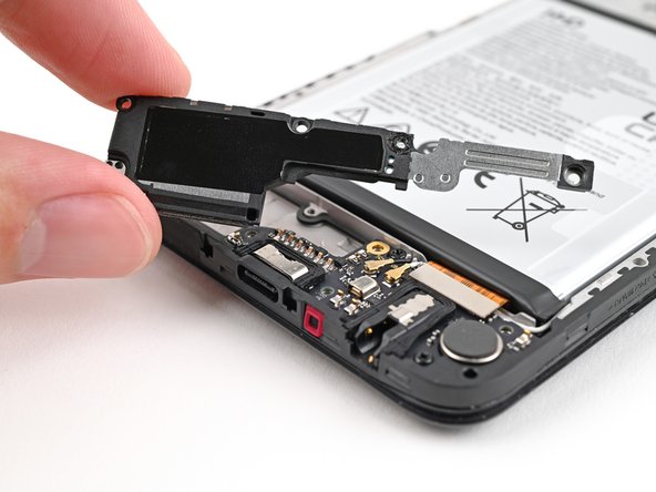

  12. HMD Fusion Business Charging Board Replacement, Remove the loudspeaker: crwdns2935265:012crwdnd2935265:01crwdnd2935265:03crwdne2935265:0 HMD Fusion Business Charging Board Replacement, Remove the loudspeaker: crwdns2935265:012crwdnd2935265:02crwdnd2935265:03crwdne2935265:0 HMD Fusion Business Charging Board Replacement, Remove the loudspeaker: crwdns2935265:012crwdnd2935265:03crwdnd2935265:03crwdne2935265:0
    • Use your fingers to lift the loudspeaker out of the frame by its metal bracket.
    • Remove the loudspeaker.

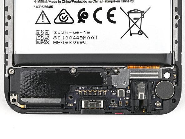

  13. HMD Fusion Business Charging Board Replacement, Disconnect the charging board: crwdns2935265:013crwdnd2935265:01crwdnd2935265:03crwdne2935265:0 HMD Fusion Business Charging Board Replacement, Disconnect the charging board: crwdns2935265:013crwdnd2935265:02crwdnd2935265:03crwdne2935265:0 HMD Fusion Business Charging Board Replacement, Disconnect the charging board: crwdns2935265:013crwdnd2935265:03crwdnd2935265:03crwdne2935265:0
    • Slide one arm of a pair of tweezers under the metal neck of the black antenna cable's connector head, near the center of the board.
    • Lift straight up to disconnect the cable.
    • Repeat for the white antenna cable.
    • To reconnect the cable, hold the metal head over its socket and press down with the flat end of a spudger—it should snap into place. If it's not connecting, reposition the head and try again.

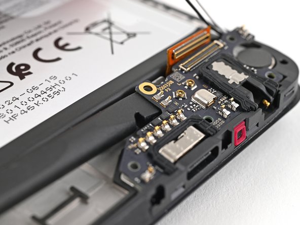

  14. HMD Fusion Business Charging Board Replacement: crwdns2935265:014crwdnd2935265:01crwdnd2935265:02crwdne2935265:0 HMD Fusion Business Charging Board Replacement: crwdns2935265:014crwdnd2935265:02crwdnd2935265:02crwdne2935265:0
    • Use a spudger to pry up and disconnect the interconnect cable press connector.

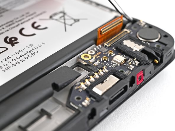

  15. HMD Fusion Business Charging Board Replacement: crwdns2935265:015crwdnd2935265:01crwdnd2935265:03crwdne2935265:0 HMD Fusion Business Charging Board Replacement: crwdns2935265:015crwdnd2935265:02crwdnd2935265:03crwdne2935265:0 HMD Fusion Business Charging Board Replacement: crwdns2935265:015crwdnd2935265:03crwdnd2935265:03crwdne2935265:0
    • Move the interconnect cable press connector toward the battery to keep it out of the way of the charging board in the next step.
    • You can use tape with light adhesive (such as painter's tape) to keep the cable out of the way.
  16. HMD Fusion Business Charging Board Replacement: crwdns2935265:016crwdnd2935265:01crwdnd2935265:02crwdne2935265:0 HMD Fusion Business Charging Board Replacement: crwdns2935265:016crwdnd2935265:02crwdnd2935265:02crwdne2935265:0
    • Use tweezers, or your fingers, to move the two antenna cables out of their slots near the top edge of the charging board.

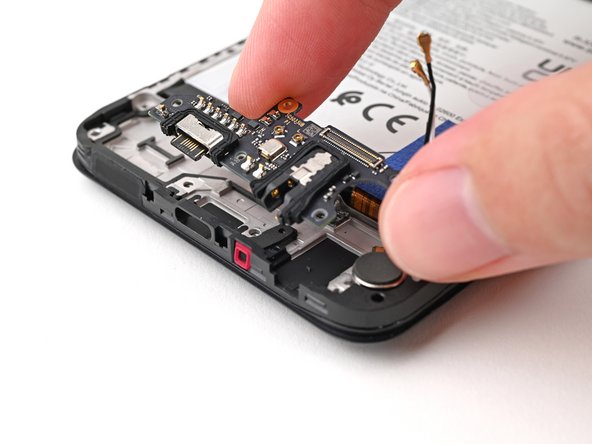

  17. HMD Fusion Business Charging Board Replacement, Remove the charging board screw: crwdns2935265:017crwdnd2935265:01crwdnd2935265:02crwdne2935265:0 HMD Fusion Business Charging Board Replacement, Remove the charging board screw: crwdns2935265:017crwdnd2935265:02crwdnd2935265:02crwdne2935265:0
    • Use a T3 Torx screwdriver to remove the 3.3 mm‑long screw securing the charging board.

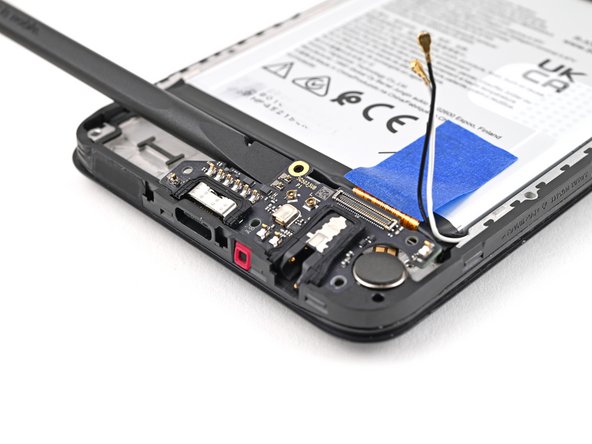

  18. HMD Fusion Business Charging Board Replacement, Remove the charging board: crwdns2935265:018crwdnd2935265:01crwdnd2935265:03crwdne2935265:0 HMD Fusion Business Charging Board Replacement, Remove the charging board: crwdns2935265:018crwdnd2935265:02crwdnd2935265:03crwdne2935265:0 HMD Fusion Business Charging Board Replacement, Remove the charging board: crwdns2935265:018crwdnd2935265:03crwdnd2935265:03crwdne2935265:0
    • The top edge of the charging board is adhered to the frame.
    • Insert the flat end of a spudger under the top left edge of the charging board, next to the antenna cable connectors.
    • Slide the spudger under the charging board to separate the adhesive.
  19. HMD Fusion Business Charging Board Replacement: crwdns2935265:019crwdnd2935265:01crwdnd2935265:03crwdne2935265:0 HMD Fusion Business Charging Board Replacement: crwdns2935265:019crwdnd2935265:02crwdnd2935265:03crwdne2935265:0 HMD Fusion Business Charging Board Replacement: crwdns2935265:019crwdnd2935265:03crwdnd2935265:03crwdne2935265:0
    • Lift the charging board out of the frame and remove it.
    • During reassembly, insert the USB-C port into its slot before pressing the charging board flat to the frame.
