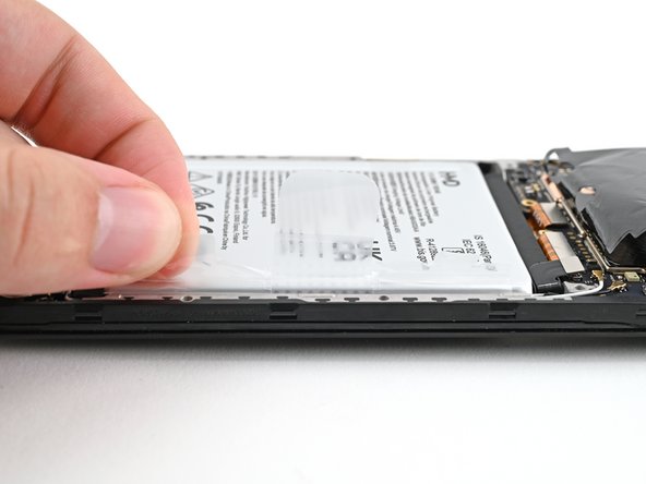

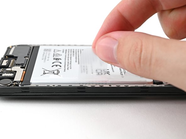

  11. HMD Fusion Business Battery Replacement, Remove the battery: crwdns2935265:011crwdnd2935265:01crwdnd2935265:03crwdne2935265:0 HMD Fusion Business Battery Replacement, Remove the battery: crwdns2935265:011crwdnd2935265:02crwdnd2935265:03crwdne2935265:0 HMD Fusion Business Battery Replacement, Remove the battery: crwdns2935265:011crwdnd2935265:03crwdnd2935265:03crwdne2935265:0
    • Be very careful not to bend, crease, or puncture the battery during the next few steps. A damaged battery can leak dangerous chemicals and catch fire.
    • Use your fingers to carefully peel the three plastic tabs from the right side of the battery.
  12. HMD Fusion Business Battery Replacement: crwdns2935265:012crwdnd2935265:01crwdnd2935265:03crwdne2935265:0 HMD Fusion Business Battery Replacement: crwdns2935265:012crwdnd2935265:02crwdnd2935265:03crwdne2935265:0 HMD Fusion Business Battery Replacement: crwdns2935265:012crwdnd2935265:03crwdnd2935265:03crwdne2935265:0
    • With one hand, fold the two outer tabs out of the way of the battery and firmly hold them down to secure the frame.
    • If you're having trouble with the tabs, you can fold them under the phone and tape them to the screen.
    • With your free hand, grip the center pull tab and pull straight up to fully separate the battery adhesive.
    • Lay the battery over the left edge of your phone.

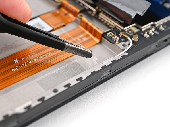

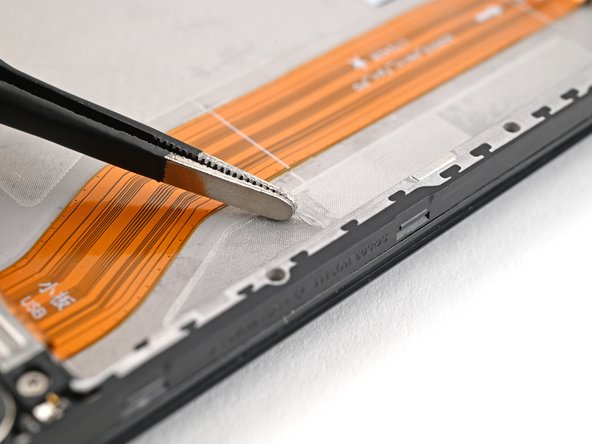

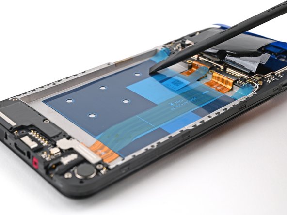

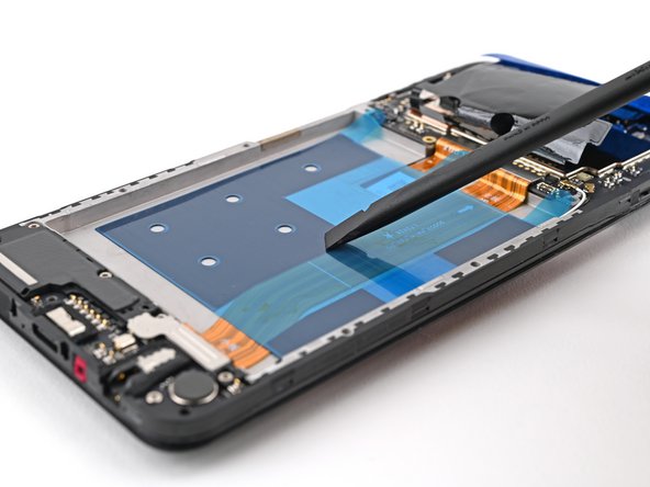

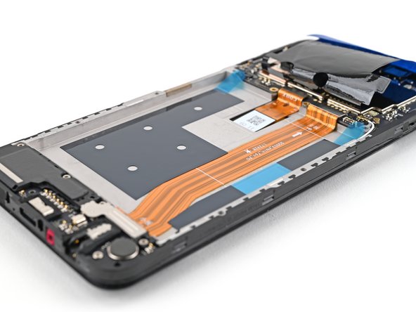

  14. HMD Fusion Business Battery Replacement, Remove the battery adhesive: crwdns2935265:014crwdnd2935265:01crwdnd2935265:03crwdne2935265:0 HMD Fusion Business Battery Replacement, Remove the battery adhesive: crwdns2935265:014crwdnd2935265:02crwdnd2935265:03crwdne2935265:0 HMD Fusion Business Battery Replacement, Remove the battery adhesive: crwdns2935265:014crwdnd2935265:03crwdnd2935265:03crwdne2935265:0
    • Use tweezers, or your fingers, to peel the three battery adhesive strips off the frame.

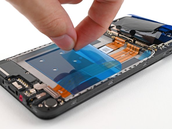

  15. HMD Fusion Business Battery Replacement, Apply the new battery adhesive: crwdns2935265:015crwdnd2935265:01crwdnd2935265:02crwdne2935265:0 HMD Fusion Business Battery Replacement, Apply the new battery adhesive: crwdns2935265:015crwdnd2935265:02crwdnd2935265:02crwdne2935265:0
    • Align the new battery adhesive over the frame, making sure that the three adhesive strips overlap properly.
  16. HMD Fusion Business Battery Replacement: crwdns2935265:016crwdnd2935265:01crwdnd2935265:03crwdne2935265:0 HMD Fusion Business Battery Replacement: crwdns2935265:016crwdnd2935265:02crwdnd2935265:03crwdne2935265:0 HMD Fusion Business Battery Replacement: crwdns2935265:016crwdnd2935265:03crwdnd2935265:03crwdne2935265:0
    • Peel off the clear liner from the new battery adhesive.
    • Align an edge of the adhesive with the textured surface on the frame and press it down flat.

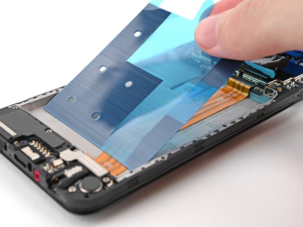

  17. HMD Fusion Business Battery Replacement: crwdns2935265:017crwdnd2935265:01crwdnd2935265:03crwdne2935265:0 HMD Fusion Business Battery Replacement: crwdns2935265:017crwdnd2935265:02crwdnd2935265:03crwdne2935265:0 HMD Fusion Business Battery Replacement: crwdns2935265:017crwdnd2935265:03crwdnd2935265:03crwdne2935265:0
    • Use the flat end of a spudger or your fingers to press the adhesive onto the frame.

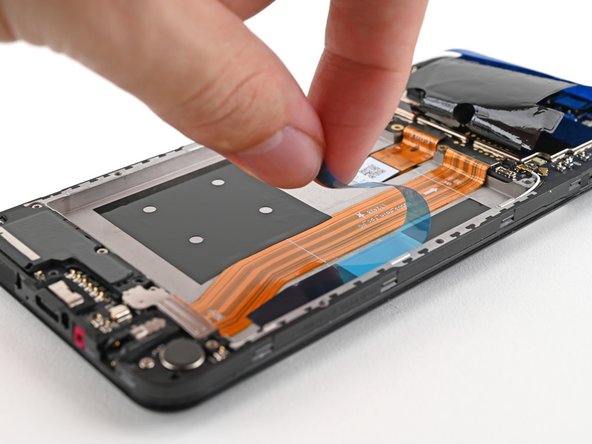

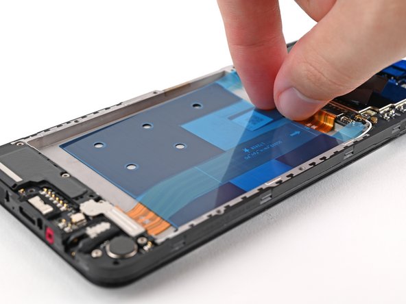

  18. HMD Fusion Business Battery Replacement: crwdns2935265:018crwdnd2935265:01crwdnd2935265:03crwdne2935265:0 HMD Fusion Business Battery Replacement: crwdns2935265:018crwdnd2935265:02crwdnd2935265:03crwdne2935265:0 HMD Fusion Business Battery Replacement: crwdns2935265:018crwdnd2935265:03crwdnd2935265:03crwdne2935265:0
    • Grip the middle pull tab on the larger blue liner and peel it off the adhesive.
    • You have to remove this liner first, as it sits on top of the other two liners.

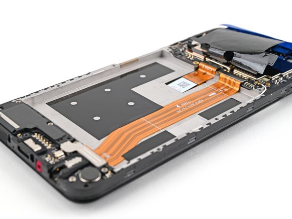

  19. HMD Fusion Business Battery Replacement: crwdns2935265:019crwdnd2935265:01crwdnd2935265:03crwdne2935265:0 HMD Fusion Business Battery Replacement: crwdns2935265:019crwdnd2935265:02crwdnd2935265:03crwdne2935265:0 HMD Fusion Business Battery Replacement: crwdns2935265:019crwdnd2935265:03crwdnd2935265:03crwdne2935265:0
    • Remove the two remaining liners to expose the adhesive.
