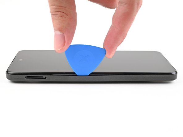

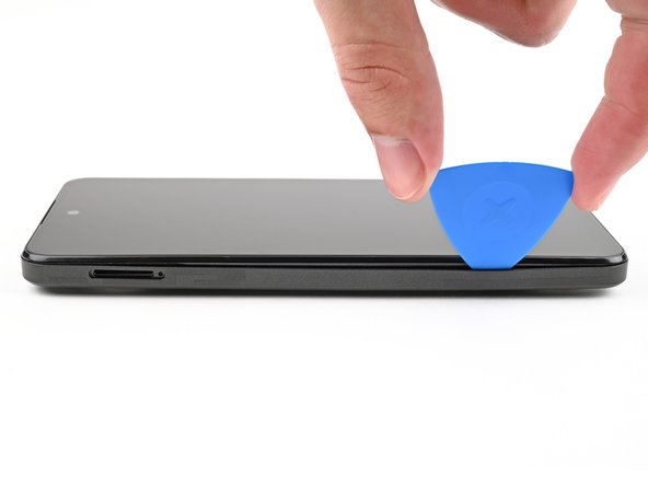

  4. HMD Fusion Business Back Cover Replacement, Unclip the back cover: crwdns2935265:04crwdnd2935265:01crwdnd2935265:02crwdne2935265:0 HMD Fusion Business Back Cover Replacement, Unclip the back cover: crwdns2935265:04crwdnd2935265:02crwdnd2935265:02crwdne2935265:0
    • Flip your phone over so the screen is facing up.

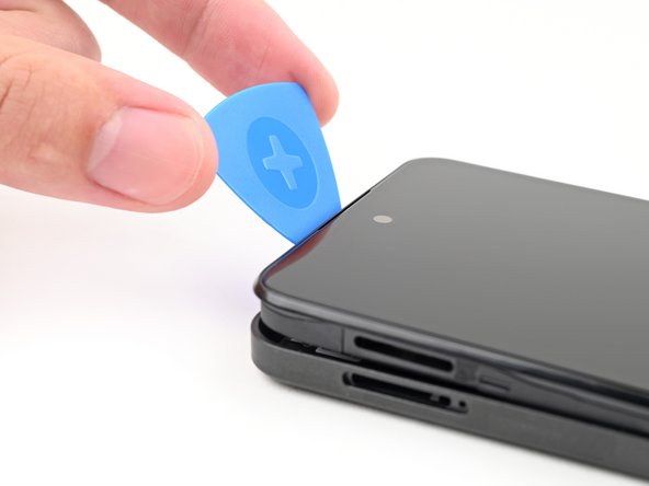

    • Insert the tip of an opening pick between the back cover and frame at the SIM card tray cutout.
  5. HMD Fusion Business Back Cover Replacement: crwdns2935265:05crwdnd2935265:01crwdnd2935265:03crwdne2935265:0 HMD Fusion Business Back Cover Replacement: crwdns2935265:05crwdnd2935265:02crwdnd2935265:03crwdne2935265:0 HMD Fusion Business Back Cover Replacement: crwdns2935265:05crwdnd2935265:03crwdnd2935265:03crwdne2935265:0
    • Slide the opening pick along the left edge to begin unclipping the back cover.

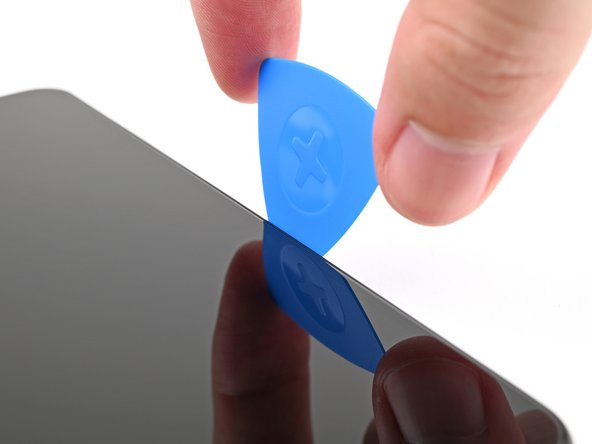

  6. HMD Fusion Business Back Cover Replacement: crwdns2935265:06crwdnd2935265:01crwdnd2935265:03crwdne2935265:0 HMD Fusion Business Back Cover Replacement: crwdns2935265:06crwdnd2935265:02crwdnd2935265:03crwdne2935265:0 HMD Fusion Business Back Cover Replacement: crwdns2935265:06crwdnd2935265:03crwdnd2935265:03crwdne2935265:0
    • Continue sliding the pick around the perimeter of your phone until the back cover is fully unclipped.
    • The corners can be tricky to unclip and may take some force. If you're having trouble, try prying up with the pick.
    • Don't try to fully remove the cover yet, as it's still connected by a delicate cable.

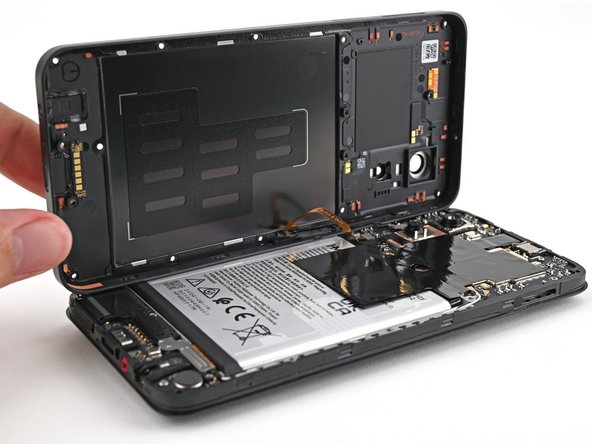

  7. HMD Fusion Business Back Cover Replacement: crwdns2935265:07crwdnd2935265:01crwdnd2935265:03crwdne2935265:0 HMD Fusion Business Back Cover Replacement: crwdns2935265:07crwdnd2935265:02crwdnd2935265:03crwdne2935265:0 HMD Fusion Business Back Cover Replacement: crwdns2935265:07crwdnd2935265:03crwdnd2935265:03crwdne2935265:0

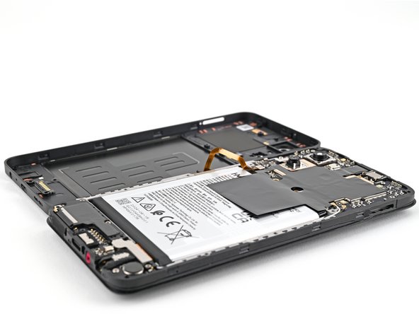

    • Carefully flip your phone over so the back cover is facing up.
    • Lift the back cover off the frame and flip it over the left edge of your phone, laying the cover flat on your work surface.
    • Be very careful not to strain the back cover's delicate cable.
    • During reassembly, place the back cover onto the frame and firmly press around the perimeter to reengage all the clips.

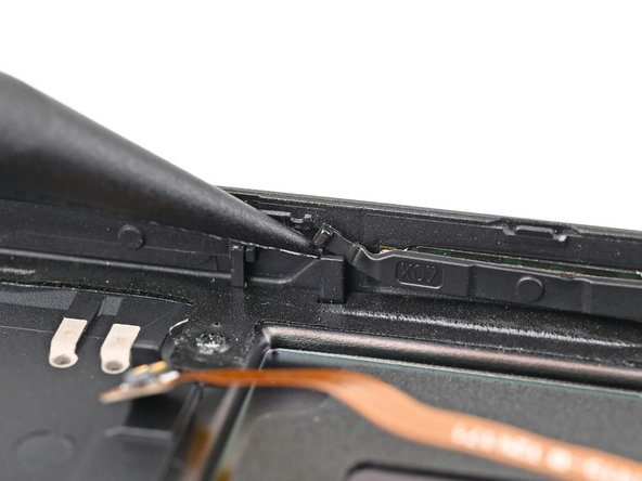

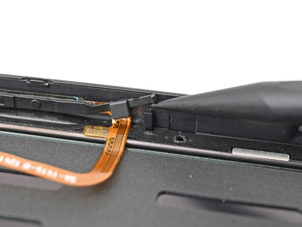

    • If your replacement back cover doesn't come with a power button pre-installed, follow the next two steps to remove and transfer it.
    • Use the tip of a spudger to lift the two rubber arms securing the power button out of their slots in the back cover.
  11. HMD Fusion Business Back Cover Replacement: crwdns2935265:011crwdnd2935265:01crwdnd2935265:01crwdne2935265:0
    • Lift the power button out of the recess in the back cover and remove it.
