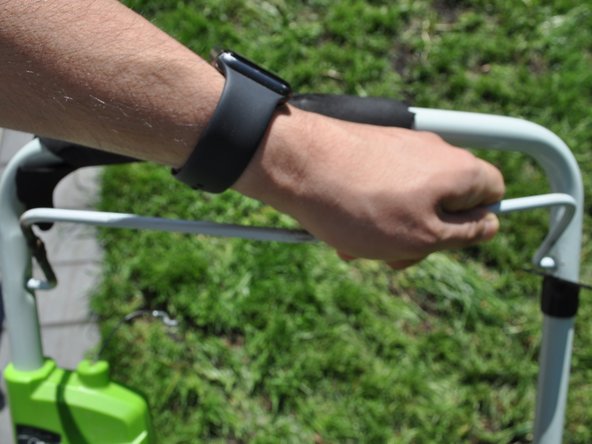

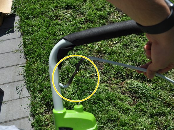

    • As seen in the picture, the lever is snapped on one side of the lever and needs replacement.
  2. GreenWork 10A 16" Lawn Mower Starter Lever Replacement: crwdns2935265:02crwdnd2935265:01crwdnd2935265:03crwdne2935265:0 GreenWork 10A 16" Lawn Mower Starter Lever Replacement: crwdns2935265:02crwdnd2935265:02crwdnd2935265:03crwdne2935265:0 GreenWork 10A 16" Lawn Mower Starter Lever Replacement: crwdns2935265:02crwdnd2935265:03crwdnd2935265:03crwdne2935265:0

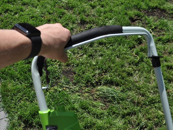

    • Lift from the wire to line up the hook.
    • When the hook is lined, pull the wire from the lever.
    • The wire may get stuck, but do not pull the wire with resistance to avoid damage.
    • Move the wire away from the lever.
    • Ensure that the hook is still attached to the wire.

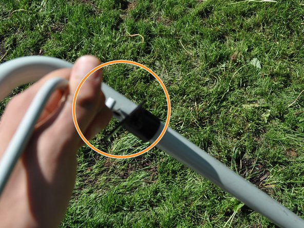

  3. GreenWork 10A 16" Lawn Mower Starter Lever Replacement: crwdns2935265:03crwdnd2935265:01crwdnd2935265:03crwdne2935265:0 GreenWork 10A 16" Lawn Mower Starter Lever Replacement: crwdns2935265:03crwdnd2935265:02crwdnd2935265:03crwdne2935265:0 GreenWork 10A 16" Lawn Mower Starter Lever Replacement: crwdns2935265:03crwdnd2935265:03crwdnd2935265:03crwdne2935265:0

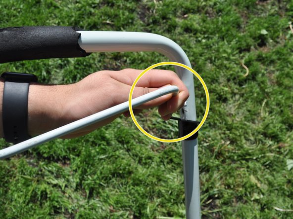

    • Pull the lever that is broken.
    • Start with the right side first as the left is hooked in.
    • Pull the lever from the drill.
    • Tilt the lever down before removing the left side.
    • When the lever is tilted down, you can pull the lever out of the drill.
    • The lever may get stuck on the left side, but ensure to fully tilt the lever down.
    • If the lever is snapped, remove it one side at a time with an adjustable wrench.

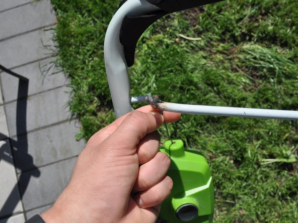

  4. GreenWork 10A 16" Lawn Mower Starter Lever Replacement: crwdns2935265:04crwdnd2935265:01crwdnd2935265:03crwdne2935265:0 GreenWork 10A 16" Lawn Mower Starter Lever Replacement: crwdns2935265:04crwdnd2935265:02crwdnd2935265:03crwdne2935265:0 GreenWork 10A 16" Lawn Mower Starter Lever Replacement: crwdns2935265:04crwdnd2935265:03crwdnd2935265:03crwdne2935265:0

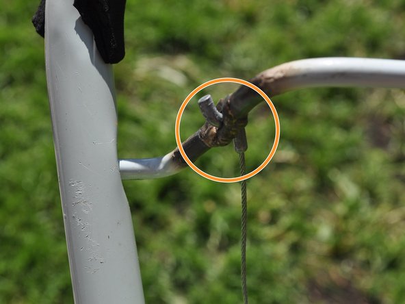

    • Insert the new lever starting with the left side while it is tilted downwards.
    • When the lever is put in when tilted down then move in to the next step.
    • Tilt the lever up so that the lever on the left is fully inserted.
    • Squeeze the right side of the lever to Insert the right side of the lever.
    • Put the right side of the lever into the drill in the mowers handle.

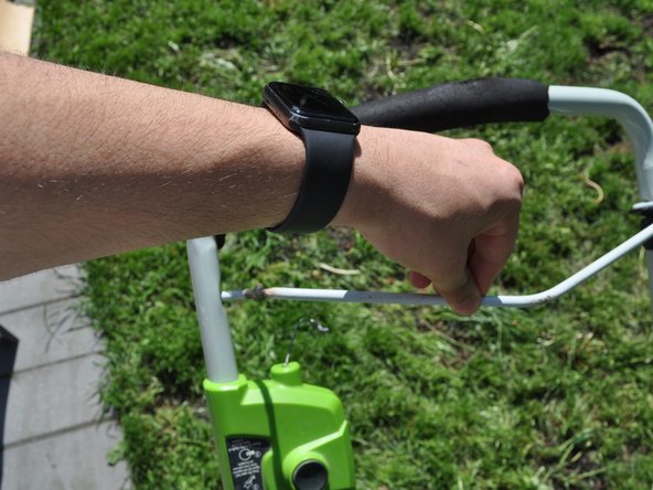

    • Ensure that the lever moves back with ease.
    • When moving the lever up and down, If it gets stuck or has resistance, this may be problematic.
    • If it gets stuck or does not move smoothly, it might not be fully in place
    • Repeat to step 3 and 5 to fix it.

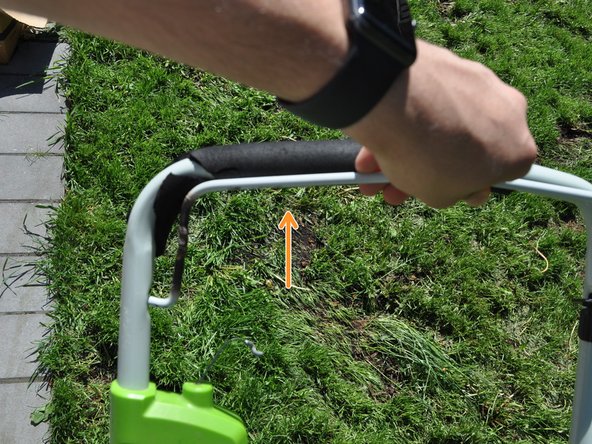

    • Insert the new wire.
    • This wire should be put in sideways (wire raised up).
    • Put the hook fully through the hole.
    • Then tilt the wire down to ensure that it is in place.
