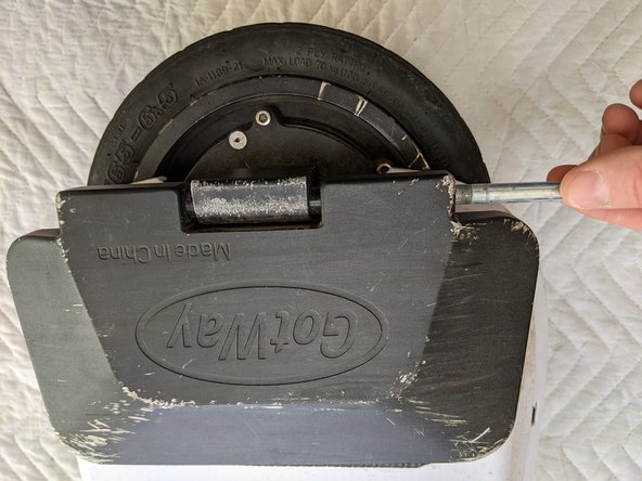

  3. Gotway Begode Mten3 Tire or Inner Tube Replacement, Remove Left Foot Pedal: crwdns2935265:03crwdnd2935265:01crwdnd2935265:02crwdne2935265:0 Gotway Begode Mten3 Tire or Inner Tube Replacement, Remove Left Foot Pedal: crwdns2935265:03crwdnd2935265:02crwdnd2935265:02crwdne2935265:0
    • Lay the machine left-side-up with the anti-spin switch facing up
    • Remove the two 5mm hex Allen set screws, one at each end of the left foot pedal
    • Use the Allen tool to push the hinge pin, and then remove the hinge pin
    • Set aside the foot pedal, allen screws, spacers, and hinge pin

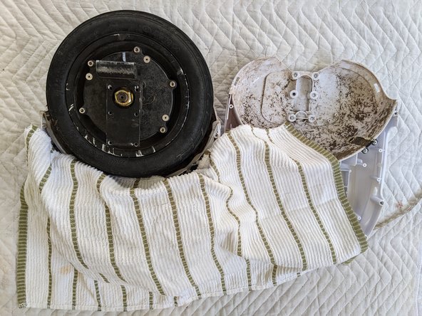

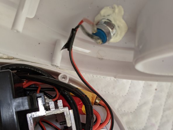

  9. Gotway Begode Mten3 Tire or Inner Tube Replacement, Protect the electrical components: crwdns2935265:09crwdnd2935265:01crwdnd2935265:02crwdne2935265:0 Gotway Begode Mten3 Tire or Inner Tube Replacement, Protect the electrical components: crwdns2935265:09crwdnd2935265:02crwdnd2935265:02crwdne2935265:0
    • Once you open the case, the electrical components will be relatively exposed. The battery has enough voltage to shock you. Foreign objects (FOD), dripping sweat, dropped tools, pulled connector mates and cable ends, or flexed wires could have unintended consequences including malfunction of safety features.
    • Lay the halves of the case open side by side so that the wiring for the anti-spin-out switch is slack
    • Disconnect the battery. Cover the battery connector, for example with tape or a small plastic bag.
    • Cover the battery and controller with a shop rag or towel.

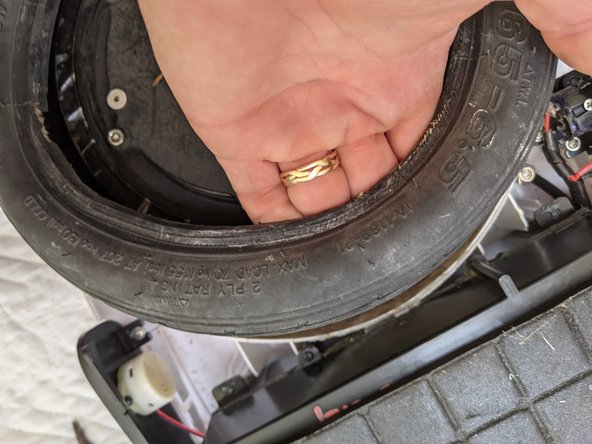

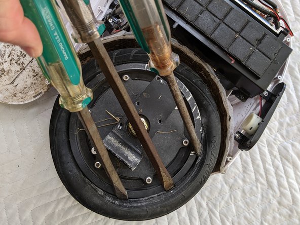

  10. Gotway Begode Mten3 Tire or Inner Tube Replacement, Remove the tire (pry method): crwdns2935265:010crwdnd2935265:01crwdnd2935265:03crwdne2935265:0 Gotway Begode Mten3 Tire or Inner Tube Replacement, Remove the tire (pry method): crwdns2935265:010crwdnd2935265:02crwdnd2935265:03crwdne2935265:0 Gotway Begode Mten3 Tire or Inner Tube Replacement, Remove the tire (pry method): crwdns2935265:010crwdnd2935265:03crwdnd2935265:03crwdne2935265:0

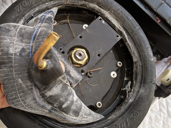

    • Two ways to go here. One, you could pry one side of the bead and lift the bead over the rim, using giant pry tools, and you might damage the bead or the rim like I did.
    • This is enough to remove and replace the tube.

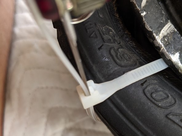

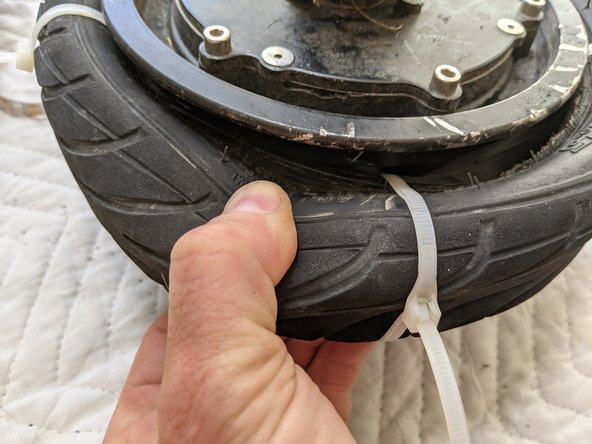

  11. Gotway Begode Mten3 Tire or Inner Tube Replacement, Remove the tire (zip tie method): crwdns2935265:011crwdnd2935265:01crwdnd2935265:03crwdne2935265:0 Gotway Begode Mten3 Tire or Inner Tube Replacement, Remove the tire (zip tie method): crwdns2935265:011crwdnd2935265:02crwdnd2935265:03crwdne2935265:0 Gotway Begode Mten3 Tire or Inner Tube Replacement, Remove the tire (zip tie method): crwdns2935265:011crwdnd2935265:03crwdnd2935265:03crwdne2935265:0
    • Alternatively, the zip-tie method should allow you to remove the tire entirely, without using tools.
    • Thread at least five zip ties between the rim and the tube/tire, all the way through the channel, equally spaced around the rim.
    • For each zip tie, press the two tire beads together, with the tube inside the tire. Snug the zip tie so the beads are held closed together. This will allow the beads to drop into the channel at the center of the wheel.
    • It is now possible to pull the tire off-center and work it over the rim. A flat-blade screwdriver can be used, but hand strength may be sufficient.
    • The zip ties can be salvaged by inserting a knife blade between the parts of the fastener.
  12. Gotway Begode Mten3 Tire or Inner Tube Replacement, Inspect and Clean: crwdns2935265:012crwdnd2935265:01crwdnd2935265:03crwdne2935265:0 Gotway Begode Mten3 Tire or Inner Tube Replacement, Inspect and Clean: crwdns2935265:012crwdnd2935265:02crwdnd2935265:03crwdne2935265:0 Gotway Begode Mten3 Tire or Inner Tube Replacement, Inspect and Clean: crwdns2935265:012crwdnd2935265:03crwdnd2935265:03crwdne2935265:0
    • Examine Slime marker for location of puncture.
    • Use a vaccum cleaner, compressed air, or a damp cloth to remove any debris from inside the tire. You know what a rock in your shoe is like...
    • Feel for any sharp irritants remaining in the tire wall, giving special attention to the identified location of the puncture.
    • Add some powder in the tire and distribute it to reduce "blistering" friction between the tube and the tire.

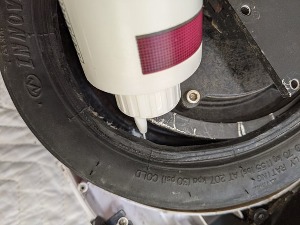

  13. Gotway Begode Mten3 Tire or Inner Tube Replacement, Reinstall tire with fresh tube: crwdns2935265:013crwdnd2935265:01crwdnd2935265:01crwdne2935265:0
    • This is probably as good a time as any to inject an ounce or so of Slime into the new tube. Be careful the tube does not open and fill with air.
    • Install at least 5 zip ties positioned around the tire, so that the tube is inside the tire and the beads are held closed together. Do not corrugate the tread wall, flatten it instead.
    • I was able to reinstall the tire using only hand strength and no tools.
    • The zip ties can be cut or salvaged.

    • Mind the anti-spin switch wiring. Brand new my Mten3 had glitchy erratic behavior blamed on this wire being pinched at the factory.
