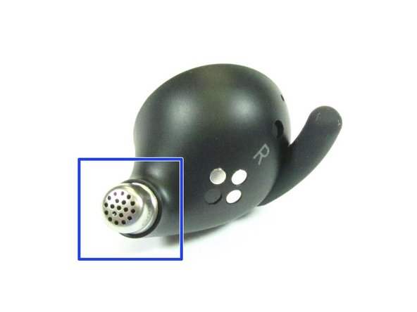

    • Components of the ear buds:
    • Microphone
    • Vent
    • Charging contacts
    • IR sensor for detecting when the bud is in the ear
    • Touch sensor
    • Sound chamber opening with mesh, our point of interest

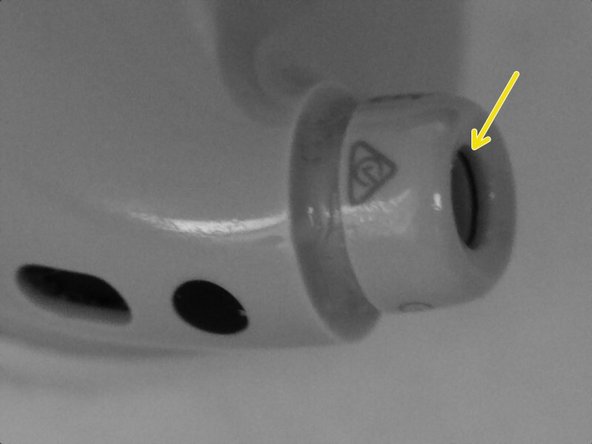

    • Take a small container, fill it with isopropyl alcohol and insert the buds so that the sound chamber opening - but not any other parts - touch the liquid.
    • Soaking time might vary depending on how degraded the glue already is. This can potentially take hours.
    • If longer soaking is necessary, I really recommend adding some glycerol to the alcohol solution to soften the glue and prevent rapid evaporation of the solvent.

    • The mesh we're going to remove. The mesh sits in a small groove in the plastic case and is held in by gooey black glue.
    • Groove (after mesh removal)

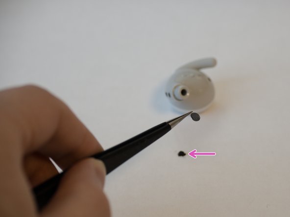

    • Carefully use fine tweezers to grab the loose mesh and pull it outside.
    • The mesh is likely still stuck to one side of the ridge (assuming you pushed carefully), so it should be easy to retrieve. If not, locate it in the sound chamber and carefully remove it.
    • Make sure to not touch or damage the speaker membrane further in the back. Only use a small, soft brush if the mesh is stuck on the back side of the sound chamber.
    • Most of the glue should have come out together with the mesh. If necessary, carefully remove any remaining residue with the tweezers or a soft brush.
    • Here's some of the sticky black glue.
Reassemble the rubber tips and test the ear buds. Hopefully, the problem should be gone.
The removed mesh could cause increased ingress of dirt and liquids in the future. You could try to create a new cover made out of fine brass mesh for example, but the removed cover mesh also allows you to carefully clean the inside, so this isn't a big deal.
