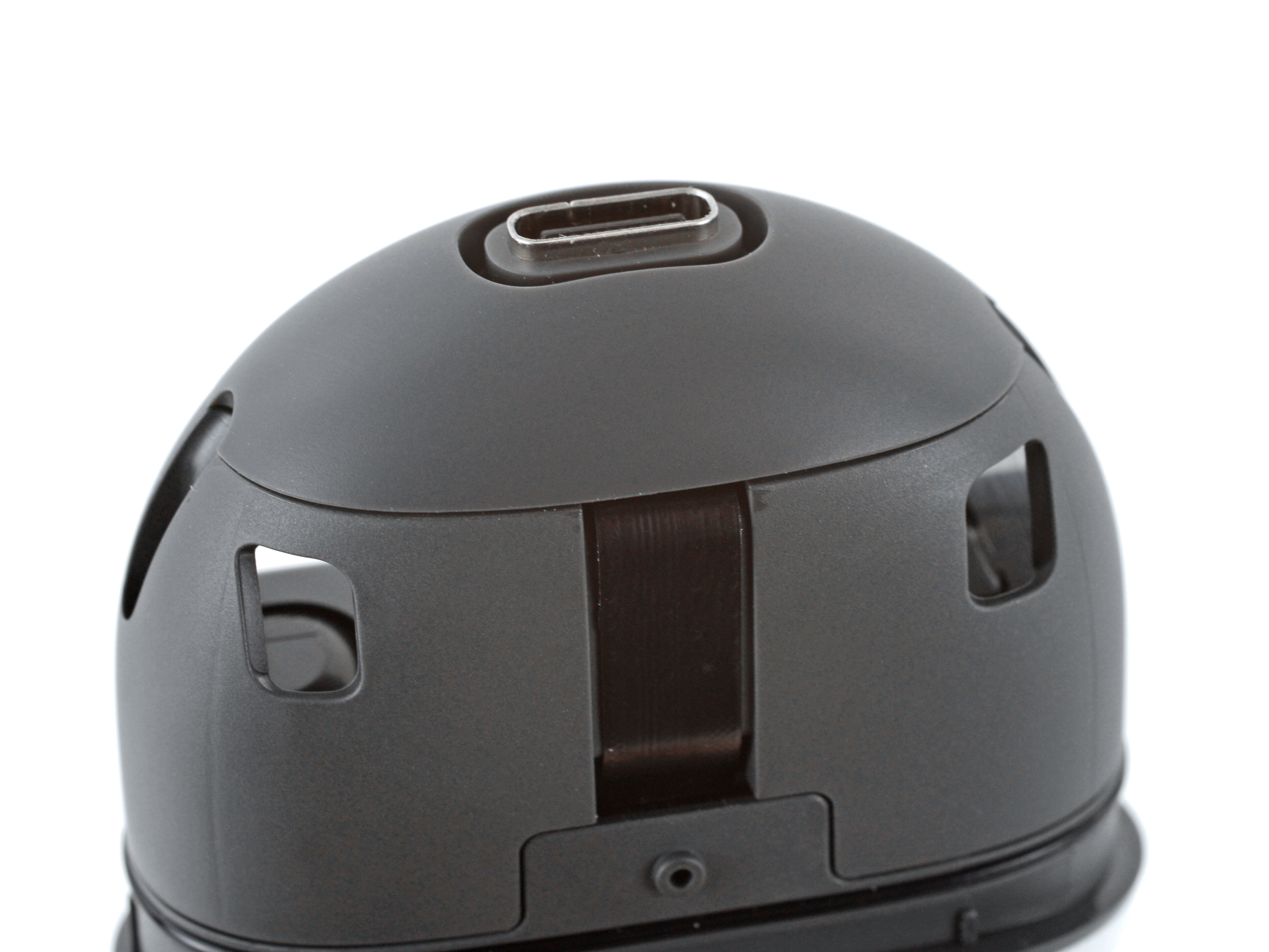

  4. Google Pixel Buds 2a USB‑C Board Replacement, Remove the bottom shell: crwdns2935265:04crwdnd2935265:01crwdnd2935265:03crwdne2935265:0 Google Pixel Buds 2a USB‑C Board Replacement, Remove the bottom shell: crwdns2935265:04crwdnd2935265:02crwdnd2935265:03crwdne2935265:0 Google Pixel Buds 2a USB‑C Board Replacement, Remove the bottom shell: crwdns2935265:04crwdnd2935265:03crwdnd2935265:03crwdne2935265:0
    • Slide the main body of the charging case completely out of the bottom shell, inserting a fingernail in the seam near the top of the case to create an initial gap.
    • If you're having trouble, use the flat end of a spudger to start the initial gap.

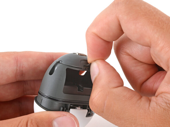

  5. Google Pixel Buds 2a USB‑C Board Replacement, Remove the battery: crwdns2935265:05crwdnd2935265:01crwdnd2935265:03crwdne2935265:0 Google Pixel Buds 2a USB‑C Board Replacement, Remove the battery: crwdns2935265:05crwdnd2935265:02crwdnd2935265:03crwdne2935265:0 Google Pixel Buds 2a USB‑C Board Replacement, Remove the battery: crwdns2935265:05crwdnd2935265:03crwdnd2935265:03crwdne2935265:0
    • Grip the small green tab on the back of the charging case and pull the battery out of its recess.
    • The battery fits snugly in place—this may take a little bit of force.

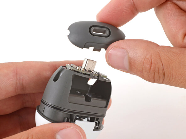

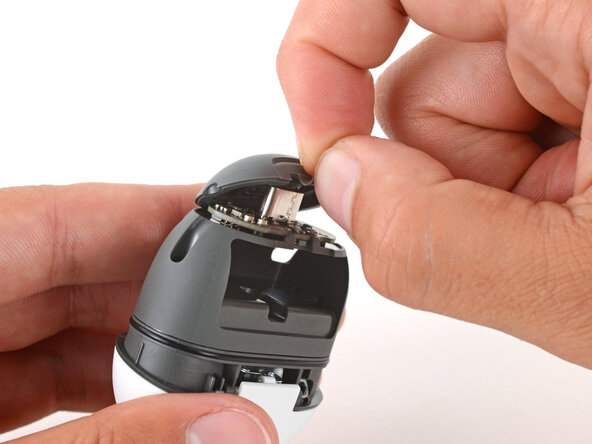

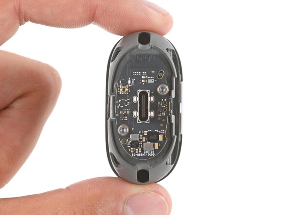

  6. Google Pixel Buds 2a USB‑C Board Replacement, Remove the silicone cover: crwdns2935265:06crwdnd2935265:01crwdnd2935265:03crwdne2935265:0 Google Pixel Buds 2a USB‑C Board Replacement, Remove the silicone cover: crwdns2935265:06crwdnd2935265:02crwdnd2935265:03crwdne2935265:0 Google Pixel Buds 2a USB‑C Board Replacement, Remove the silicone cover: crwdns2935265:06crwdnd2935265:03crwdnd2935265:03crwdne2935265:0
    • Use the small tab to peel up and remove the silicone dust cover from the bottom of the charging case.
    • If you're having trouble, use a spudger to begin lifting the cover.
    • During reassembly, press the dust cover into place. It has a small lip that fits around the USB-C board. Work around the perimeter to make sure it's fully seated—there should be no large gaps.

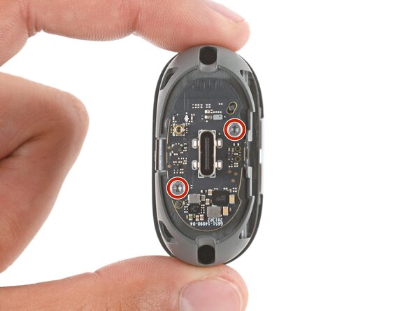

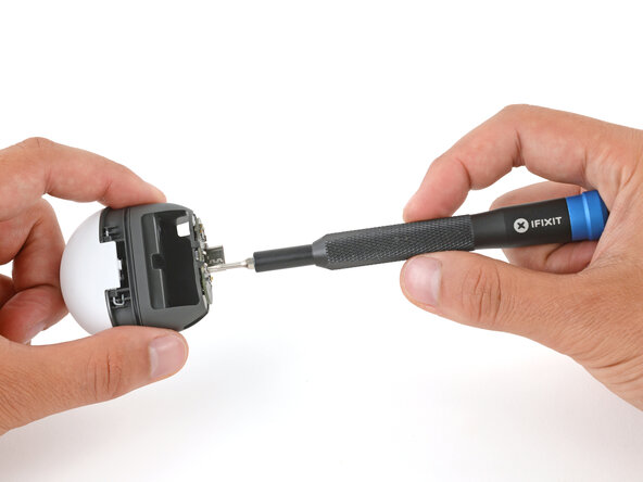

  7. Google Pixel Buds 2a USB‑C Board Replacement, Remove the USB‑C board screws: crwdns2935265:07crwdnd2935265:01crwdnd2935265:03crwdne2935265:0 Google Pixel Buds 2a USB‑C Board Replacement, Remove the USB‑C board screws: crwdns2935265:07crwdnd2935265:02crwdnd2935265:03crwdne2935265:0 Google Pixel Buds 2a USB‑C Board Replacement, Remove the USB‑C board screws: crwdns2935265:07crwdnd2935265:03crwdnd2935265:03crwdne2935265:0
    • Use a Torx Plus 5IP screwdriver to remove the two 3.4 mm‑long screws securing the USB‑C board.

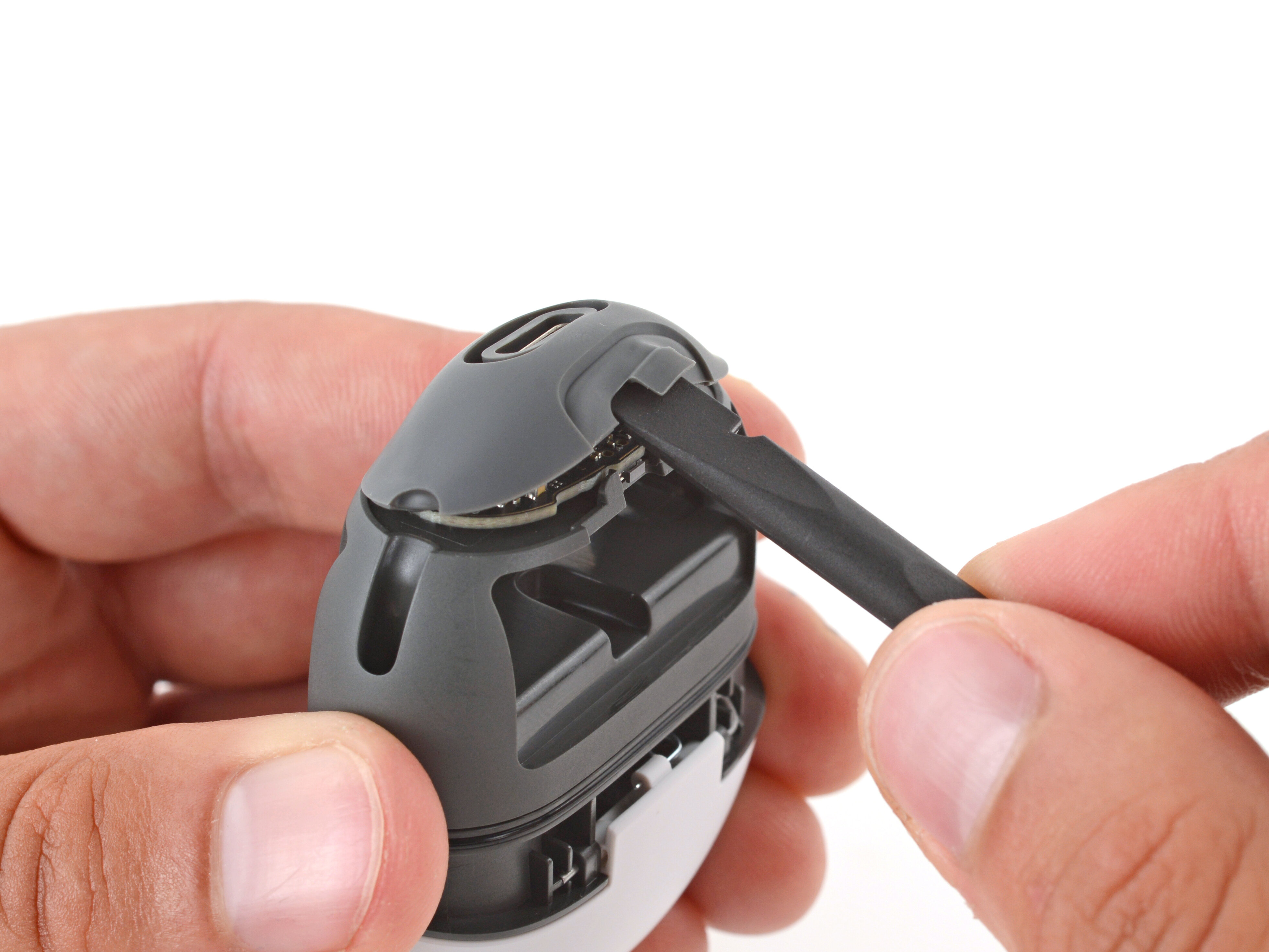

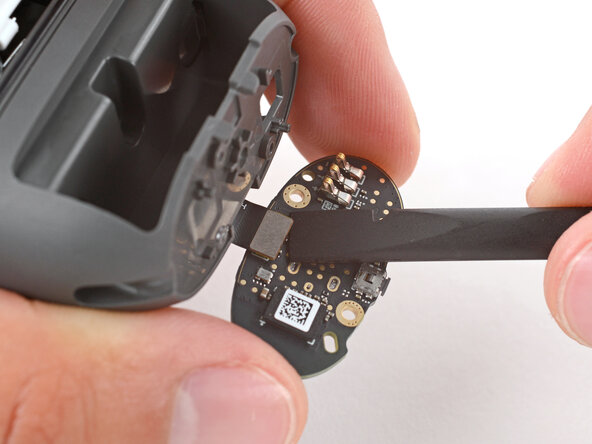

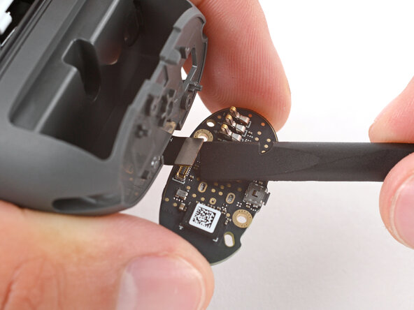

  8. Google Pixel Buds 2a USB‑C Board Replacement, Remove the USB‑C board: crwdns2935265:08crwdnd2935265:01crwdnd2935265:02crwdne2935265:0 Google Pixel Buds 2a USB‑C Board Replacement, Remove the USB‑C board: crwdns2935265:08crwdnd2935265:02crwdnd2935265:02crwdne2935265:0
    • Gently flip the USB‑C board down so you can access its press connector.
    • Insert the flat end of a spudger under the press connector and twist the spudger to disconnect the USB‑C board.
    • Be careful not to damage any of the small, surface‑mounted components on the board.

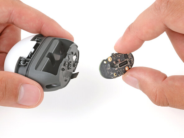

  9. Google Pixel Buds 2a USB‑C Board Replacement, Remove the USB‑C board: crwdns2935265:09crwdnd2935265:01crwdnd2935265:01crwdne2935265:0
    • Remove the USB‑C board.
