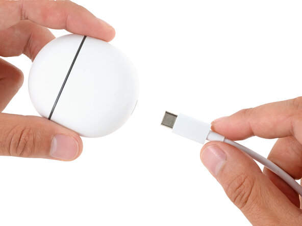

  1. Google Pixel Buds 2a Charging Case Battery Replacement, Unplug the charging case: crwdns2935265:01crwdnd2935265:01crwdnd2935265:01crwdne2935265:0
    • Before starting your repair, unplug your charging case.

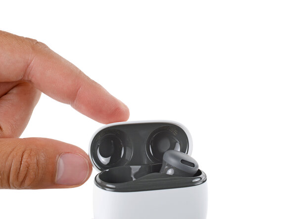

  2. Google Pixel Buds 2a Charging Case Battery Replacement, Remove the Buds: crwdns2935265:02crwdnd2935265:01crwdnd2935265:03crwdne2935265:0 Google Pixel Buds 2a Charging Case Battery Replacement, Remove the Buds: crwdns2935265:02crwdnd2935265:02crwdnd2935265:03crwdne2935265:0 Google Pixel Buds 2a Charging Case Battery Replacement, Remove the Buds: crwdns2935265:02crwdnd2935265:03crwdnd2935265:03crwdne2935265:0
    • Open the case lid, remove the Pixel Buds, and set them aside.

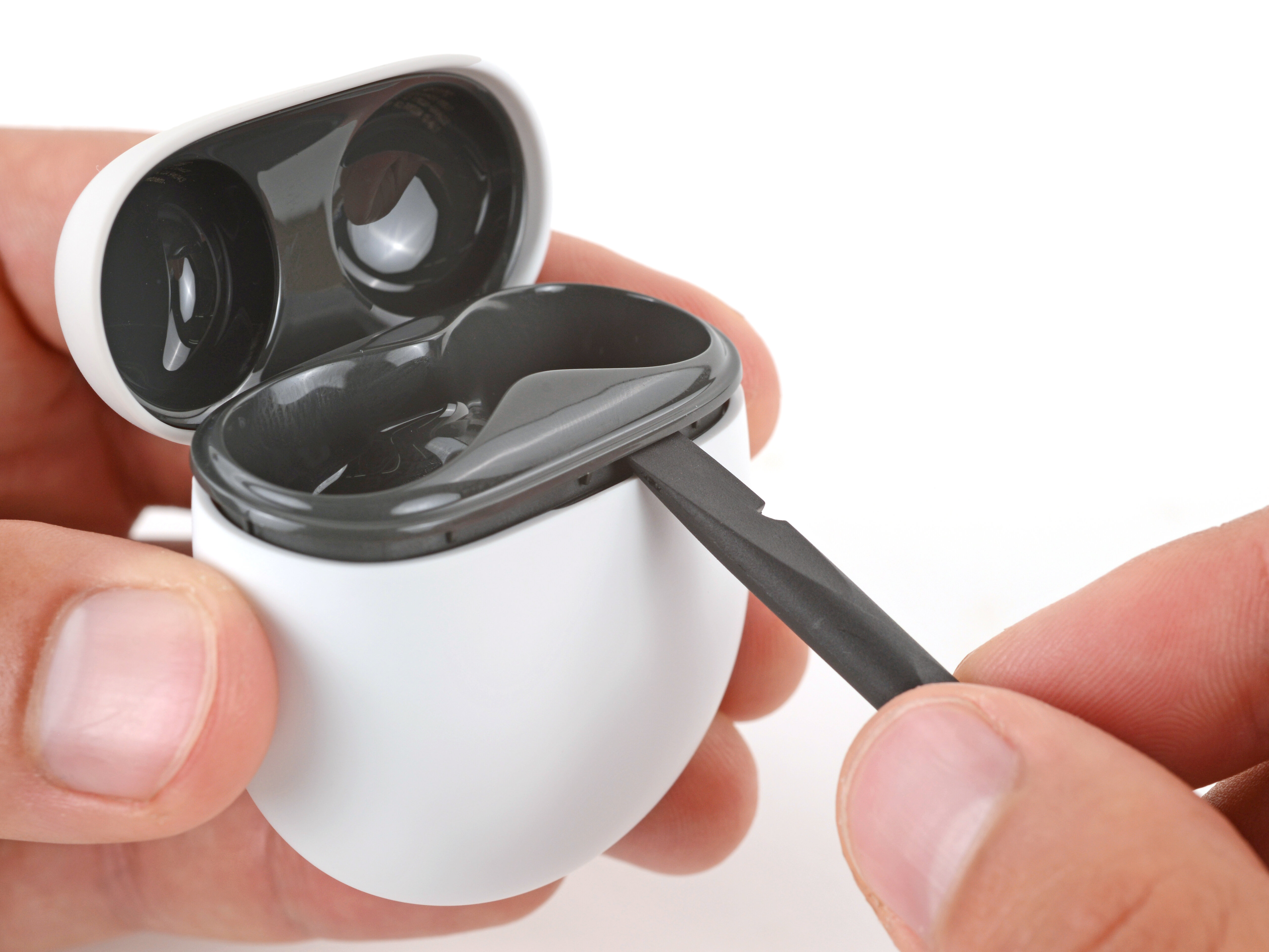

  4. Google Pixel Buds 2a Charging Case Battery Replacement, Remove the bottom shell: crwdns2935265:04crwdnd2935265:01crwdnd2935265:03crwdne2935265:0 Google Pixel Buds 2a Charging Case Battery Replacement, Remove the bottom shell: crwdns2935265:04crwdnd2935265:02crwdnd2935265:03crwdne2935265:0 Google Pixel Buds 2a Charging Case Battery Replacement, Remove the bottom shell: crwdns2935265:04crwdnd2935265:03crwdnd2935265:03crwdne2935265:0
    • Slide the main body of the charging case completely out of the bottom shell, inserting a fingernail in the seam near the top of the case to create an initial gap.
    • If you're having trouble, use the flat end of a spudger to start the initial gap.

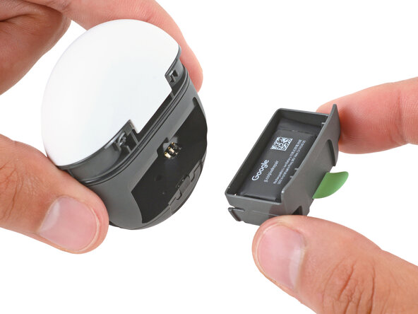

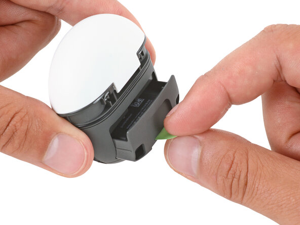

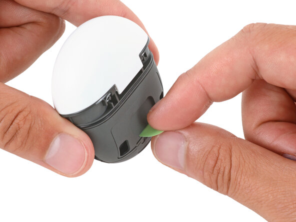

  5. Google Pixel Buds 2a Charging Case Battery Replacement, Remove the battery: crwdns2935265:05crwdnd2935265:01crwdnd2935265:03crwdne2935265:0 Google Pixel Buds 2a Charging Case Battery Replacement, Remove the battery: crwdns2935265:05crwdnd2935265:02crwdnd2935265:03crwdne2935265:0 Google Pixel Buds 2a Charging Case Battery Replacement, Remove the battery: crwdns2935265:05crwdnd2935265:03crwdnd2935265:03crwdne2935265:0
    • Grip the small green tab on the back of the charging case and pull the battery out of its recess.
    • The battery fits snugly in place—this may take a little bit of force.
