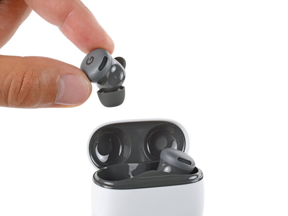

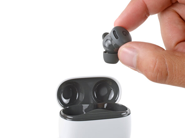

  2. Google Pixel Buds 2a Bottom Shell Replacement, Remove the Buds: crwdns2935265:02crwdnd2935265:01crwdnd2935265:03crwdne2935265:0 Google Pixel Buds 2a Bottom Shell Replacement, Remove the Buds: crwdns2935265:02crwdnd2935265:02crwdnd2935265:03crwdne2935265:0 Google Pixel Buds 2a Bottom Shell Replacement, Remove the Buds: crwdns2935265:02crwdnd2935265:03crwdnd2935265:03crwdne2935265:0
    • Open the case lid, remove the Pixel Buds, and set them aside.

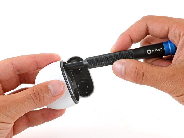

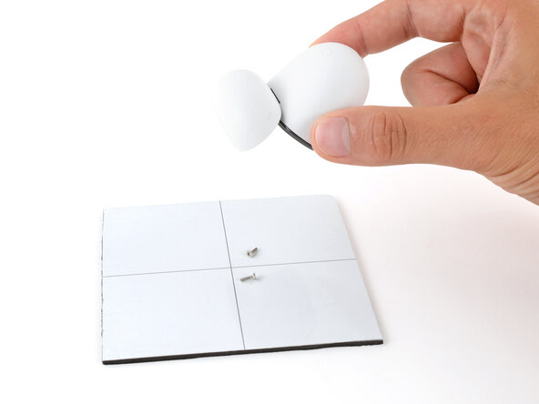

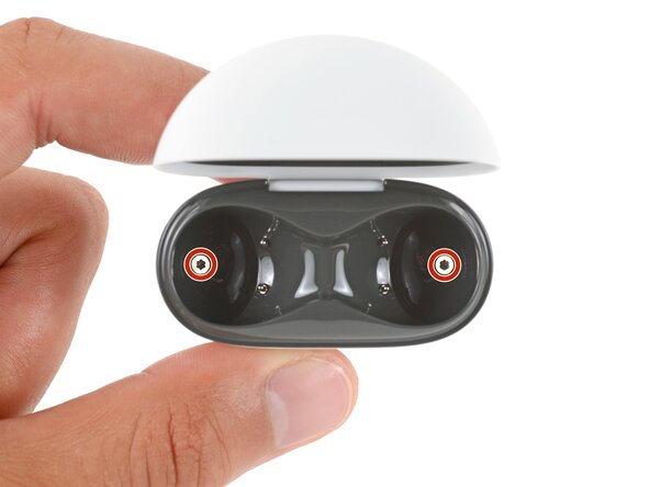

  3. Google Pixel Buds 2a Bottom Shell Replacement, Remove the case screws: crwdns2935265:03crwdnd2935265:01crwdnd2935265:03crwdne2935265:0 Google Pixel Buds 2a Bottom Shell Replacement, Remove the case screws: crwdns2935265:03crwdnd2935265:02crwdnd2935265:03crwdne2935265:0 Google Pixel Buds 2a Bottom Shell Replacement, Remove the case screws: crwdns2935265:03crwdnd2935265:03crwdnd2935265:03crwdne2935265:0
    • Use a T5 Torx screwdriver to remove the two 6.2 mm‑long screws from the ear bud recesses.
    • You may need to flip the case over and gently shake it to get the screws to fall out.

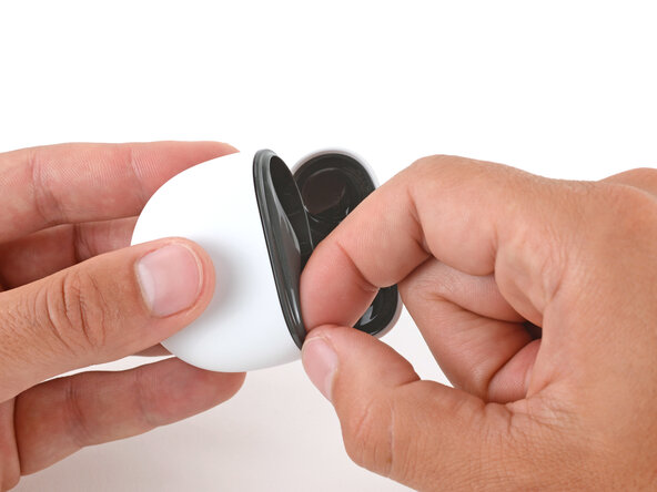

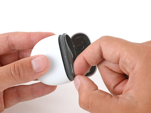

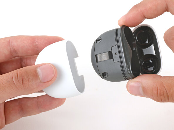

  4. Google Pixel Buds 2a Bottom Shell Replacement, Remove the bottom shell: crwdns2935265:04crwdnd2935265:01crwdnd2935265:03crwdne2935265:0 Google Pixel Buds 2a Bottom Shell Replacement, Remove the bottom shell: crwdns2935265:04crwdnd2935265:02crwdnd2935265:03crwdne2935265:0 Google Pixel Buds 2a Bottom Shell Replacement, Remove the bottom shell: crwdns2935265:04crwdnd2935265:03crwdnd2935265:03crwdne2935265:0
    • Slide the main body of the charging case completely out of the bottom shell, inserting a fingernail in the seam near the top of the case to create an initial gap.
    • If you're having trouble, use the flat end of a spudger to start the initial gap.
