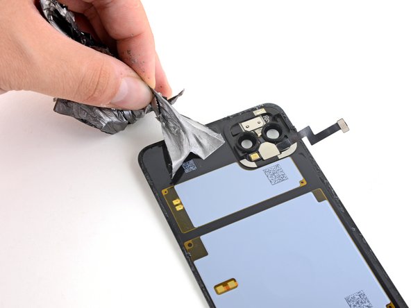

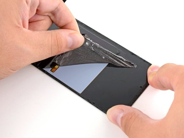

  22. Google Pixel 4 XL Wireless Charging Coil Replacement, Peel off the graphite adhesive layer: crwdns2935265:022crwdnd2935265:01crwdnd2935265:01crwdne2935265:0
    • The wireless charging coil adhered to the back panel is covered by a graphite adhesive layer which will need to be removed.
    • Use tweezers on one of the bottom corners to pull up the adhesive enough to grab it with your fingers.
  23. Google Pixel 4 XL Wireless Charging Coil Replacement: crwdns2935265:023crwdnd2935265:01crwdnd2935265:03crwdne2935265:0 Google Pixel 4 XL Wireless Charging Coil Replacement: crwdns2935265:023crwdnd2935265:02crwdnd2935265:03crwdne2935265:0 Google Pixel 4 XL Wireless Charging Coil Replacement: crwdns2935265:023crwdnd2935265:03crwdnd2935265:03crwdne2935265:0
    • Peel back the graphite adhesive layer to expose the wireless charging coil and NFC pads.
    • Completely remove the graphite adhesive layer.

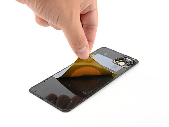

  24. Google Pixel 4 XL Wireless Charging Coil Replacement, Remove the wireless charging coil: crwdns2935265:024crwdnd2935265:01crwdnd2935265:03crwdne2935265:0 Google Pixel 4 XL Wireless Charging Coil Replacement, Remove the wireless charging coil: crwdns2935265:024crwdnd2935265:02crwdnd2935265:03crwdne2935265:0 Google Pixel 4 XL Wireless Charging Coil Replacement, Remove the wireless charging coil: crwdns2935265:024crwdnd2935265:03crwdnd2935265:03crwdne2935265:0
    • Use tweezers on one of the bottom corners of the wireless charging coil pad to pull up the adhesive backing enough so you can grab it with your fingers.
    • Peel off and remove the wireless charging coil.
    • When installing a new wireless charging coil pad, align the contacts with the residue outline left by the old adhesive.
