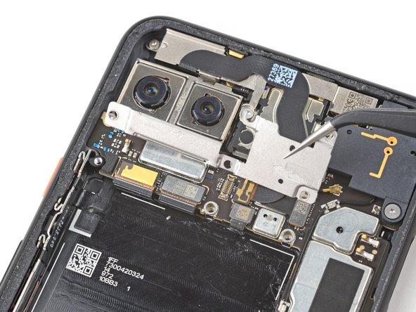

  26. Google Pixel 4 XL Screen Replacement, Remove the rear-facing camera cover: crwdns2935265:026crwdnd2935265:01crwdnd2935265:01crwdne2935265:0
    • Use your T3 Torx screwdriver to remove the following screws securing the rear-facing camera connector cover:
    • One 2.7 mm screw
    • One 4.1 mm screw
    • One 4.2 mm screw
  27. Google Pixel 4 XL Screen Replacement: crwdns2935265:027crwdnd2935265:01crwdnd2935265:02crwdne2935265:0 Google Pixel 4 XL Screen Replacement: crwdns2935265:027crwdnd2935265:02crwdnd2935265:02crwdne2935265:0

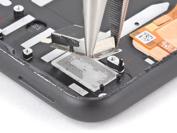

    • Use a pair of tweezers to remove the rear-facing camera connector cover.
  28. Google Pixel 4 XL Screen Replacement: crwdns2935265:028crwdnd2935265:01crwdnd2935265:01crwdne2935265:0

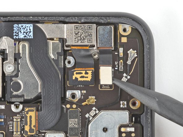

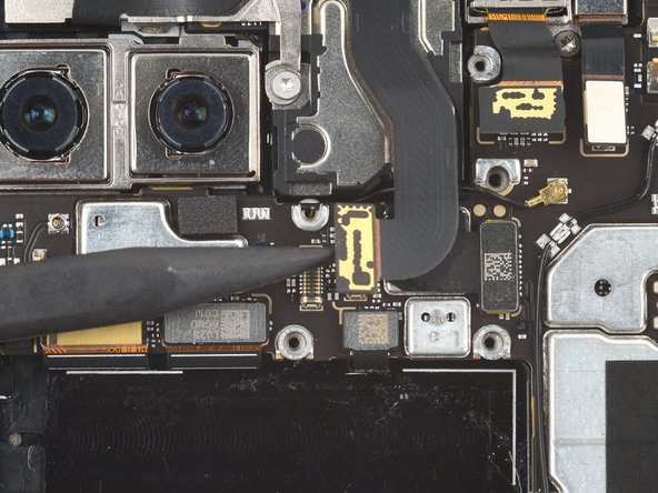

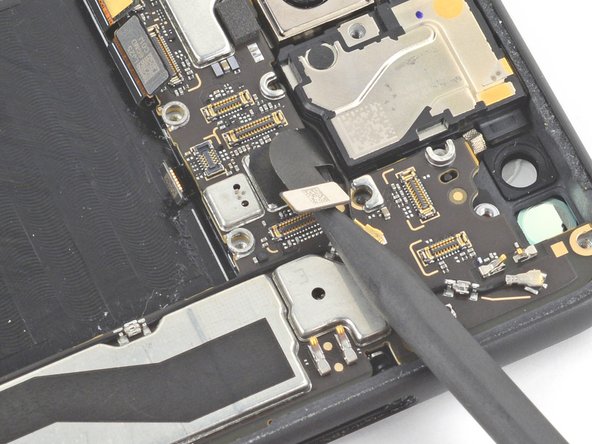

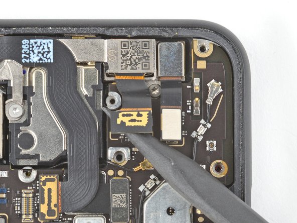

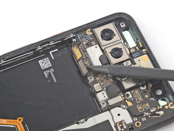

  30. Google Pixel 4 XL Screen Replacement, Disconnect the camera and sensor connectors: crwdns2935265:030crwdnd2935265:01crwdnd2935265:03crwdne2935265:0 Google Pixel 4 XL Screen Replacement, Disconnect the camera and sensor connectors: crwdns2935265:030crwdnd2935265:02crwdnd2935265:03crwdne2935265:0 Google Pixel 4 XL Screen Replacement, Disconnect the camera and sensor connectors: crwdns2935265:030crwdnd2935265:03crwdnd2935265:03crwdne2935265:0

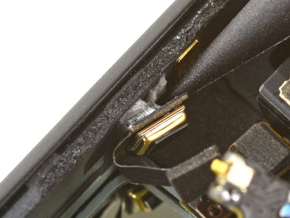

    • Use the pointed end of your spudger to pry the camera and sensor connectors straight up from the motherboard to disconnect them.

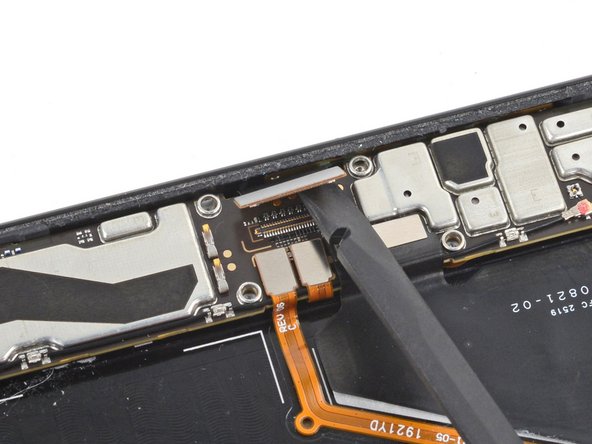

  31. Google Pixel 4 XL Screen Replacement: crwdns2935265:031crwdnd2935265:01crwdnd2935265:02crwdne2935265:0 Google Pixel 4 XL Screen Replacement: crwdns2935265:031crwdnd2935265:02crwdnd2935265:02crwdne2935265:0
    • Use the pointed end of your spudger to pry up and disconnect the remaining sensor connector from the motherboard.
    • This cable is secured to the phone with some light adhesive.

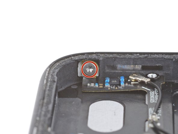

  32. Google Pixel 4 XL Screen Replacement, Remove the front camera and sensor assembly: crwdns2935265:032crwdnd2935265:01crwdnd2935265:01crwdne2935265:0
    • Use your T3 Torx screwdriver to remove the following screws from the front camera and sensor assembly:
    • Two 2.7 mm screws
    • One 3.1 mm screw

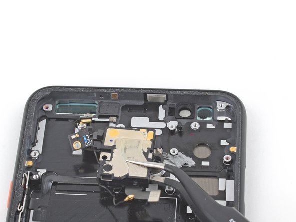

  33. Google Pixel 4 XL Screen Replacement: crwdns2935265:033crwdnd2935265:01crwdnd2935265:03crwdne2935265:0 Google Pixel 4 XL Screen Replacement: crwdns2935265:033crwdnd2935265:02crwdnd2935265:03crwdne2935265:0 Google Pixel 4 XL Screen Replacement: crwdns2935265:033crwdnd2935265:03crwdnd2935265:03crwdne2935265:0
    • Use a pair of tweezers to remove the front camera and sensor assembly.

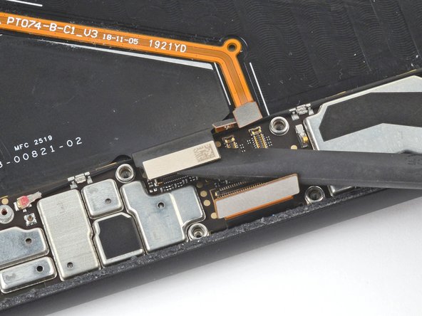

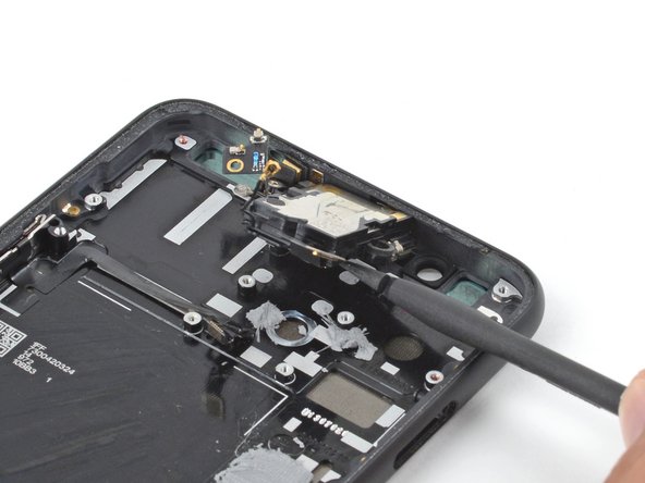

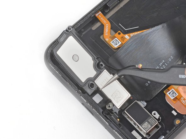

  34. Google Pixel 4 XL Screen Replacement, Remove the screws securing the display connector cover: crwdns2935265:034crwdnd2935265:01crwdnd2935265:01crwdne2935265:0
    • Use your T3 Torx driver to remove the four 3.5 mm screws securing the display connector cover.
  35. Google Pixel 4 XL Screen Replacement, Remove the display connector cover: crwdns2935265:035crwdnd2935265:01crwdnd2935265:02crwdne2935265:0 Google Pixel 4 XL Screen Replacement, Remove the display connector cover: crwdns2935265:035crwdnd2935265:02crwdnd2935265:02crwdne2935265:0
    • Use a pair of tweezers to remove the display connector cover.

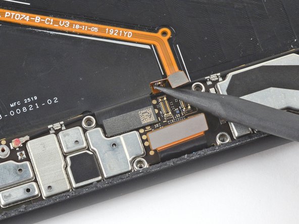

  36. Google Pixel 4 XL Screen Replacement, Disconnect the display connector: crwdns2935265:036crwdnd2935265:01crwdnd2935265:02crwdne2935265:0 Google Pixel 4 XL Screen Replacement, Disconnect the display connector: crwdns2935265:036crwdnd2935265:02crwdnd2935265:02crwdne2935265:0
    • Use the flat end of a spudger to disconnect the display connector from the motherboard.

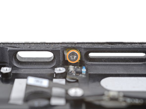

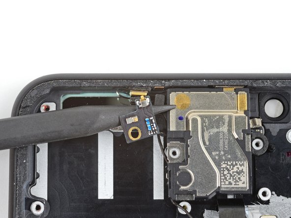

  37. Google Pixel 4 XL Screen Replacement, Remove the motherboard screw: crwdns2935265:037crwdnd2935265:01crwdnd2935265:01crwdne2935265:0
    • Use your T3 Torx driver to remove the 2.7 mm screw securing the motherboard to the frame.

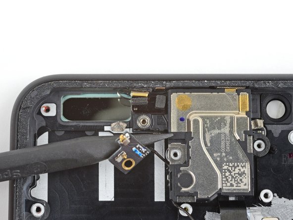

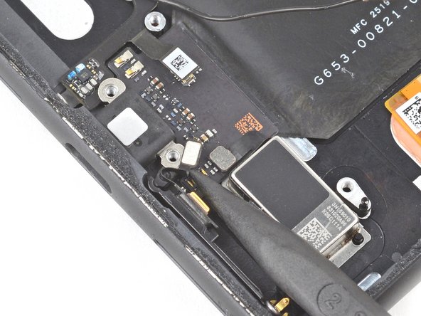

  38. Google Pixel 4 XL Screen Replacement, Disconnect the motherboard press connectors: crwdns2935265:038crwdnd2935265:01crwdnd2935265:03crwdne2935265:0 Google Pixel 4 XL Screen Replacement, Disconnect the motherboard press connectors: crwdns2935265:038crwdnd2935265:02crwdnd2935265:03crwdne2935265:0 Google Pixel 4 XL Screen Replacement, Disconnect the motherboard press connectors: crwdns2935265:038crwdnd2935265:03crwdnd2935265:03crwdne2935265:0
    • Use the pointed end of your spudger to disconnect the three side button and rear-facing camera connectors from the motherboard.

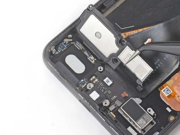

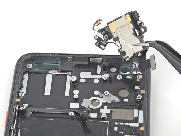

  39. Google Pixel 4 XL Screen Replacement: crwdns2935265:039crwdnd2935265:01crwdnd2935265:02crwdne2935265:0 Google Pixel 4 XL Screen Replacement: crwdns2935265:039crwdnd2935265:02crwdnd2935265:02crwdne2935265:0
    • Use the pointed end of your spudger to disconnect the earpiece speaker from the motherboard.

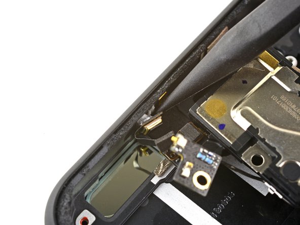

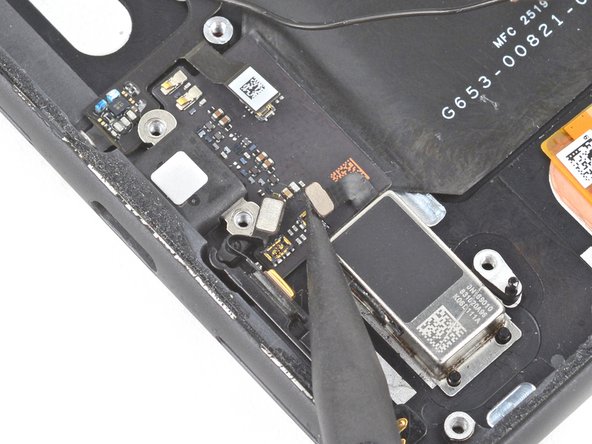

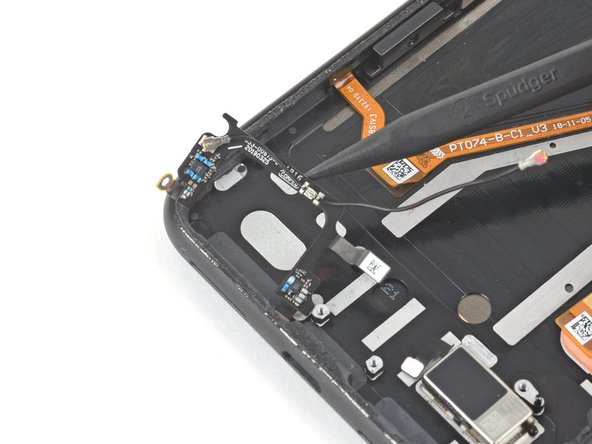

  40. Google Pixel 4 XL Screen Replacement: crwdns2935265:040crwdnd2935265:01crwdnd2935265:03crwdne2935265:0 Google Pixel 4 XL Screen Replacement: crwdns2935265:040crwdnd2935265:02crwdnd2935265:03crwdne2935265:0 Google Pixel 4 XL Screen Replacement: crwdns2935265:040crwdnd2935265:03crwdnd2935265:03crwdne2935265:0

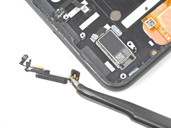

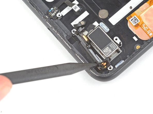

    • Use the pointed end of your spudger to disconnect the two grip sensor connectors from the motherboard.
    • Use the flat end of your spudger to disconnect the charge port connector from the motherboard.

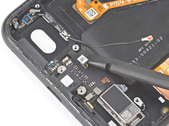

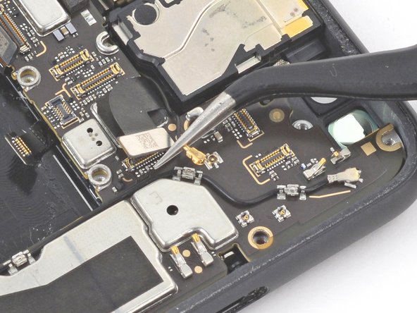

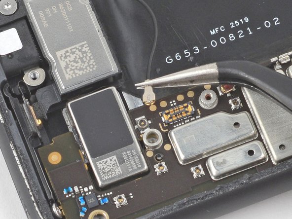

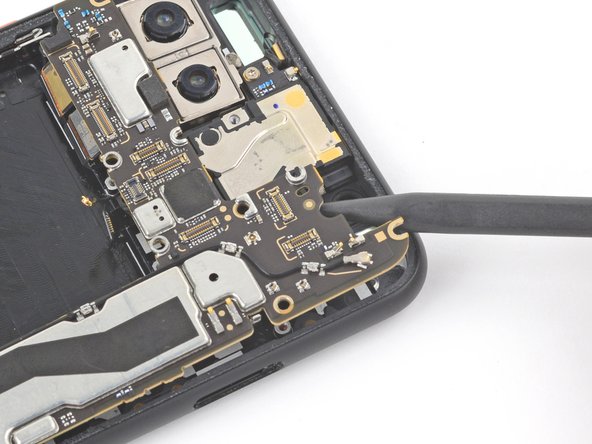

  41. Google Pixel 4 XL Screen Replacement, Disconnect the antennas: crwdns2935265:041crwdnd2935265:01crwdnd2935265:03crwdne2935265:0 Google Pixel 4 XL Screen Replacement, Disconnect the antennas: crwdns2935265:041crwdnd2935265:02crwdnd2935265:03crwdne2935265:0 Google Pixel 4 XL Screen Replacement, Disconnect the antennas: crwdns2935265:041crwdnd2935265:03crwdnd2935265:03crwdne2935265:0
    • Use a pair of tweezers to disconnect the two coaxial antenna connectors from the motherboard.

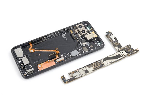

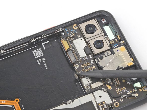

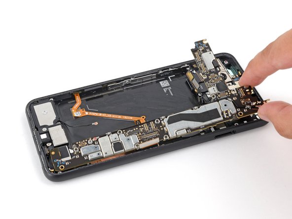

  42. Google Pixel 4 XL Screen Replacement, Remove the motherboard: crwdns2935265:042crwdnd2935265:01crwdnd2935265:02crwdne2935265:0 Google Pixel 4 XL Screen Replacement, Remove the motherboard: crwdns2935265:042crwdnd2935265:02crwdnd2935265:02crwdne2935265:0
    • Use your spudger to pry up and loosen the top edge of the motherboard.
  43. Google Pixel 4 XL Screen Replacement: crwdns2935265:043crwdnd2935265:01crwdnd2935265:03crwdne2935265:0 Google Pixel 4 XL Screen Replacement: crwdns2935265:043crwdnd2935265:02crwdnd2935265:03crwdne2935265:0 Google Pixel 4 XL Screen Replacement: crwdns2935265:043crwdnd2935265:03crwdnd2935265:03crwdne2935265:0
    • Slowly lift out the motherboard, being careful not to snag any ribbon cable connectors.
    • The rear-facing camera module connectors loop around the motherboard, and the camera module is not secured to the phone, so it may lift out with the motherboard during this step.
    • Completely remove the motherboard.
    • When reinstalling the motherboard, check that no ribbon cable connectors are caught underneath.
  44. Google Pixel 4 XL Screen Replacement, Remove the rear cameras: crwdns2935265:044crwdnd2935265:01crwdnd2935265:02crwdne2935265:0 Google Pixel 4 XL Screen Replacement, Remove the rear cameras: crwdns2935265:044crwdnd2935265:02crwdnd2935265:02crwdne2935265:0
    • Use a pair of tweezers to remove the rear-facing camera module.
  45. Google Pixel 4 XL Screen Replacement, Remove the earpiece module: crwdns2935265:045crwdnd2935265:01crwdnd2935265:01crwdne2935265:0
    • Use a T3 Torx driver to remove the 2 mm screw securing the antenna connector board board to the phone.
  46. Google Pixel 4 XL Screen Replacement: crwdns2935265:046crwdnd2935265:01crwdnd2935265:03crwdne2935265:0 Google Pixel 4 XL Screen Replacement: crwdns2935265:046crwdnd2935265:02crwdnd2935265:03crwdne2935265:0 Google Pixel 4 XL Screen Replacement: crwdns2935265:046crwdnd2935265:03crwdnd2935265:03crwdne2935265:0
    • Using the pointed end of a spudger, slide the board slightly to the side, away from the top of the phone.
    • Do not attempt to entirely remove this board; it's still connected to the earpiece speaker.
  47. Google Pixel 4 XL Screen Replacement: crwdns2935265:047crwdnd2935265:01crwdnd2935265:03crwdne2935265:0 Google Pixel 4 XL Screen Replacement: crwdns2935265:047crwdnd2935265:02crwdnd2935265:03crwdne2935265:0 Google Pixel 4 XL Screen Replacement: crwdns2935265:047crwdnd2935265:03crwdnd2935265:03crwdne2935265:0
    • Use the pointed end of your spudger to peel the microphone away from the light adhesive securing it to the phone.
    • Ensure the microphone is completely detached from the top frame before continuing to the next step.
  48. Google Pixel 4 XL Screen Replacement: crwdns2935265:048crwdnd2935265:01crwdnd2935265:02crwdne2935265:0 Google Pixel 4 XL Screen Replacement: crwdns2935265:048crwdnd2935265:02crwdnd2935265:02crwdne2935265:0
    • Use the flat end of your spudger to pry the earpiece module away from the phone's midframe.
    • The earpiece module is attached with some light adhesive, and should come up without too much force.
  49. Google Pixel 4 XL Screen Replacement: crwdns2935265:049crwdnd2935265:01crwdnd2935265:03crwdne2935265:0 Google Pixel 4 XL Screen Replacement: crwdns2935265:049crwdnd2935265:02crwdnd2935265:03crwdne2935265:0 Google Pixel 4 XL Screen Replacement: crwdns2935265:049crwdnd2935265:03crwdnd2935265:03crwdne2935265:0
    • Use a pair of tweezers or your fingers to pull the earpiece module away from the light adhesive holding it to the phone's top frame.
    • Remove the earpiece module.
  50. Google Pixel 4 XL Screen Replacement: crwdns2935265:050crwdnd2935265:01crwdnd2935265:02crwdne2935265:0 Google Pixel 4 XL Screen Replacement: crwdns2935265:050crwdnd2935265:02crwdnd2935265:02crwdne2935265:0
    • Use a pair of tweezers to remove the earpiece speaker and Soli motion sensor assembly.
  51. Google Pixel 4 XL Screen Replacement, Remove the loudspeaker: crwdns2935265:051crwdnd2935265:01crwdnd2935265:01crwdne2935265:0
    • Use your T3 Torx screwdriver to remove the three screws securing the loudspeaker:
    • One 4.1 mm screw
    • One 2.7 mm screw
    • One 4.4 mm shouldered screw
  52. Google Pixel 4 XL Screen Replacement: crwdns2935265:052crwdnd2935265:01crwdnd2935265:03crwdne2935265:0 Google Pixel 4 XL Screen Replacement: crwdns2935265:052crwdnd2935265:02crwdnd2935265:03crwdne2935265:0 Google Pixel 4 XL Screen Replacement: crwdns2935265:052crwdnd2935265:03crwdnd2935265:03crwdne2935265:0
    • Use a pair of tweezers to lift the loudspeaker up and away from the frame.
    • Remove the loudspeaker.
  53. Google Pixel 4 XL Screen Replacement, Isolate the charging assembly: crwdns2935265:053crwdnd2935265:01crwdnd2935265:02crwdne2935265:0 Google Pixel 4 XL Screen Replacement, Isolate the charging assembly: crwdns2935265:053crwdnd2935265:02crwdnd2935265:02crwdne2935265:0
    • Use the pointed end of your spudger to disconnect the two antenna press connectors from the charging assembly.
  54. Google Pixel 4 XL Screen Replacement: crwdns2935265:054crwdnd2935265:01crwdnd2935265:03crwdne2935265:0 Google Pixel 4 XL Screen Replacement: crwdns2935265:054crwdnd2935265:02crwdnd2935265:03crwdne2935265:0 Google Pixel 4 XL Screen Replacement: crwdns2935265:054crwdnd2935265:03crwdnd2935265:03crwdne2935265:0
    • Disconnect the antenna press connectors from the charging assembly.

  59. Google Pixel 4 XL Screen Replacement, Remove the antenna: crwdns2935265:059crwdnd2935265:01crwdnd2935265:02crwdne2935265:0 Google Pixel 4 XL Screen Replacement, Remove the antenna: crwdns2935265:059crwdnd2935265:02crwdnd2935265:02crwdne2935265:0
    • Insert the pointed end of a spudger underneath the antenna's ribbon cable and gently pry up to peel the cable from the frame.
    • The antenna's ribbon cable is secured to the frame with some light adhesive.
    • Remove the antenna.
