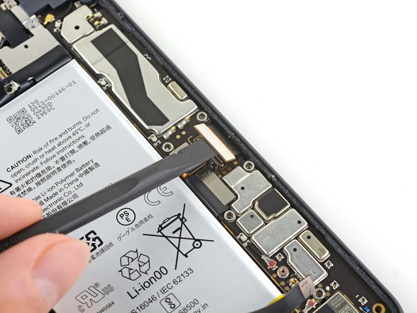

    • Whenever you use the spudger near the battery, be very careful not to puncture the battery.
    • Using the pointed end of a spudger, pry the battery connector straight up from the motherboard to disconnect the battery.
    • To re-attach press connectors like this one, carefully align and press down on one side until it clicks into place, then repeat on the other side. Do not press down on the middle. If the connector is misaligned, the pins can bend, causing permanent damage.
  17. Google Pixel 4 XL Display Assembly Replacement: crwdns2935265:017crwdnd2935265:01crwdnd2935265:02crwdne2935265:0 Google Pixel 4 XL Display Assembly Replacement: crwdns2935265:017crwdnd2935265:02crwdnd2935265:02crwdne2935265:0
    • Using the flat end of a spudger, gently fold the battery cable over so it doesn't accidentally make contact during the rest of your repairs.

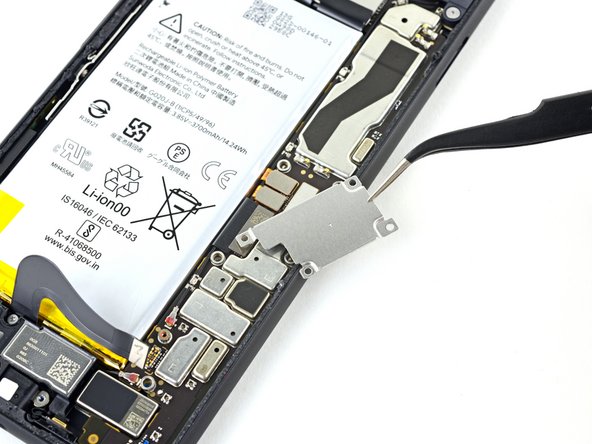

  31. Google Pixel 4 XL Display Assembly Replacement, Disconnect the display assembly: crwdns2935265:031crwdnd2935265:01crwdnd2935265:01crwdne2935265:0
    • Use a T3 Torx driver to remove the four 3.5 mm screws securing the display connector cover.
  32. Google Pixel 4 XL Display Assembly Replacement: crwdns2935265:032crwdnd2935265:01crwdnd2935265:02crwdne2935265:0 Google Pixel 4 XL Display Assembly Replacement: crwdns2935265:032crwdnd2935265:02crwdnd2935265:02crwdne2935265:0
    • Use a pair of tweezers to remove the display connector cover.

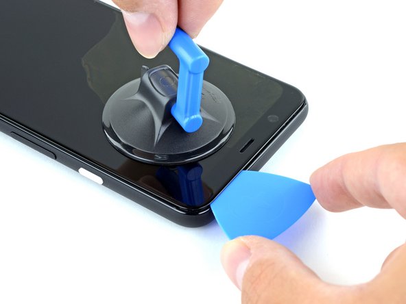

  34. Google Pixel 4 XL Display Assembly Replacement, Slice the display adhesive: crwdns2935265:034crwdnd2935265:01crwdnd2935265:01crwdne2935265:0
    • Prepare an iOpener and apply it to the right edge of the display near the power button for one minute.
  35. Google Pixel 4 XL Display Assembly Replacement: crwdns2935265:035crwdnd2935265:01crwdnd2935265:03crwdne2935265:0 Google Pixel 4 XL Display Assembly Replacement: crwdns2935265:035crwdnd2935265:02crwdnd2935265:03crwdne2935265:0 Google Pixel 4 XL Display Assembly Replacement: crwdns2935265:035crwdnd2935265:03crwdnd2935265:03crwdne2935265:0
    • This process will almost always destroy the OLED display panel. Only proceed if you are replacing an already-broken display assembly.
    • Apply a suction cup to the heated edge of the display assembly.
    • If your display is badly cracked, covering it with a layer of clear packing tape may allow the suction cup to adhere. Alternatively, very strong tape may be used instead of the suction cup. If all else fails, you can superglue the suction cup to the broken display assembly.
    • Pull up on the suction cup with strong, steady force to create a gap between the display assembly and the frame.
    • Depending on the age of your phone, this may be difficult. If you are having trouble, apply heat to the edge and try again.
    • Insert the point of an opening pick into the gap.
    • Depending on the age of your phone, this may take significant force. If you are having trouble, apply more heat and try again.
