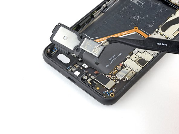

  26. Google Pixel 4 XL Charging Assembly Replacement, Remove the loudspeaker: crwdns2935265:026crwdnd2935265:01crwdnd2935265:01crwdne2935265:0
    • Remove the three T3 Torx screws securing the loudspeaker:
    • One 4.1 mm screw
    • One 2.7 mm screw
    • One 4.4 mm shouldered screw
  27. Google Pixel 4 XL Charging Assembly Replacement: crwdns2935265:027crwdnd2935265:01crwdnd2935265:02crwdne2935265:0 Google Pixel 4 XL Charging Assembly Replacement: crwdns2935265:027crwdnd2935265:02crwdnd2935265:02crwdne2935265:0
    Tesa 61395 Tape
    $5.99
    • Use a pair of tweezers to remove the loudspeaker.
    • Before you install a replacement loudspeaker, check the adhesive gasket:
    • If it is in good condition, you can re-use the gasket. Make sure that the gasket does not cover the exit hole.
    • If the gasket is pulled out of place, remove it and replace the adhesive with a pre-cut strip or Tesa tape.

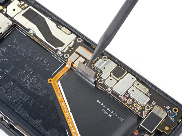

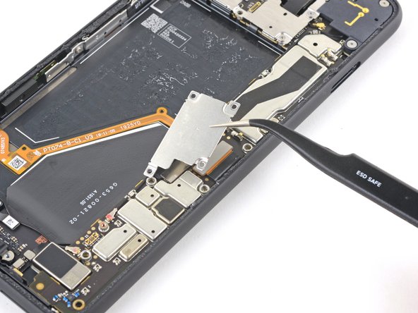

  28. Google Pixel 4 XL Charging Assembly Replacement, Disconnect the charging cable connector: crwdns2935265:028crwdnd2935265:01crwdnd2935265:01crwdne2935265:0
    • Use a T3 Torx driver to remove the four 3.5 mm screws securing the display connector cover.
  29. Google Pixel 4 XL Charging Assembly Replacement: crwdns2935265:029crwdnd2935265:01crwdnd2935265:02crwdne2935265:0 Google Pixel 4 XL Charging Assembly Replacement: crwdns2935265:029crwdnd2935265:02crwdnd2935265:02crwdne2935265:0
    • Use a pair of tweezer to remove the display connector cover.
  30. Google Pixel 4 XL Charging Assembly Replacement: crwdns2935265:030crwdnd2935265:01crwdnd2935265:02crwdne2935265:0 Google Pixel 4 XL Charging Assembly Replacement: crwdns2935265:030crwdnd2935265:02crwdnd2935265:02crwdne2935265:0
    • Using the pointed end of a spudger, disconnect the charging cable connector by prying it straight up from the motherboard.

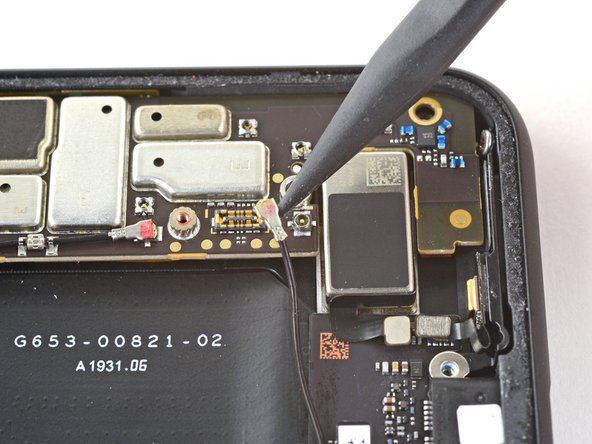

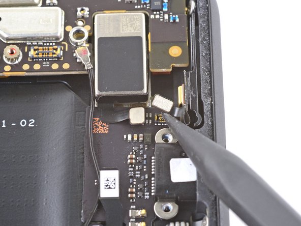

  31. Google Pixel 4 XL Charging Assembly Replacement, Isolate the charging assembly: crwdns2935265:031crwdnd2935265:01crwdnd2935265:02crwdne2935265:0 Google Pixel 4 XL Charging Assembly Replacement, Isolate the charging assembly: crwdns2935265:031crwdnd2935265:02crwdnd2935265:02crwdne2935265:0
    • Disconnect the antenna press connector from the charging assembly.
  32. Google Pixel 4 XL Charging Assembly Replacement: crwdns2935265:032crwdnd2935265:01crwdnd2935265:02crwdne2935265:0 Google Pixel 4 XL Charging Assembly Replacement: crwdns2935265:032crwdnd2935265:02crwdnd2935265:02crwdne2935265:0
    • Disconnect the vibration and bottom microphone connectors from the charging assembly.
  33. Google Pixel 4 XL Charging Assembly Replacement: crwdns2935265:033crwdnd2935265:01crwdnd2935265:02crwdne2935265:0 Google Pixel 4 XL Charging Assembly Replacement: crwdns2935265:033crwdnd2935265:02crwdnd2935265:02crwdne2935265:0
    • Use the pointed end of a spudger to pry up and disconnect the black antenna cable from its socket on the motherboard.

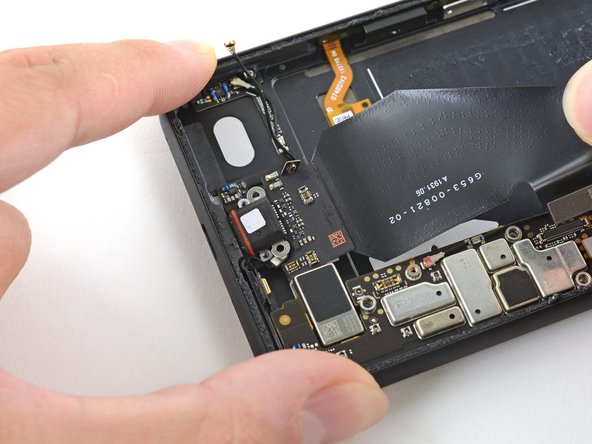

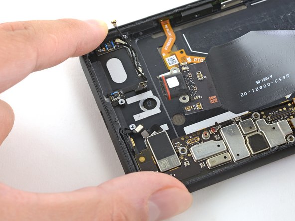

  34. Google Pixel 4 XL Charging Assembly Replacement, Remove the charging assembly: crwdns2935265:034crwdnd2935265:01crwdnd2935265:02crwdne2935265:0 Google Pixel 4 XL Charging Assembly Replacement, Remove the charging assembly: crwdns2935265:034crwdnd2935265:02crwdnd2935265:02crwdne2935265:0
    • Peel back the ribbon cable that's secured to the phone's frame. It's secured with some light adhesive.
  35. Google Pixel 4 XL Charging Assembly Replacement: crwdns2935265:035crwdnd2935265:01crwdnd2935265:03crwdne2935265:0 Google Pixel 4 XL Charging Assembly Replacement: crwdns2935265:035crwdnd2935265:02crwdnd2935265:03crwdne2935265:0 Google Pixel 4 XL Charging Assembly Replacement: crwdns2935265:035crwdnd2935265:03crwdnd2935265:03crwdne2935265:0
    • Remove the charging assembly.
