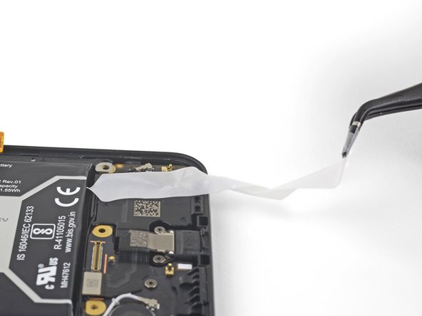

  23. Google Pixel 3a Battery Replacement: crwdns2935265:023crwdnd2935265:01crwdnd2935265:03crwdne2935265:0 Google Pixel 3a Battery Replacement: crwdns2935265:023crwdnd2935265:02crwdnd2935265:03crwdne2935265:0 Google Pixel 3a Battery Replacement: crwdns2935265:023crwdnd2935265:03crwdnd2935265:03crwdne2935265:0
    • The battery is held in place by two stretch-release adhesive strips.
    • Carefully pull the right stretch-release adhesive's pull-tab from the bottom right corner of the battery.
    • Be very careful not to puncture the battery pack with the tweezers.
  24. Google Pixel 3a Battery Replacement: crwdns2935265:024crwdnd2935265:01crwdnd2935265:03crwdne2935265:0 Google Pixel 3a Battery Replacement: crwdns2935265:024crwdnd2935265:02crwdnd2935265:03crwdne2935265:0 Google Pixel 3a Battery Replacement: crwdns2935265:024crwdnd2935265:03crwdnd2935265:03crwdne2935265:0
    • Pull the tab at a shallow angle (close to parallel to the phone) with steady force. As the strip comes out, you can roll it around your tweezers.
    • Keep pulling until the entire strip comes free.
  25. Google Pixel 3a Battery Replacement: crwdns2935265:025crwdnd2935265:01crwdnd2935265:03crwdne2935265:0 Google Pixel 3a Battery Replacement: crwdns2935265:025crwdnd2935265:02crwdnd2935265:03crwdne2935265:0 Google Pixel 3a Battery Replacement: crwdns2935265:025crwdnd2935265:03crwdnd2935265:03crwdne2935265:0
    • Find the second stretch-release adhesive's pull-tab at the upper left corner of the battery.
    • Be careful not to puncture the battery with the tweezers.
    • Grasp the tab carefully with your tweezers.
    • Pull the tab at a shallow angle with steady force, rolling it as it gets longer, until the entire strip comes free.
    • If your adhesive strips did not pull out intact, insert an opening pick under the bottom edge of the battery and pry upwards to loosen the battery.
    • If needed, apply a heated iOpener to the back of the phone for a minute to loosen the battery adhesive.
