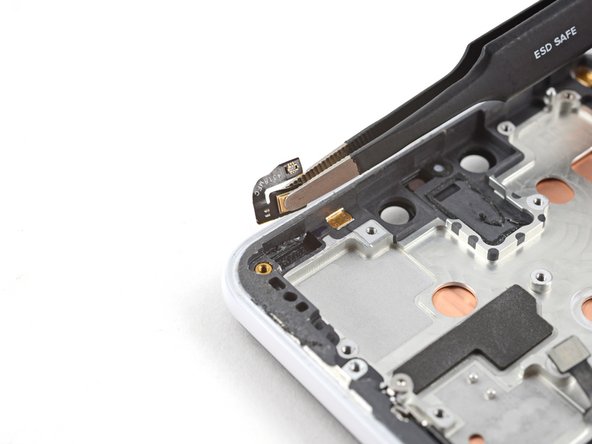

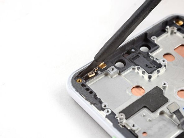

  21. Google Pixel 3 XL Screen Assembly Replacement, Disconnect the front cameras: crwdns2935265:021crwdnd2935265:01crwdnd2935265:03crwdne2935265:0 Google Pixel 3 XL Screen Assembly Replacement, Disconnect the front cameras: crwdns2935265:021crwdnd2935265:02crwdnd2935265:03crwdne2935265:0 Google Pixel 3 XL Screen Assembly Replacement, Disconnect the front cameras: crwdns2935265:021crwdnd2935265:03crwdnd2935265:03crwdne2935265:0
    • Use the point of a spudger to carefully pry up and disconnect the cameras from their motherboard sockets.
    • Be very careful not to dislodge the small surface-mounted components surrounding the sockets.
  22. Google Pixel 3 XL Screen Assembly Replacement, Loosen the front cameras: crwdns2935265:022crwdnd2935265:01crwdnd2935265:03crwdne2935265:0 Google Pixel 3 XL Screen Assembly Replacement, Loosen the front cameras: crwdns2935265:022crwdnd2935265:02crwdnd2935265:03crwdne2935265:0 Google Pixel 3 XL Screen Assembly Replacement, Loosen the front cameras: crwdns2935265:022crwdnd2935265:03crwdnd2935265:03crwdne2935265:0
    • The cameras are lightly adhered in place.
    • Use the flat end of a spudger to pry up and loosen the camera modules from their recess.
  23. Google Pixel 3 XL Screen Assembly Replacement, Remove the front-facing cameras: crwdns2935265:023crwdnd2935265:01crwdnd2935265:01crwdne2935265:0
    • Remove the front-facing cameras.

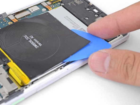

  50. Google Pixel 3 XL Screen Assembly Replacement, Slice under the charging coil: crwdns2935265:050crwdnd2935265:01crwdnd2935265:03crwdne2935265:0 Google Pixel 3 XL Screen Assembly Replacement, Slice under the charging coil: crwdns2935265:050crwdnd2935265:02crwdnd2935265:03crwdne2935265:0 Google Pixel 3 XL Screen Assembly Replacement, Slice under the charging coil: crwdns2935265:050crwdnd2935265:03crwdnd2935265:03crwdne2935265:0
    • Insert the point of an opening pick underneath one edge of the charging coil.
    • Slide the pick along the edge to loosen the adhesive.
    • Slice as deep as you can while taking care not to puncture the battery's surface.

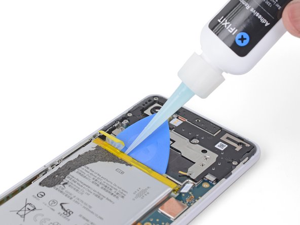

  51. Google Pixel 3 XL Screen Assembly Replacement, Apply adhesive remover under the coil: crwdns2935265:051crwdnd2935265:01crwdnd2935265:02crwdne2935265:0 Google Pixel 3 XL Screen Assembly Replacement, Apply adhesive remover under the coil: crwdns2935265:051crwdnd2935265:02crwdnd2935265:02crwdne2935265:0
    • Tilt the edge you have been slicing upwards.
    • While holding the phone in a tilted position, apply a few drops of adhesive remover or high concentration isopropyl alcohol along the edge.
    • Keep the phone in that position for a minute or two to allow the adhesive to soften.

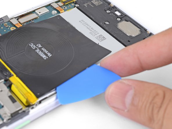

  52. Google Pixel 3 XL Screen Assembly Replacement, Slice through the coil adhesive: crwdns2935265:052crwdnd2935265:01crwdnd2935265:03crwdne2935265:0 Google Pixel 3 XL Screen Assembly Replacement, Slice through the coil adhesive: crwdns2935265:052crwdnd2935265:02crwdnd2935265:03crwdne2935265:0 Google Pixel 3 XL Screen Assembly Replacement, Slice through the coil adhesive: crwdns2935265:052crwdnd2935265:03crwdnd2935265:03crwdne2935265:0
    • Insert the flat end of an opening pick underneath a corner of the charging coil.
    • Push the pick slowly and firmly under the coil to loosen the adhesive.
    • The adhesive is mostly around the perimeter of the wireless coil. Use the opening pick to slowly slice through the adhesive.
    • If the adhesive feels difficult to slice through, tilt the phone up and apply a few more drops of adhesive remover.
  53. Google Pixel 3 XL Screen Assembly Replacement, Remove the charging coil: crwdns2935265:053crwdnd2935265:01crwdnd2935265:01crwdne2935265:0
    • Remove the wireless charging coil.
    • To install a replacement coil:
    • Use isopropyl alcohol and a lint-free cloth to clean off the battery surface of any adhesive residue. Be very careful not to puncture the battery.
    • Connect the wireless coil connector to its motherboard socket. This ensures that the coil is properly aligned.
    • Peel off any adhesive backing on the replacement coil.
    • Lay the coil on top of the battery and firmly press it into position.

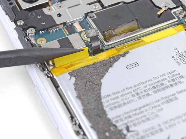

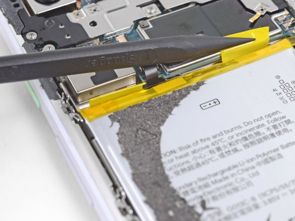

  54. Google Pixel 3 XL Screen Assembly Replacement, Loosen the battery pull tabs: crwdns2935265:054crwdnd2935265:01crwdnd2935265:03crwdne2935265:0 Google Pixel 3 XL Screen Assembly Replacement, Loosen the battery pull tabs: crwdns2935265:054crwdnd2935265:02crwdnd2935265:03crwdne2935265:0 Google Pixel 3 XL Screen Assembly Replacement, Loosen the battery pull tabs: crwdns2935265:054crwdnd2935265:03crwdnd2935265:03crwdne2935265:0
    • Carefully slide the point of a spudger underneath the yellow battery pull tabs folded along the top edge of the battery.
    • Separate the pull tabs from the battery.

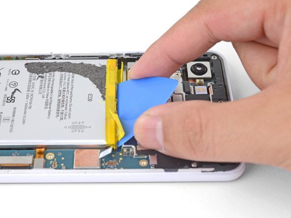

  55. Google Pixel 3 XL Screen Assembly Replacement, Insert a bracing pick: crwdns2935265:055crwdnd2935265:01crwdnd2935265:02crwdne2935265:0 Google Pixel 3 XL Screen Assembly Replacement, Insert a bracing pick: crwdns2935265:055crwdnd2935265:02crwdnd2935265:02crwdne2935265:0
    • There are steep, sharp edges near the top of the battery, that can easily break the adhesive strip as it's being pulled out.
    • Insert the flat end of an opening pick into the gap above the battery, behind a yellow pull tab.
    • Wedge the pick firmly underneath the battery. The pick will serve as a buffer for the adhesive strip as well as a prying point.
  56. Google Pixel 3 XL Screen Assembly Replacement, Remove the battery adhesive strips: crwdns2935265:056crwdnd2935265:01crwdnd2935265:02crwdne2935265:0 Google Pixel 3 XL Screen Assembly Replacement, Remove the battery adhesive strips: crwdns2935265:056crwdnd2935265:02crwdnd2935265:02crwdne2935265:0
    • Pull on the yellow adhesive pull tab with slow steady force. Try your best to pull it as shallow of an angle (vs. straight up) as possible.
    • As you pull on the adhesive tab, maintain pressure on the opening pick to wedge it underneath the battery as much as possible.
    • If the adhesive feels stuck, you can apply a few drops of adhesive remover or high concentration isopropyl alcohol into the gap to help loosen the battery. Doing this will most likely loosen both strips at once.
    • Repeat the process with the second adhesive pull tab.

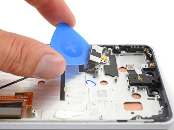

  60. Google Pixel 3 XL Screen Assembly Replacement, Heat the earpiece speaker: crwdns2935265:060crwdnd2935265:01crwdnd2935265:01crwdne2935265:0
    • The earpiece speaker is lightly adhered to the frame.
    • Heat an iOpener and apply it to the top edge of the device for two minutes.
  61. Google Pixel 3 XL Screen Assembly Replacement, Separate the adhesive: crwdns2935265:061crwdnd2935265:01crwdnd2935265:02crwdne2935265:0 Google Pixel 3 XL Screen Assembly Replacement, Separate the adhesive: crwdns2935265:061crwdnd2935265:02crwdnd2935265:02crwdne2935265:0
    • Insert the tip of a spudger between the frame and the long edge of the earpiece speaker.
    • Pry up with the spudger to separate the adhesive.

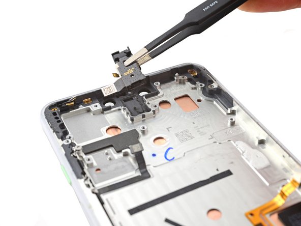

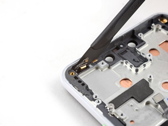

  63. Google Pixel 3 XL Screen Assembly Replacement, Heat the microphone assembly: crwdns2935265:063crwdnd2935265:01crwdnd2935265:01crwdne2935265:0
    • The microphone assembly is lightly adhered to the frame.
    • Heat an iOpener and apply it to the top left of the device for two minutes.
  64. Google Pixel 3 XL Screen Assembly Replacement, Remove the microphone assembly bracket: crwdns2935265:064crwdnd2935265:01crwdnd2935265:02crwdne2935265:0 Google Pixel 3 XL Screen Assembly Replacement, Remove the microphone assembly bracket: crwdns2935265:064crwdnd2935265:02crwdnd2935265:02crwdne2935265:0
    • Use tweezers to remove the rubber bracket between the microphone assembly and its recess in the frame.

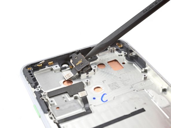

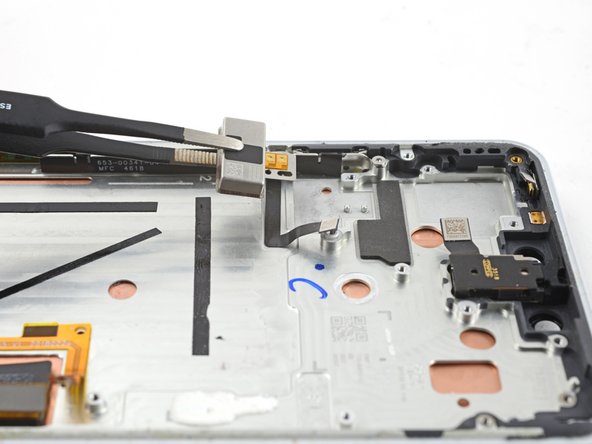

  65. Google Pixel 3 XL Screen Assembly Replacement, Separate the adhesive: crwdns2935265:065crwdnd2935265:01crwdnd2935265:03crwdne2935265:0 Google Pixel 3 XL Screen Assembly Replacement, Separate the adhesive: crwdns2935265:065crwdnd2935265:02crwdnd2935265:03crwdne2935265:0 Google Pixel 3 XL Screen Assembly Replacement, Separate the adhesive: crwdns2935265:065crwdnd2935265:03crwdnd2935265:03crwdne2935265:0
    • Insert a halberd spudger between the microphone assembly and the perimeter of the frame.
    • Slide the halberd spudger downward and pry towards the battery to separate the adhesive.

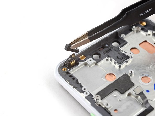

  66. Google Pixel 3 XL Screen Assembly Replacement, Remove the microphone assembly: crwdns2935265:066crwdnd2935265:01crwdnd2935265:02crwdne2935265:0 Google Pixel 3 XL Screen Assembly Replacement, Remove the microphone assembly: crwdns2935265:066crwdnd2935265:02crwdnd2935265:02crwdne2935265:0
    • Use tweezers, or your fingers, to remove the microphone assembly.
