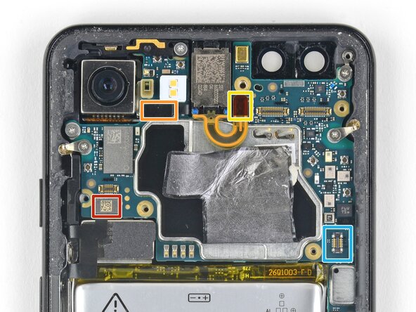

    1. Google Pixel 3 Screen Assembly Replacement, Disconnect the display connector: crwdns2935265:032crwdnd2935265:01crwdnd2935265:02crwdne2935265:0 Google Pixel 3 Screen Assembly Replacement, Disconnect the display connector: crwdns2935265:032crwdnd2935265:02crwdnd2935265:02crwdne2935265:0
      • Use the flat end of a spudger to carefully pry up the black tape holding the display flex cable in place, near the right edge of the phone.
      • Do not use metal tools to pry, or you may damage the flex cable.
      • Use the flat end of a spudger to pry up and disconnect the display connector from the motherboard.

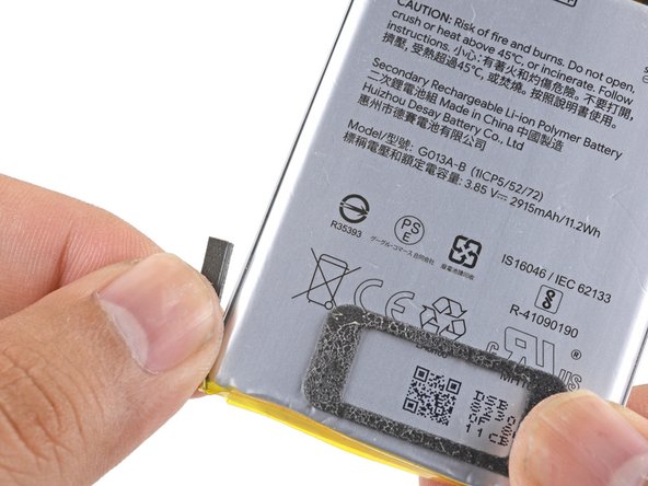

    2. Google Pixel 3 Screen Assembly Replacement, Peel the black tape away from the battery: crwdns2935265:033crwdnd2935265:01crwdnd2935265:03crwdne2935265:0 Google Pixel 3 Screen Assembly Replacement, Peel the black tape away from the battery: crwdns2935265:033crwdnd2935265:02crwdnd2935265:03crwdne2935265:0 Google Pixel 3 Screen Assembly Replacement, Peel the black tape away from the battery: crwdns2935265:033crwdnd2935265:03crwdnd2935265:03crwdne2935265:0
      • Whenever you use the spudger near the battery, be very careful not to puncture the battery.
      • Slide the point of a spudger in the crevice underneath the black tape bridging across the battery and the motherboard.
      • Slide the spudger along the crevice to pry up the tape from the battery side.
      • Carefully peel the tape from the battery and fold it out of the way.
    3. Google Pixel 3 Screen Assembly Replacement, Disconnect the press connectors: crwdns2935265:034crwdnd2935265:01crwdnd2935265:02crwdne2935265:0 Google Pixel 3 Screen Assembly Replacement, Disconnect the press connectors: crwdns2935265:034crwdnd2935265:02crwdnd2935265:02crwdne2935265:0
      • Use a spudger to pry up and disconnect the following seven press-fit connectors from their motherboard sockets:
      • External buttons connector
      • Top microphone connector
      • Earpiece connector
      • Left squeeze sensor connector
      • Touchscreen (first picture) and OLED display (second picture) connectors
      • Right squeeze sensor connector
      • SIM tray connector

    13. Google Pixel 3 Screen Assembly Replacement, Remove the battery: crwdns2935265:059crwdnd2935265:01crwdnd2935265:02crwdne2935265:0 Google Pixel 3 Screen Assembly Replacement, Remove the battery: crwdns2935265:059crwdnd2935265:02crwdnd2935265:02crwdne2935265:0
      • Remove the battery.
      • Carefully pull and remove the small foam buffer block from the left edge of the battery and transfer it to your replacement part. If it begins to tear, use the flat end of a spudger to gently pry it off the battery.
      • To install a replacement battery:
      • Lay some double-sided tape in the phone's battery well. If you're using Tesa tape to reattach components, follow this guide. If using stretch-release adhesive, follow this guide.
      • Temporarily re-connect the battery's connector to the motherboard socket. This ensures that the battery is properly positioned.
      • Peel away any tape liners to expose the adhesive.
      • Lay the battery on the adhesive and press firmly.
      • Disconnect the battery connector from its motherboard socket and resume re-assembly.
