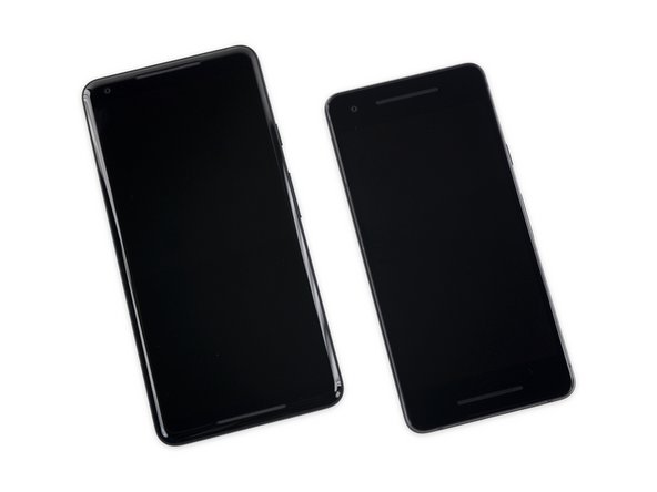

  3. Google Pixel 2 XL Teardown: crwdns2935265:03crwdnd2935265:01crwdnd2935265:03crwdne2935265:0 Google Pixel 2 XL Teardown: crwdns2935265:03crwdnd2935265:02crwdnd2935265:03crwdne2935265:0 Google Pixel 2 XL Teardown: crwdns2935265:03crwdnd2935265:03crwdnd2935265:03crwdne2935265:0

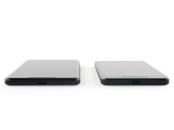

    • Google urges the world to “ask more of your phone," although it's hard to ask for a whole lot more than the styling from an iPhone 7 Plus.
    • However, we can ask for a bit more from the Pixel 2 XL than the standard Pixel 2. The XL gets less bezel and more screen for a sleeker overall design.
    • Compared to the standard 2D screen on the standard Pixel 2, the XL screen gives users a whole ‘nother half dimension!

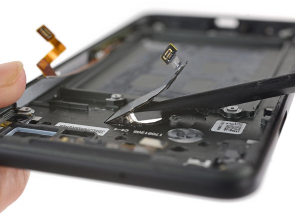

    • Last year, the HTC-built Pixel XL showed us a novel way to remove an adhered battery—a perforated outer label let you pull the battery out of its shell, then easily peel off the rest of the label.
    • This year, it seems LG's industrial design doesn't include any provisions for easily removing the battery. (RIP, ye olde LG.)
    • This battery holds 13.6 Wh (3520 mAh at 3.85 V), slightly more than last year's 13.28 Wh.
    • That's roughly on-par with the 13.48 Wh power pack in Samsung's Galaxy S8+, and considerably more than the 10.28 Wh the iPhone 8 Plus manages to get away with.

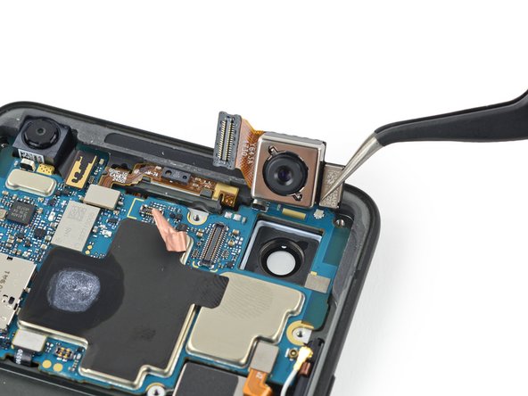

  7. Google Pixel 2 XL Teardown: crwdns2935265:07crwdnd2935265:01crwdnd2935265:02crwdne2935265:0 Google Pixel 2 XL Teardown: crwdns2935265:07crwdnd2935265:02crwdnd2935265:02crwdne2935265:0
    • We peel back some copper tape to unleash the XL's beast of a main camera.
    • Although the megapixel count on this camera is close to last year's, the similarities between the sensors end there.
    • This year Google switched to a dual-pixel sensor, added optical image stabilization, and opened the aperture up to f/1.8 from last year's f/2.0.

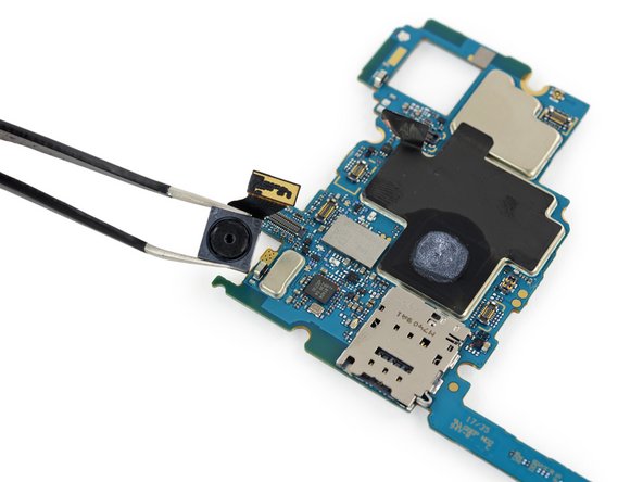

    • The front sensor array gets unplugged, but stays in the phone for now—we have bigger fish to fry.
    • Along with a few other connectors, that's all that's holding this motherboard in— seems like those midframe screws were the only fasteners!
    • The motherboard is out! But we have one minor barnacle to remove.
    • The 8 MP front-facing camera pops free readily, and can rest easy, knowing it's a full megapixel better than the latest iPhone offerings.

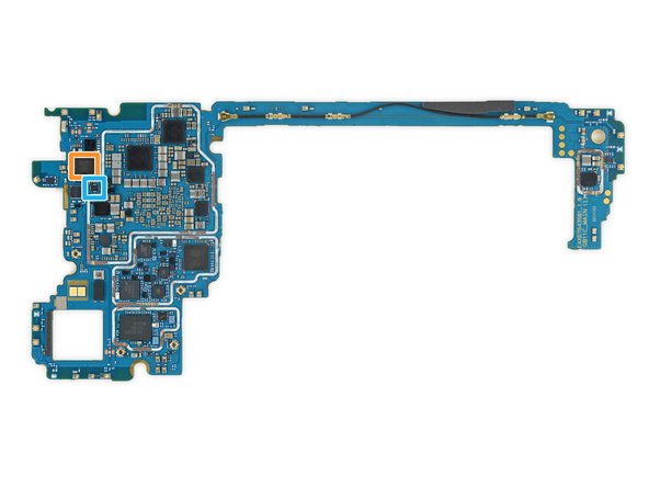

  9. Google Pixel 2 XL Teardown: crwdns2935265:09crwdnd2935265:01crwdnd2935265:03crwdne2935265:0 Google Pixel 2 XL Teardown: crwdns2935265:09crwdnd2935265:02crwdnd2935265:03crwdne2935265:0 Google Pixel 2 XL Teardown: crwdns2935265:09crwdnd2935265:03crwdnd2935265:03crwdne2935265:0
    • From sand to silicon—with all the chips on this board, it's a mini Sahara. Let's name a few of them!
    • Samsung K3UH5H50MM-NGCJ 4 GB LPDDR4 mobile DRAM, layered over a Qualcomm Snapdragon 835
    • Samsung KLUCG4J1ED-B0C1 64 GB Universal Flash Storage
    • Avago AFEM-9046 front end module
    • Qorvo QM78035 (possibly RF Fusion module?) probably RF amplifier
    • Skyworks 7360-2A 1716 HX
    • NXP 81A04 (PN81A) 39 04 sSD730 (likely NFC controller) and Murata SS7715005 (Wifi/Bluetooth module?)
    • Last but certainly not least, we have Google's very first in-house, custom-designed SoC, the Pixel Visual Core, labeled SR3HX X726C502. Currently lying dormant, the Pixel Visual Core will be enabled with Android 8.1.

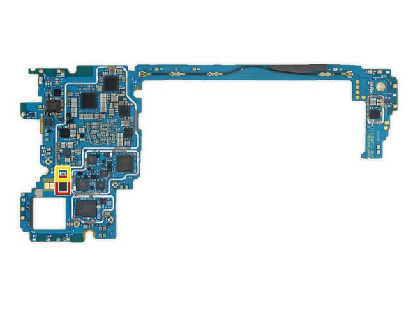

    • IC Identifications, pt. 3 (sensors):
    • STMicroelectronics VL53L0X time-of-flight/ranging/gesture detection
    • STMicroelectronics LSM6DSM 3-axis accelerometer/gyroscope
    • Bosch Sensortec BMP280 pressure sensor
    • AKM Semiconductor AK8789 hall effect sensor

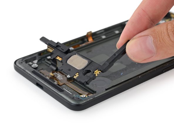

  13. Google Pixel 2 XL Teardown: crwdns2935265:013crwdnd2935265:01crwdnd2935265:03crwdne2935265:0 Google Pixel 2 XL Teardown: crwdns2935265:013crwdnd2935265:02crwdnd2935265:03crwdne2935265:0 Google Pixel 2 XL Teardown: crwdns2935265:013crwdnd2935265:03crwdnd2935265:03crwdne2935265:0
    • With the meat of the Pixel pulled out, we just have a few case peripherals to attend to.
    • The volume/power button switches live on a single cable backed by a plastic frame.
    • The speaker assembly comes out next, giving us our first good look at the... squeezy sensor.
    • Based on the way the technology is implemented, we're expecting something similar to Apple's Force Touch trackpad. Let's get this sensor out of the case and see if we can make any sense out of it.

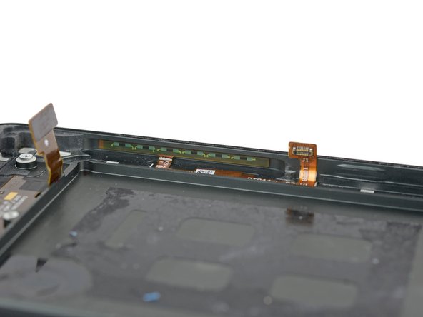

  14. Google Pixel 2 XL Teardown: crwdns2935265:014crwdnd2935265:01crwdnd2935265:03crwdne2935265:0 Google Pixel 2 XL Teardown: crwdns2935265:014crwdnd2935265:02crwdnd2935265:03crwdne2935265:0 Google Pixel 2 XL Teardown: crwdns2935265:014crwdnd2935265:03crwdnd2935265:03crwdne2935265:0
    • Here it is, the secret to the squeeze—half of the pair of sensors responsible for detecting when you squeeze the edge of your Pixel 2 XL.
    • The sensor consists of a flexible printed circuit board wrapped around both sides of a line of steel chunks, with strain gauges bridging the gaps between the metal bits.
    • Strain gauges are deformation-sensitive resistors, that slightly change their resistance when stretched or squished.
    • Having two rows of strain gauges separated by spacers should give this sensor higher resolution than a single strip of gauges would, allowing it to detect even the slightest of deflections.
    • As you squeeze, the outer row of gauges should be shortened, while the inner row is lengthened. This gives the Pixel software a larger absolute deflection to detect and measure to trigger the feature.

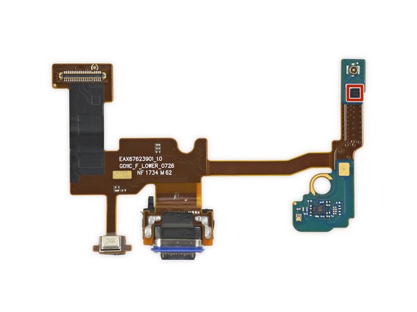

    • Some dainty halberd-spudgering grants us a look at the USB-C port assembly.
    • Points to Google for putting the USB-C port on its own board. This is a high-wear item, and soldering it directly to the motherboard would make for difficult (and costly) repairs.
    • Plus, in the absence of a headphone jack, we can expect double the stress on this port, as you'll be using it for media and charging.
    • This year's fingerprint sensor brings a much cleaner cable job, making this sensor removal a snap. (Get it? 'Cause fingers.)
    • AKM Semiconductor AK09915C 3-axis electronic compass

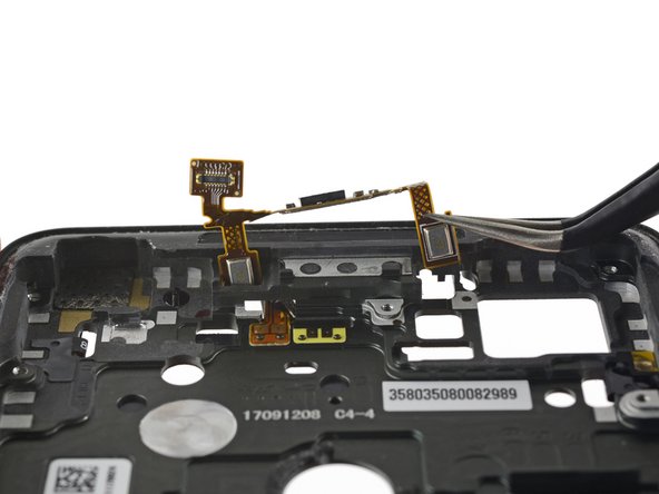

    • While the display glass was held down with some easy-to-slice foam adhesive, the rear glass is a different story.
    • We're happy to see that Google still hasn't given in to the full glass back trend. This little bit of glass seems to bridge the gap between durability and antenna transmissivity.
    • We suspect this thick pad of sticky adhesive is here as a shock absorber to protect the glass from falls. Whatever the reason, we had to bring plenty of heat to extract it.
    • This little antenna-laced cover pops off to reveal the front sensor cable, accessible only from the back after removing the glass.
    • Two Knowles MEMS microphones are found on the flex cable attached to the back of the phone

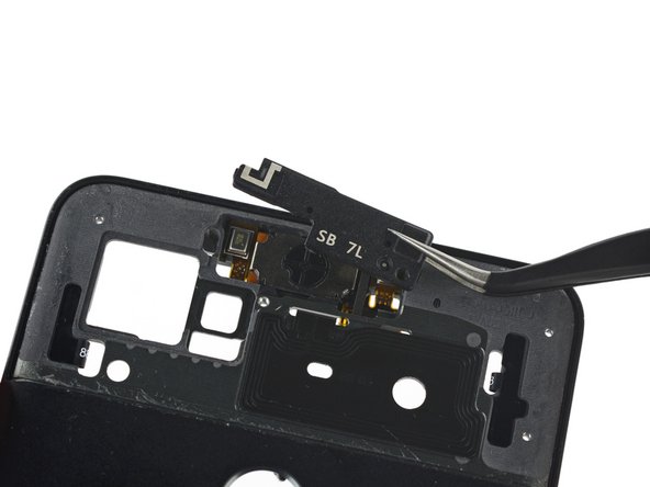

  17. Google Pixel 2 XL Teardown: crwdns2935265:017crwdnd2935265:01crwdnd2935265:02crwdne2935265:0 Google Pixel 2 XL Teardown: crwdns2935265:017crwdnd2935265:02crwdnd2935265:02crwdne2935265:0

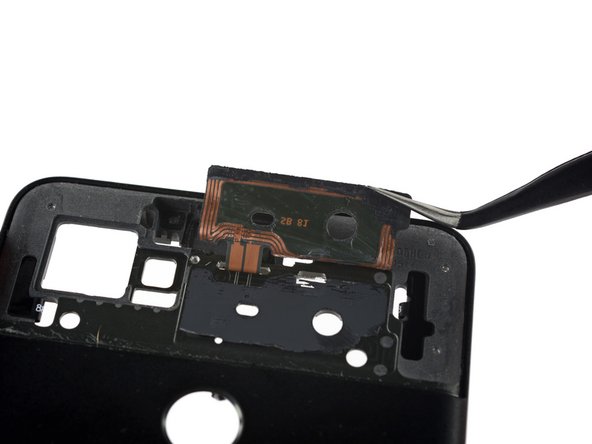

    • Lastly, we free two more components that live trapped beneath the glued-down glass back.
    • The earpiece speaker and NFC antenna both come out, but only after applying some more heat—each is solidly adhered in place.
