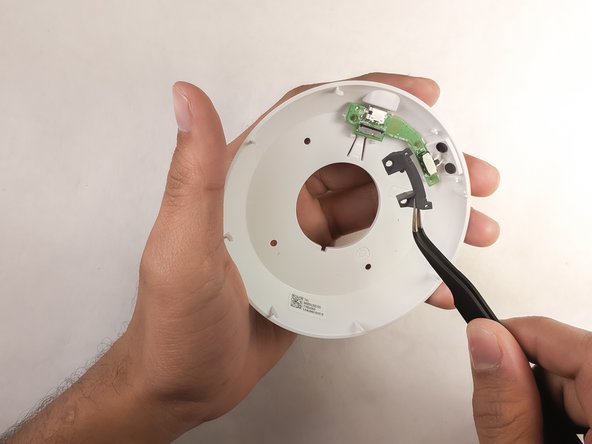

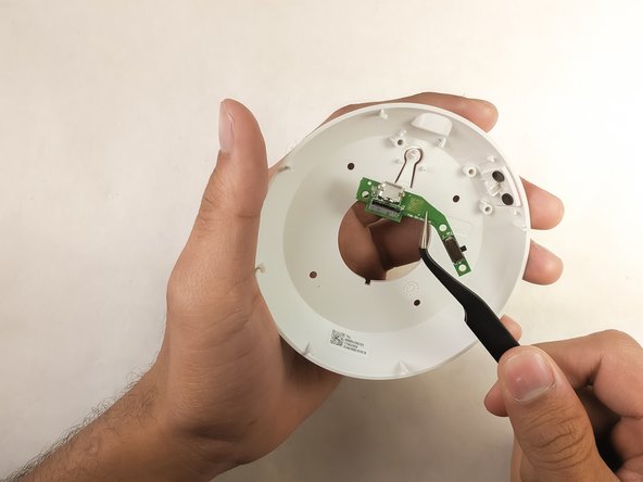

    • Remove the three 5.3mm T6 Torx screws from the board.
  7. Google Home Mini USB Power Port Replacement: crwdns2935265:07crwdnd2935265:01crwdnd2935265:02crwdne2935265:0 Google Home Mini USB Power Port Replacement: crwdns2935265:07crwdnd2935265:02crwdnd2935265:02crwdne2935265:0
    • Remove the black metal plate from the board.
  8. Google Home Mini USB Power Port Replacement: crwdns2935265:08crwdnd2935265:01crwdnd2935265:02crwdne2935265:0 Google Home Mini USB Power Port Replacement: crwdns2935265:08crwdnd2935265:02crwdnd2935265:02crwdne2935265:0
    • Remove the board.
