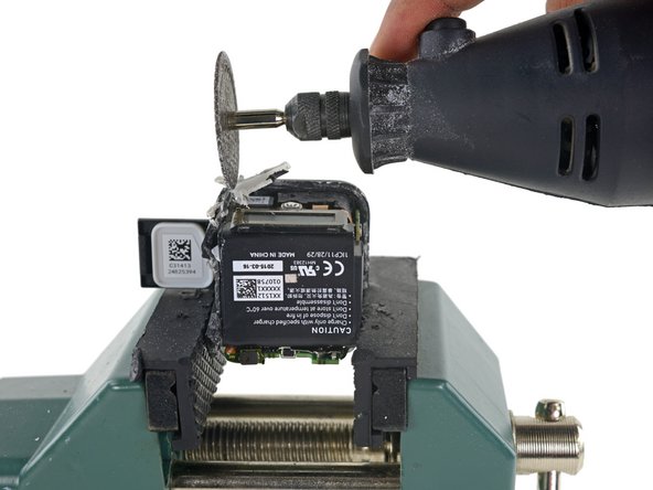

      • Houston, we have liftoff—of one portion of the outer case. The interior components are a tetris'd tangle of parts with no obvious way to extract the battery.
      • Sigh.
      • Impatience gets the best of us and we bust out the rotary tool for the last stretch.
      • We can practically taste the interior components. Then again, maybe that's just the plastic dust.

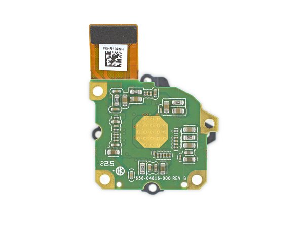

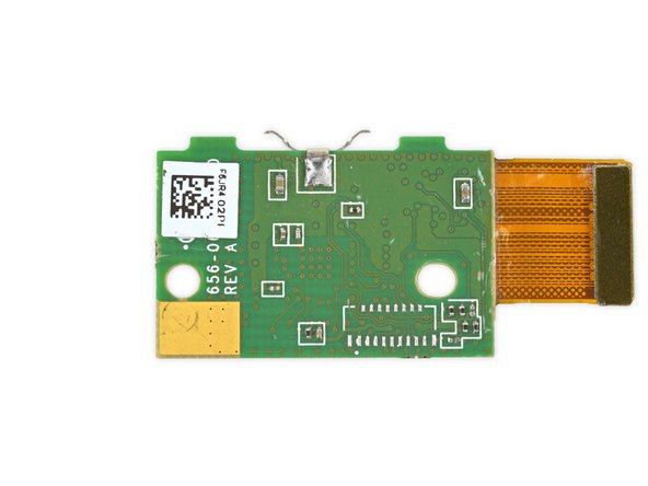

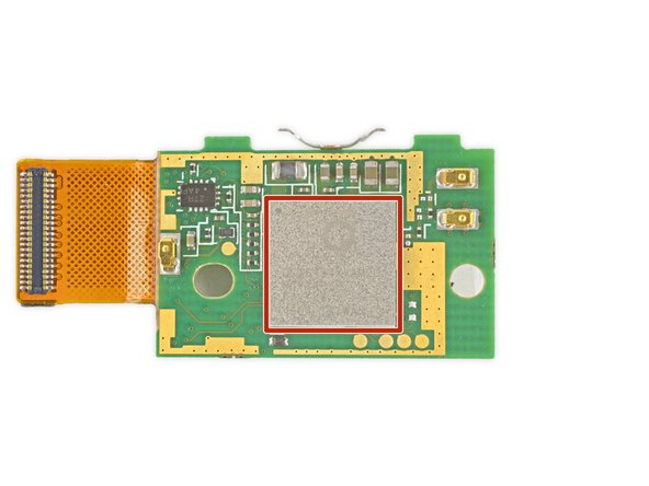

      • Success! Time to actually do some analysis.
      • The first component out is the wireless communications daughterboard, featuring some Qualcomm hardware:
      • Qualcomm QCA6134X-AM2D Wi-Fi/Bluetooth SiP

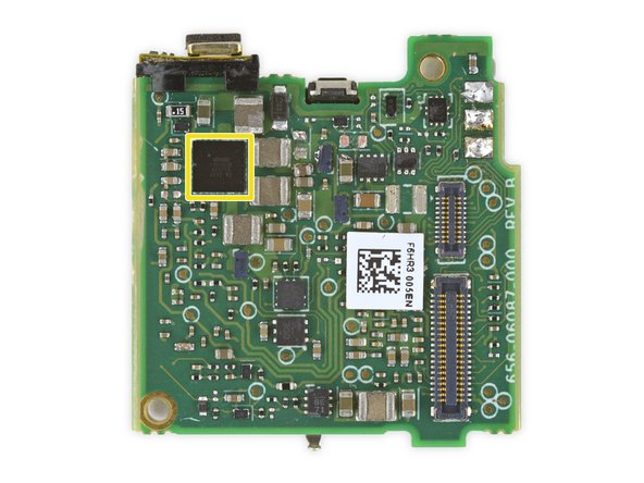

      • We've finally extracted the motherboard. Let's see what it's packing:
      • Ambarella A7LS Video and Image Processing SoC
      • Micron JWB25 NAND Flash + LPDDR2 MCP
      • AMS AG AS3715 Power Management Unit

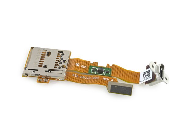

    15. GoPro Hero4 Session Teardown: crwdns2935265:016crwdnd2935265:01crwdnd2935265:02crwdne2935265:0 GoPro Hero4 Session Teardown: crwdns2935265:016crwdnd2935265:02crwdnd2935265:02crwdne2935265:0
      • The last tetris block is the tricky, angled microSD card slot. Also part of this assembly: the micro-USB port.
      • Unlike its bigger, more expensive brothers, the Session lacks an accessory port. This means that you won't be able to mount things, such as an LCD screen or secondary battery, to your GoPro.
      • While it's the last component out of the camera, this teardown's not quite over...

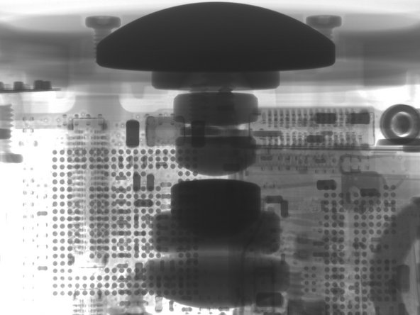

    16. GoPro Hero4 Session Teardown: crwdns2935265:017crwdnd2935265:01crwdnd2935265:03crwdne2935265:0 GoPro Hero4 Session Teardown: crwdns2935265:017crwdnd2935265:02crwdnd2935265:03crwdne2935265:0 GoPro Hero4 Session Teardown: crwdns2935265:017crwdnd2935265:03crwdnd2935265:03crwdne2935265:0

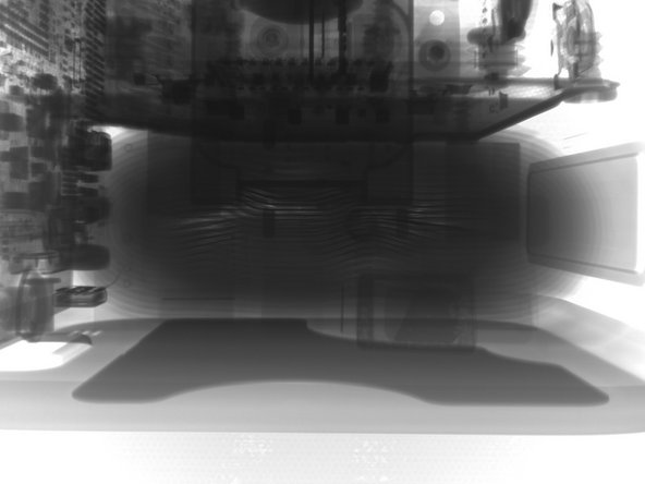

      • That's right—it's X-ray time! With the GoPro magically reassembled and re-compactified, we can get a closer look at how it all fits together.
      • If there's room to pack anything more into this little cube, it's news to us. Look how the little microSD card slot has to angle its way in there.
      • That multi-stage mushroom cloud is actually the lens assembly!
      • The oblong, noodley oval is the battery, composed (like an onion) of layers.
    17. GoPro Hero4 Session Teardown: crwdns2935265:018crwdnd2935265:01crwdnd2935265:03crwdne2935265:0 GoPro Hero4 Session Teardown: crwdns2935265:018crwdnd2935265:02crwdnd2935265:03crwdne2935265:0 GoPro Hero4 Session Teardown: crwdns2935265:018crwdnd2935265:03crwdnd2935265:03crwdne2935265:0
