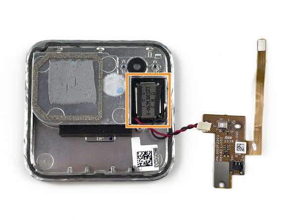

  5. GoPro HERO11 Black Mini Teardown, The audio department: crwdns2935265:05crwdnd2935265:01crwdnd2935265:03crwdne2935265:0 GoPro HERO11 Black Mini Teardown, The audio department: crwdns2935265:05crwdnd2935265:02crwdnd2935265:03crwdne2935265:0 GoPro HERO11 Black Mini Teardown, The audio department: crwdns2935265:05crwdnd2935265:03crwdnd2935265:03crwdne2935265:0
    • Three Phillips #000 screws to remove the flexible circuit board (FPC) from the heatsink.
    • Underneath the FPC sits the speaker for the camera's lovely beeping sounds that let us know what it is up to.
    • Inconspicuously located between two mounting holes, there's also the GoPro's rear-facing MEMS microphone.
    • The HERO11 Black Mini utilizes a total of three microphones facing in different directions to achieve optimal wind-noise reduction.

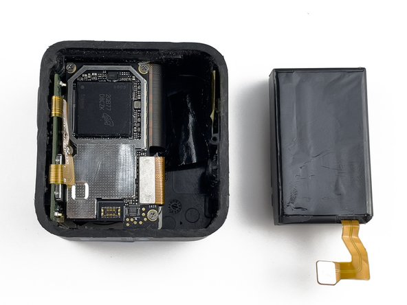

  6. GoPro HERO11 Black Mini Teardown, Blackout: crwdns2935265:06crwdnd2935265:01crwdnd2935265:03crwdne2935265:0 GoPro HERO11 Black Mini Teardown, Blackout: crwdns2935265:06crwdnd2935265:02crwdnd2935265:03crwdne2935265:0 GoPro HERO11 Black Mini Teardown, Blackout: crwdns2935265:06crwdnd2935265:03crwdnd2935265:03crwdne2935265:0
    • Now on to the real adventure, but safety first:
    • With the heatsink removed, the battery can finally be unplugged.
    • After that, it takes just one T4 Torx screw to loosen the battery tray and carefully pull the 1500mAh Li-Ion cell out of the case.
    • An internal battery for a camera that is virtually impossible to open non-destructively? Not nice, GoPro.

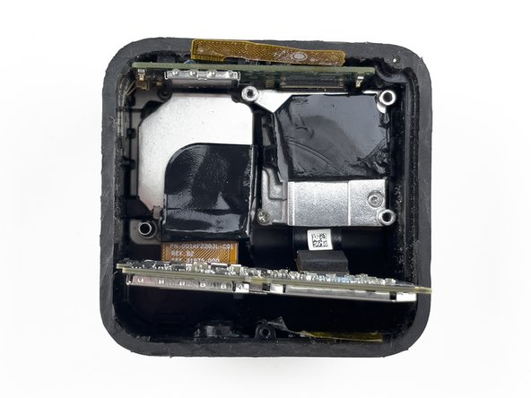

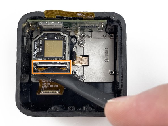

  7. GoPro HERO11 Black Mini Teardown, Bendy board: crwdns2935265:07crwdnd2935265:01crwdnd2935265:03crwdne2935265:0 GoPro HERO11 Black Mini Teardown, Bendy board: crwdns2935265:07crwdnd2935265:02crwdnd2935265:03crwdne2935265:0 GoPro HERO11 Black Mini Teardown, Bendy board: crwdns2935265:07crwdnd2935265:03crwdnd2935265:03crwdne2935265:0
    • We're getting closer! The mainboard is in plain sight and almost free.
    • All it takes is to unplug the connector for the sensor...
    • And remove the four Phillips #000 screws...
    • To find out that it is a rigid-flex PCB and realize that the other part is buried even deeper.
    • Looks like the initial celebration was a bit premature. Whoops.

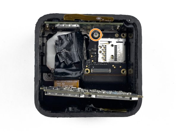

  8. GoPro HERO11 Black Mini Teardown, USB(e) gone!: crwdns2935265:08crwdnd2935265:01crwdnd2935265:02crwdne2935265:0 GoPro HERO11 Black Mini Teardown, USB(e) gone!: crwdns2935265:08crwdnd2935265:02crwdnd2935265:02crwdne2935265:0
    • After peeling back some tape, there's one more Phillips #000 screw and the USB port assembly can be pulled out of the camera body.
    • The view onto the rest of the mainboard is almost unobstructed now and reveals that the microSD slot is actually soldered directly to the second part of the mainboard. A rather unusual choice, as that's often one of the first components to get "outsourced" from a mainboard when space is tight.

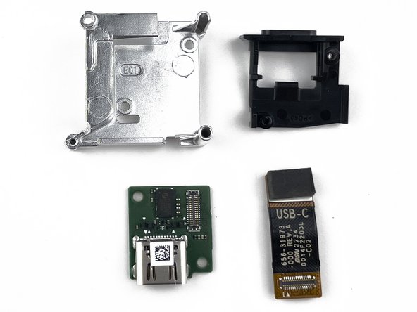

  9. GoPro HERO11 Black Mini Teardown, Finally an IC: crwdns2935265:09crwdnd2935265:01crwdnd2935265:03crwdne2935265:0 GoPro HERO11 Black Mini Teardown, Finally an IC: crwdns2935265:09crwdnd2935265:02crwdnd2935265:03crwdne2935265:0 GoPro HERO11 Black Mini Teardown, Finally an IC: crwdns2935265:09crwdnd2935265:03crwdnd2935265:03crwdne2935265:0
    • Before we dig deeper into this camera, let's take a closer look at the pieces we just removed.
    • Removing two T4 Torx screws is all it takes. The assembly then just effortlessly falls apart and reveals this teardown's first IC:
    • Pericom (Diodes Inc.) PI3DBS12612ZTFE
    • This USB-C module hasn't changed for several product iterations. It's the same one GoPro used for the HERO11 Black and previous generations.

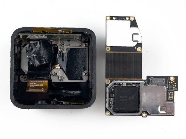

  10. GoPro HERO11 Black Mini Teardown, The beast is free!: crwdns2935265:010crwdnd2935265:01crwdnd2935265:03crwdne2935265:0 GoPro HERO11 Black Mini Teardown, The beast is free!: crwdns2935265:010crwdnd2935265:02crwdnd2935265:03crwdne2935265:0 GoPro HERO11 Black Mini Teardown, The beast is free!: crwdns2935265:010crwdnd2935265:03crwdnd2935265:03crwdne2935265:0
    • This might seem like a déjà vu, but: We're getting closer!
    • Two connectors to unclip and they pop off like they have already accepted their fate.
    • Removing the black FPC uncovers one more Phillips #000 screw and then...
    • It is done! The floppy mainboard has been freed from its shackles and presents itself in its full glory.

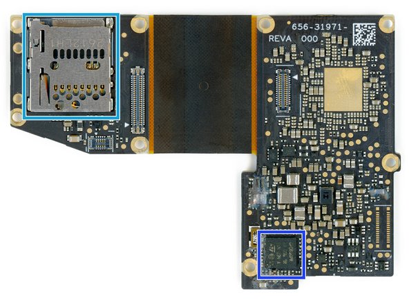

  11. GoPro HERO11 Black Mini Teardown, Silicon goodness: crwdns2935265:011crwdnd2935265:01crwdnd2935265:02crwdne2935265:0 GoPro HERO11 Black Mini Teardown, Silicon goodness: crwdns2935265:011crwdnd2935265:02crwdnd2935265:02crwdne2935265:0
    • All that was left to do was to unclip the EMI shields and remove some thermal paste to finally uncover all the chips that make the magic happen:
    • GoPro GP2, GoPro's custom processor that was first introduced in the HERO10 Black
    • Samsung KLM8G1GETF-B041 8GB eMMC memory
    • "9150VD106" power management IC (potentially from Qorvo)
    • Qorvo ACT88760 power management IC
    • JAE ST11-H microSD connector
    • STM "GP081GPR" microcontroller (appears to be a custom version)

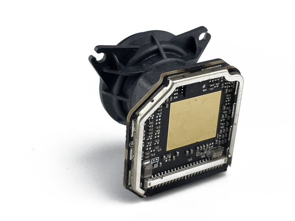

  13. GoPro HERO11 Black Mini Teardown, Wazowski: crwdns2935265:013crwdnd2935265:01crwdnd2935265:03crwdne2935265:0 GoPro HERO11 Black Mini Teardown, Wazowski: crwdns2935265:013crwdnd2935265:02crwdnd2935265:03crwdne2935265:0 GoPro HERO11 Black Mini Teardown, Wazowski: crwdns2935265:013crwdnd2935265:03crwdnd2935265:03crwdne2935265:0
    • As promised by GoPro: The exact same lens and sensor that they also put in the full-sized HERO11 Black.
    • The PCB is rather unspectacular, featuring mostly a handful of passive components and a ground pad for cooling purposes, but at the very top we can spot a significant contributor to GoPro's HyperSmooth stabilization:
    • Bosch BMI260 intertial measurement unit

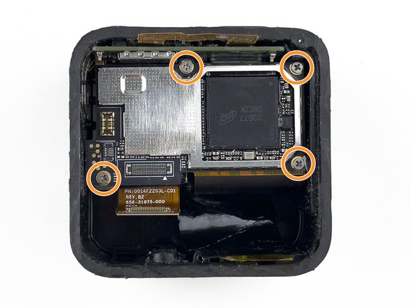

  14. GoPro HERO11 Black Mini Teardown, Angular challenges: crwdns2935265:014crwdnd2935265:01crwdnd2935265:02crwdne2935265:0 GoPro HERO11 Black Mini Teardown, Angular challenges: crwdns2935265:014crwdnd2935265:02crwdnd2935265:02crwdne2935265:0
    • "Are we there yet?" Not quite. First there are two more Phillips #000 screws that need to be removed.
    • Now we get a glimpse of the Mini's secondary PCB, featuring its status display. Buckle up for a deep dive!

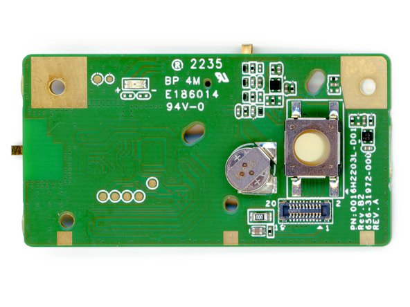

  15. GoPro HERO11 Black Mini Teardown, Greener than grass: crwdns2935265:015crwdnd2935265:01crwdnd2935265:03crwdne2935265:0 GoPro HERO11 Black Mini Teardown, Greener than grass: crwdns2935265:015crwdnd2935265:02crwdnd2935265:03crwdne2935265:0 GoPro HERO11 Black Mini Teardown, Greener than grass: crwdns2935265:015crwdnd2935265:03crwdnd2935265:03crwdne2935265:0
    • On the top side of this green beast, there's not just the GoPro's shutter button. Also part of the team:
    • 0.5" 72x32px OLED display (labeled OEL9E3033A0)
    • Seiko ML414H back-up battery
    • Another EMI shield and a thermal pad later, the bottom side isn't less exciting:
    • Qualcomm QCA9377 WiFi and Bluetooth chipset
    • Top-facing MEMS microphone

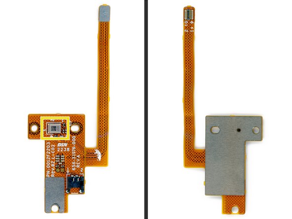

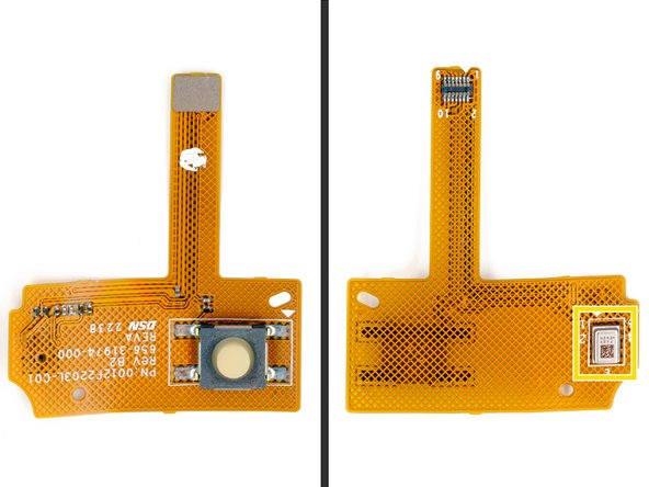

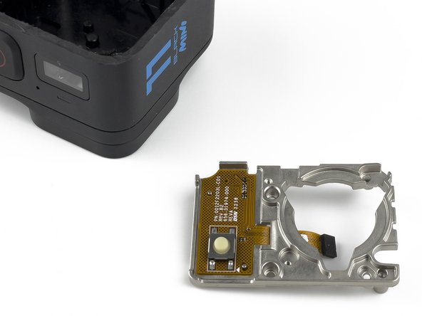

  16. GoPro HERO11 Black Mini Teardown, One more microphone: crwdns2935265:016crwdnd2935265:01crwdnd2935265:03crwdne2935265:0 GoPro HERO11 Black Mini Teardown, One more microphone: crwdns2935265:016crwdnd2935265:02crwdnd2935265:03crwdne2935265:0 GoPro HERO11 Black Mini Teardown, One more microphone: crwdns2935265:016crwdnd2935265:03crwdnd2935265:03crwdne2935265:0
    • Four T4 Torx screws are left, holding the aluminum bracket in place to which all the circuit boards were once mounted.
    • No more glue, no more screws. Lifting the metal frame out of the case leaves behind a lifeless, empty plastic shell and reveals the last electronic components:
    • The power/pairing button and, hidden on the bottom side, the third member of the sound recording triplets:
    • Front-facing MEMS microphone
