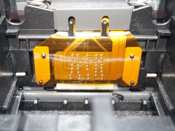

  3. Gentle method - HP Photosmart Plus B210a Printhead Cleaning, Clean the printer contacts: crwdns2935265:03crwdnd2935265:01crwdnd2935265:02crwdne2935265:0 Gentle method - HP Photosmart Plus B210a Printhead Cleaning, Clean the printer contacts: crwdns2935265:03crwdnd2935265:02crwdnd2935265:02crwdne2935265:0
    • Failure to clean this area may result in an Ink System Failure warning. If you are cleaning the printhead, this error will destroy your existing calibration!
    • Using an alcohol wipe, clean the printhead interface on the printer before installing the replacement part to avoid any errors like Ink System Failure.

HI, I am glad to find your explanation. I have followed HP's instructions, which didn't include soaking the print head, but will try that, too. What I am having trouble with now is that the printer screen says that "the print head appears to be missing, not detected, or incorrectly installed". I've redone it 3 times with no change. Also, the HP instructions did not say to unplug it and leave the cover open, so I left it plugged in and put the cover down. Since the printer is not recognizing the head, I have no way of telling if the alignment settings are messed up or not. Do you have suggestions for getting the printhead to be recognized? Thanks a lot.
