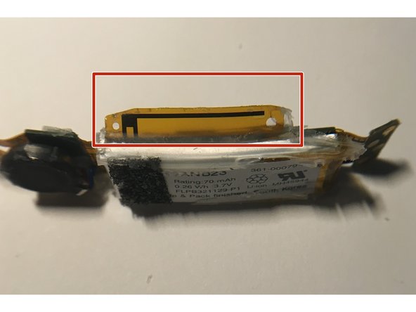

    • Finally (pic 2) the electrical assembly is free! Three rigid boards connected by flex.
    • Check out the antenna built into the flex circuitry - looks like a PIFA.
    • You can keep prying and release the
    • 70mAh Li-ion battery
    • and buzzer.

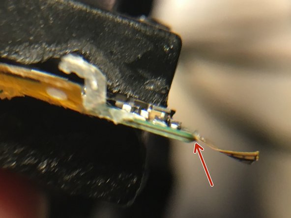

    • Looking side-on, you can see that the flex circuitry is sandwiched between two sets of rigid PCB.

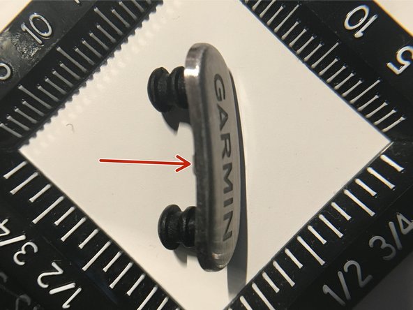

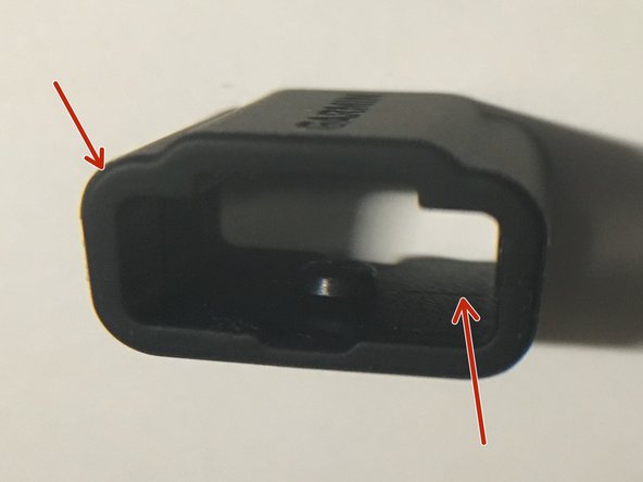

    • While we're at it, let's take a quick look at some of the mechanical parts.
    • First, the rigid (probably ABS) injection molded base plate for the electronics.
    • The plastic strap lock has a brushed aluminum plate crimped to it with the Garmin logo embossed. Nice touch!
    • A close look at the strap holder reveals part lines on the inside and outside - probably a multi pull mold. (really hard to see here - sorry).
