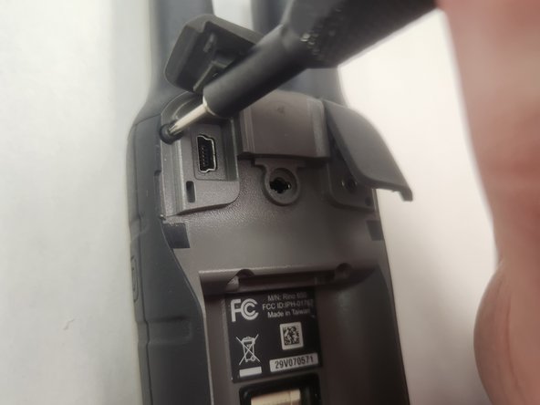

    2. Garmin Rino 650 Screen Replacement, Remove the Battery: crwdns2935265:02crwdnd2935265:01crwdnd2935265:03crwdne2935265:0 Garmin Rino 650 Screen Replacement, Remove the Battery: crwdns2935265:02crwdnd2935265:02crwdnd2935265:03crwdne2935265:0 Garmin Rino 650 Screen Replacement, Remove the Battery: crwdns2935265:02crwdnd2935265:03crwdnd2935265:03crwdne2935265:0
      • On the back of the device will be a metal pin with a D-shaped handle.
      • Using a fingernail, lift this handle until it is vertical.
      • Turn the handle 90 degrees counter-clockwise and lift to remove the battery.

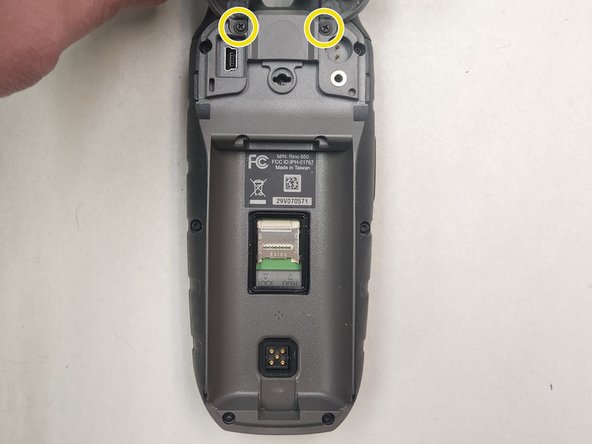

    3. Garmin Rino 650 Screen Replacement, Remove the 6 Black Screws: crwdns2935265:03crwdnd2935265:01crwdnd2935265:03crwdne2935265:0 Garmin Rino 650 Screen Replacement, Remove the 6 Black Screws: crwdns2935265:03crwdnd2935265:02crwdnd2935265:03crwdne2935265:0 Garmin Rino 650 Screen Replacement, Remove the 6 Black Screws: crwdns2935265:03crwdnd2935265:03crwdnd2935265:03crwdne2935265:0
      • There are 6 T6 Screws surrounding the edges of the frame. 2 are on the outside, 2 are under the battery, and the final 2 are under the water resistant silicon flaps at the top of the device.
      • Note the 2 Phillips screws here. They are a PH1 and secure the silicon flaps to the case. They can be removed to make things easier, but it is optional.
      • Using your T6 screwdriver bit, remove the 6 T6 screws and set them aside. They are identical and do not need to be kept sorted.

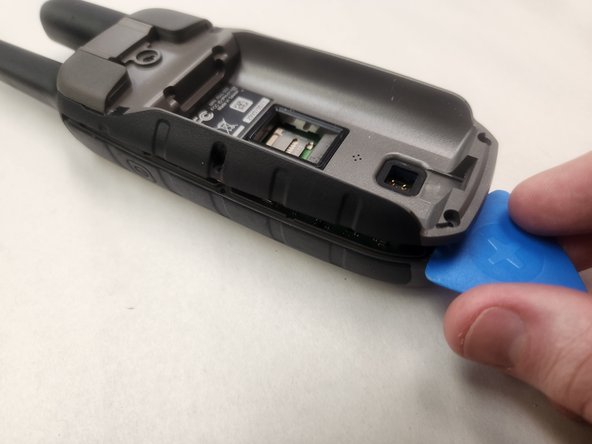

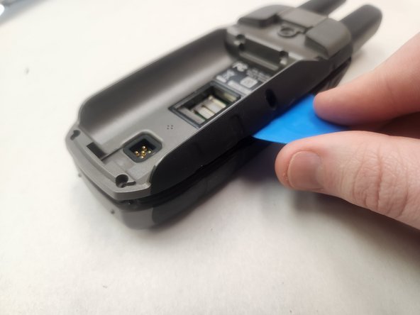

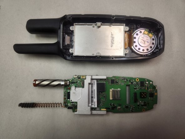

    4. Garmin Rino 650 Screen Replacement, Separate the Frame: crwdns2935265:04crwdnd2935265:01crwdnd2935265:03crwdne2935265:0 Garmin Rino 650 Screen Replacement, Separate the Frame: crwdns2935265:04crwdnd2935265:02crwdnd2935265:03crwdne2935265:0 Garmin Rino 650 Screen Replacement, Separate the Frame: crwdns2935265:04crwdnd2935265:03crwdnd2935265:03crwdne2935265:0
      • Insert your opening pick on the left side near the top. Wiggle it slightly to separate the frame and continue down towards the bottom.
      • Be careful not to insert the opening pick too deep, as you may damage the rubber gasket that provides water resistance.
      • Continuing down, round the corner around the bottom, continuing to ensure you separate the frame before continuing.
      • Rounding the second bottom corner, follow the frame all the way up to the top again, separating the frame along the way.
      • In addition to the rubber gasket, there are two connections between the front and the back of the frame. It is important that you do not insert your opening pick too far nor that you try to fully separate the frame yet.

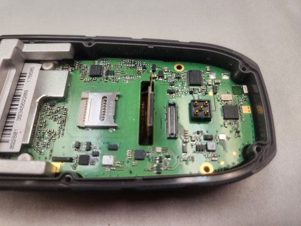

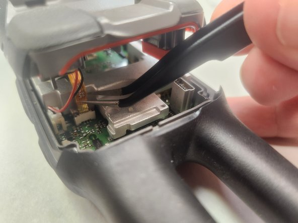

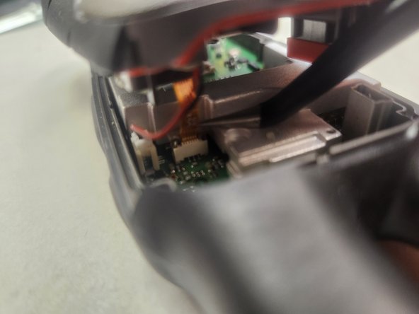

    5. Garmin Rino 650 Screen Replacement, Disconnect the Ribbon Cable: crwdns2935265:05crwdnd2935265:01crwdnd2935265:03crwdne2935265:0 Garmin Rino 650 Screen Replacement, Disconnect the Ribbon Cable: crwdns2935265:05crwdnd2935265:02crwdnd2935265:03crwdne2935265:0 Garmin Rino 650 Screen Replacement, Disconnect the Ribbon Cable: crwdns2935265:05crwdnd2935265:03crwdnd2935265:03crwdne2935265:0
      • Using your tweezers, lift the brown locking tab securing the ribbon cable in place.
      • Gently grasp the ribbon cable and lift it straight up and out.

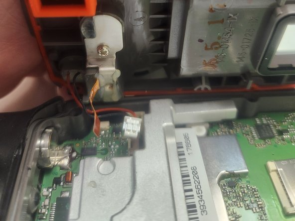

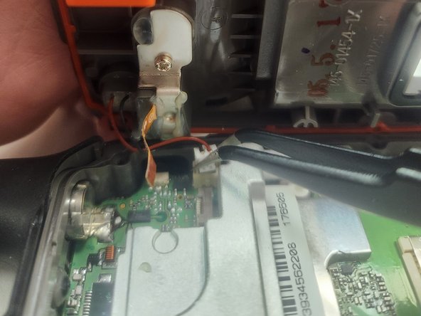

    6. Garmin Rino 650 Screen Replacement, Disconnect the Wires: crwdns2935265:06crwdnd2935265:01crwdnd2935265:03crwdne2935265:0 Garmin Rino 650 Screen Replacement, Disconnect the Wires: crwdns2935265:06crwdnd2935265:02crwdnd2935265:03crwdne2935265:0 Garmin Rino 650 Screen Replacement, Disconnect the Wires: crwdns2935265:06crwdnd2935265:03crwdnd2935265:03crwdne2935265:0
      • Using your tweezers, lift up on the plastic connector securing the wires to the motherboard. Once this is separated, it will be possible to safely remove the back of the frame.
      • Only lift up on the plastic connector. Pulling on the wires may damage them.
      • It may make it easier in the tight space to flip your tweezers around for a different grip.

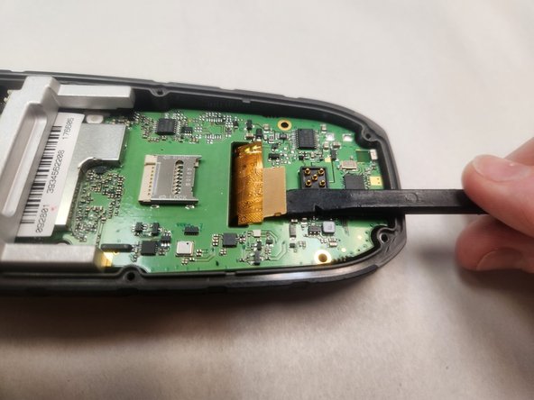

    8. Garmin Rino 650 Screen Replacement, Disconnect the Screen: crwdns2935265:08crwdnd2935265:01crwdnd2935265:03crwdne2935265:0 Garmin Rino 650 Screen Replacement, Disconnect the Screen: crwdns2935265:08crwdnd2935265:02crwdnd2935265:03crwdne2935265:0 Garmin Rino 650 Screen Replacement, Disconnect the Screen: crwdns2935265:08crwdnd2935265:03crwdnd2935265:03crwdne2935265:0
      • Using the flat edge of your spudger, gently pry up on the press connector. Lift until the connector separates completely and gently bend it backwards until it is out of the way.

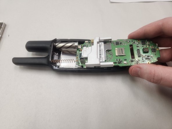

    9. Garmin Rino 650 Screen Replacement, Remove the Motherboard: crwdns2935265:09crwdnd2935265:01crwdnd2935265:03crwdne2935265:0 Garmin Rino 650 Screen Replacement, Remove the Motherboard: crwdns2935265:09crwdnd2935265:02crwdnd2935265:03crwdne2935265:0 Garmin Rino 650 Screen Replacement, Remove the Motherboard: crwdns2935265:09crwdnd2935265:03crwdnd2935265:03crwdne2935265:0
      • Gently lift the motherboard at the bottom, and begin to slowly and firmly pull it down towards the bottom of the device.
      • Do not attempt to lift the motherboard any higher than necessary to just barely clear the frame. Lifting it higher can cause the delicate antennas to break.
      • If necessary, you can use the flat edge of your spudger to lift the motherboard just enough to get a grip on it.
      • Continue pulling with steady, even strength to remove the antennas from their sheaths. The antennas may be stubborn and not want to move easily. Simply continue applying steady and slow pressure.
      • Do not attempt to pull too hard, too fast, or you could break the delicate antennas.
      • Once the antennas give, pull straight out until the motherboard is completely removed from the device.

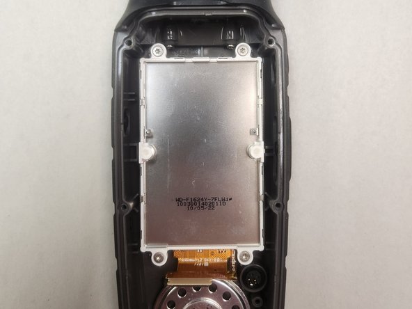

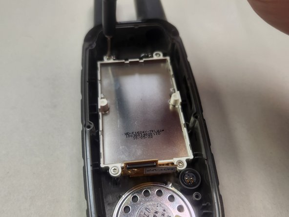

    10. Garmin Rino 650 Screen Replacement, Remove the 4 Silver Screws: crwdns2935265:010crwdnd2935265:01crwdnd2935265:03crwdne2935265:0 Garmin Rino 650 Screen Replacement, Remove the 4 Silver Screws: crwdns2935265:010crwdnd2935265:02crwdnd2935265:03crwdne2935265:0 Garmin Rino 650 Screen Replacement, Remove the 4 Silver Screws: crwdns2935265:010crwdnd2935265:03crwdnd2935265:03crwdne2935265:0
      • There are 4 Silver T6 Screws securing the screen to the frame.
      • Remove these 4 screws and set them aside. They are identical and interchangeable, so no need to keep them sorted.
      • During reassembly, make sure to tighten these evenly around the screen instead of one at a time to avoid the gasket slipping loose under the pressure, as seen in the next step.

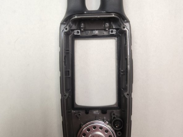

    11. Garmin Rino 650 Screen Replacement, Gasket Warning: crwdns2935265:011crwdnd2935265:01crwdnd2935265:03crwdne2935265:0 Garmin Rino 650 Screen Replacement, Gasket Warning: crwdns2935265:011crwdnd2935265:02crwdnd2935265:03crwdne2935265:0 Garmin Rino 650 Screen Replacement, Gasket Warning: crwdns2935265:011crwdnd2935265:03crwdnd2935265:03crwdne2935265:0
      • There is a black gasket between the screen and the frame. Be careful while removing the screen, as this gasket can easily be damaged.
      • If it falls out, there are two tabs on the bottom that fit snugly over a couple of notches in the frame. The gasket can only go on one way, so do not try to force it.
      • During reassembly, pay close attention to apply consistent even pressure to the screen. If not, this gasket can slip loose and be improperly stuck between the screen and the frame, as shown here.

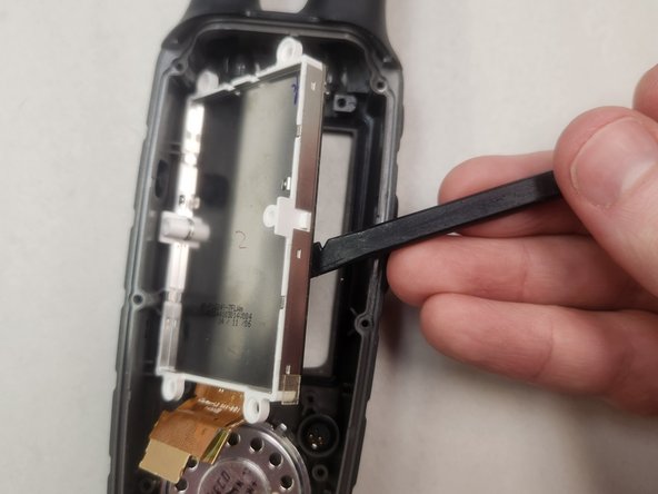

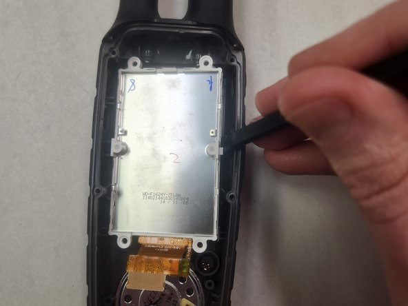

    12. Garmin Rino 650 Screen Replacement, Remove the Screen: crwdns2935265:012crwdnd2935265:01crwdnd2935265:03crwdne2935265:0 Garmin Rino 650 Screen Replacement, Remove the Screen: crwdns2935265:012crwdnd2935265:02crwdnd2935265:03crwdne2935265:0 Garmin Rino 650 Screen Replacement, Remove the Screen: crwdns2935265:012crwdnd2935265:03crwdnd2935265:03crwdne2935265:0
      • There are two plastic tabs that lock under the frame. Once the screws are removed, these tabs are the only thing holding the screen in place.
      • Using the flat edge of your spudger, apply pressure against the right side of the screen assembly and push it to the left to release the plastic locking tab on the right.
      • Once the plastic locking tab is away from the frame, gently lift up on the screen and it should come away easily.

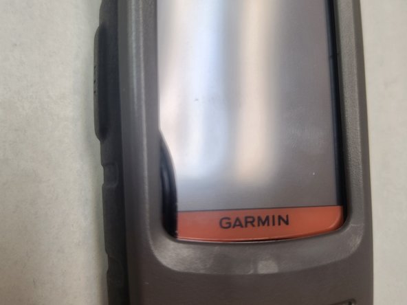

Hello..I ordered this screen and followed your procedure all went well👍👍…but turning on the gps the menu icon screen is not fully in the viewing are icon page is off the top and to the left and not fully visible…is this a fault of the screen or something I did or needs to be calibrated..any help would be appreciated
Stan Hawkins - crwdns2934203:0crwdne2934203:0 crwdns2950251:0crwdne2950251:0
Hi there Stan. Glad my guide could help.
I am not an expert on these specific devices or associated with Garmin in any way. I simply do a lot of repairs in my shop and when there's no good guide for a device and I have to figure things out on my own, I make the guide to help the next person.
During my repair, no calibration was necessary. I can't offer you an explanation on how to fix that, I am very sorry.
Unfortunately it appears the specific listing I have ordered doesn't link properly. It is this one: https://www.ebay.com/itm/313992288429.
However, there were two different versions of the screen (version A and B). Compare your original screen with the new one you received, and compare it between A and B on that link. Did you get the right one? If i were to hazard a guess I'd suspect the different version has some role and you perhaps got the wrong one leading to this issue.
If you can confirm that I'll add a note to the guide detailing such for future repairs.
Justin Castle - crwdns2934203:0crwdne2934203:0 crwdns2950251:0crwdne2950251:0
Thank you..I will check ,and if the versions are different I will report back..also left a message for the supplier recommended on your site as that is how I found them,and will advise you of any solutions ..thanks again.
Ok..yes the issue was I ordered the incorrect version.the site I was looking on did not
Mention 2 versions ..I would add to your guide that there are 2 versions part # located on the amber ribbon connector seen in step 9 pictures at bottom..thanks again for your help
Thank you for the update Stan.
I have added an extra note (step 1) to the guide to try and ensure people do not accidentally run into the same issue you did. I have also changed the part link and it seems to be working properly now.
Glad you were able to get your device working properly again. I hope you have a great day.
